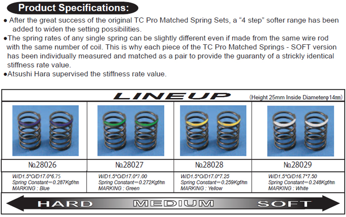

S1 (soft) range
http://www.tqrcracing.com/shop/product/tcprospring.jpg
Std range
http://www.tqrcracing.com/shop/product/TC_PRO2.jpg
Thanks to TQRacing for the images :)
So in theory Xgear pink and Ride Yellow are essentially same rate. But would appear to me to arrive there in a different way - the Xgear uses less coils so the wire gauge/stiffness must be different. This would lead to different feel on track I expect.
What needs to be remembered is spring ranges like the second image above and the likes of HPI Pro4 (where silvers come from - 300g/mm in theory, bit less in practice apparently)came out when cars were 1500g+ and ran NiCd/Nimh cells.
The S1 rides and Xgear are "post" lipo spec, way softer to deal with a car that is 10-15% lighter. Funnily enough the spring rates are around 10-15% less.
