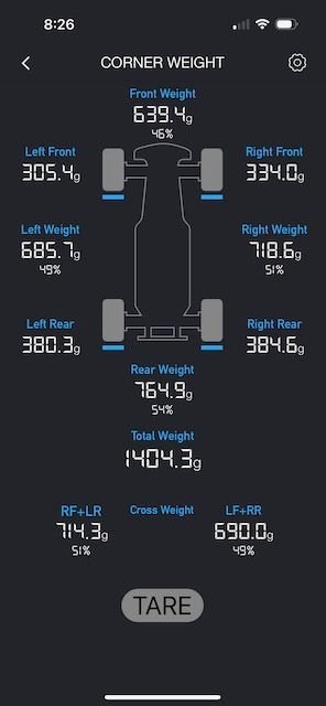

Today I got the ride height to a decent starting spot of ~5.5mm rear and 5 mm front. I put the middle spacer on the front CVAs for now as with nothing the front was ~4.25mm.
I also need to pull the front steering links and shorten the ends to get them tighter as right now I want to get them to either neutral or slight toe out, right now I have slight toe in by 3mm so probably a couple degrees........
I did however grab a weight and balance snapshot.......with body on.
