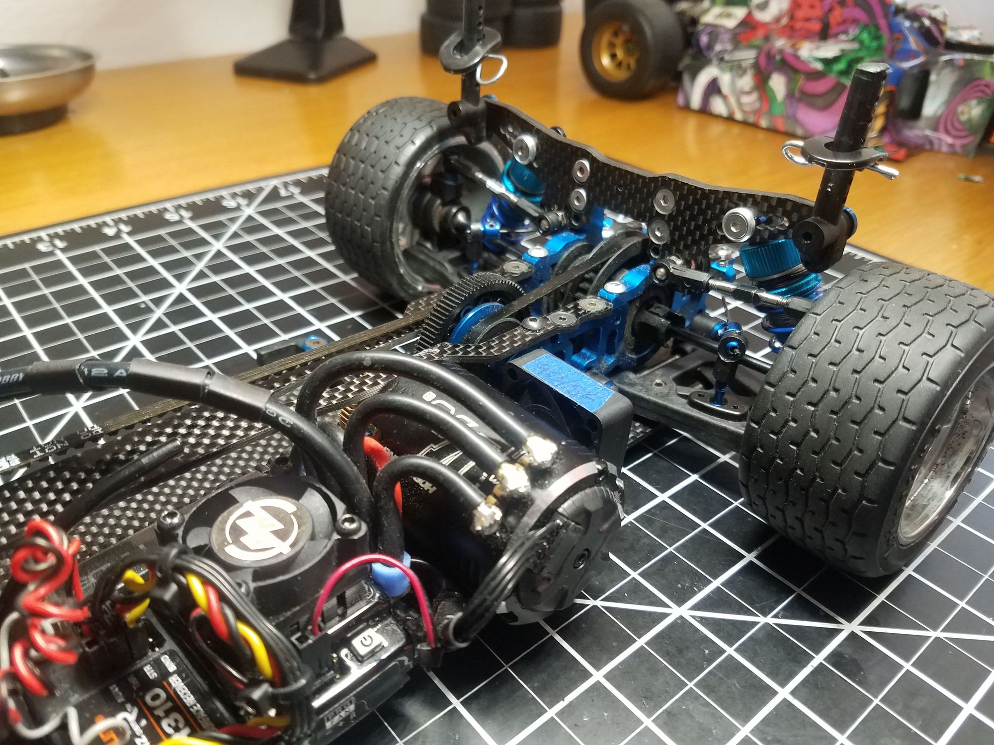

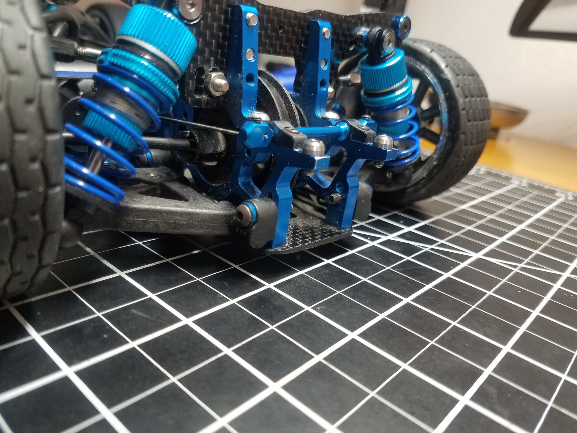

ImacFanatic 04-08-2018 01:06 PM
https://cimg7.ibsrv.net/gimg/www.rct...c5274e9381.jpg
Originally Posted by ImacFanatic (Post 15204713)
After a complete refresh of the 6.1 all it took was, new shock set, 4 new arms, c blocks, steering arms, rear hubs , matching ball joints and cups all around,plastic sway bar mounts, wheel base shims ( some were missing or wrong), bearings, new diff in back...
Ride height is 5mm , droop is adjustable and after a quick test on just the street all I can say is WOW this thing is a whole new machine and a possible contender now. Thanks guys soooo much for all your help and answers, really really appreciated. This site is full of fantastic people.
Now to order a hardware kit to get rid of the rest of the mismatched screws Lol, it never ends :)
https://cimg0.ibsrv.net/gimg/www.rct...bf6ca98b6e.jpg
https://cimg2.ibsrv.net/gimg/www.rct...dd43fe15f1.jpg
https://cimg9.ibsrv.net/gimg/www.rct...b1bc4dfce0.jpg
https://cimg2.ibsrv.net/gimg/www.rct...0a5bafd6da.jpg
https://cimg9.ibsrv.net/gimg/www.rct...89bac57f1e.jpg

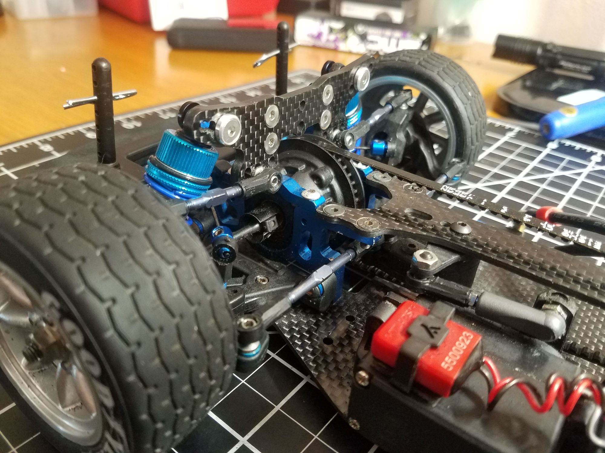

ImacFanatic 04-10-2018 04:00 PM
https://cimg5.ibsrv.net/gimg/www.rct...f0802f1447.jpg
In a pinch for a steering post and bell crank insert for my TC 6.1, anyone have one to sell or know of a swap part/ upgrade for this ?
Hard to find piece , Ive never replaced that on my 2- Tc6 cars , looked on Amain , Stormer, Associated website all dicontinued try Ebay ect, part # Asc31307

ImacFanatic 04-10-2018 07:31 PM
found One in Austraila LoL. And they wont ship here . Have to deal with what I have or modify to something close.
gigaplex 04-10-2018 07:45 PM
I'm in Australia. If you're desperate and willing to pay shipping (might not be cheap, our postal service is expensive), I can order it and then send it your way. PM me if you need to go down that path.

ImacFanatic 04-11-2018 08:17 AM
Look at this on eBay http://www.ebay.com.au/itm/222345642951
this is the link and I'd pay shipping up to 20.00 for this little thing. If they actually have one available I'm down for it. I'll pm details if it's a go . And thanks !
