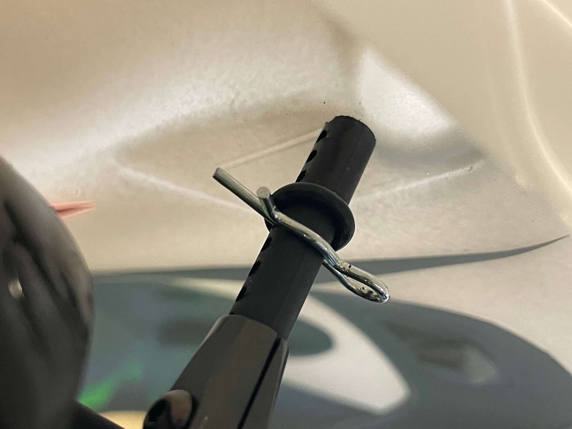

Lastly, if you have an Awesomatix MMXA, then you will HAVE to run the HRB. It's slammed and I moved the body probably 2-3mm forward. By doing so, the rear body posts hit right where the spoiler mounts are.
https://cimg6.ibsrv.net/gimg/www.rct...fa1e4559a.jpeg
https://cimg3.ibsrv.net/gimg/www.rct...8cda1294a.jpeg
ZooRacing knew this and there are lines on the bumper to help line up your holes. (See pic below).
I also believe that even at a neutral mounting position you will still need the HRB.
I did the best I could and I measured the middle of the body hole to top of the spoiler mount at 27.3ish. I probably would raise it to 28 or 28.3 next time as I had to trim the sides and front lip to keep from dragging.

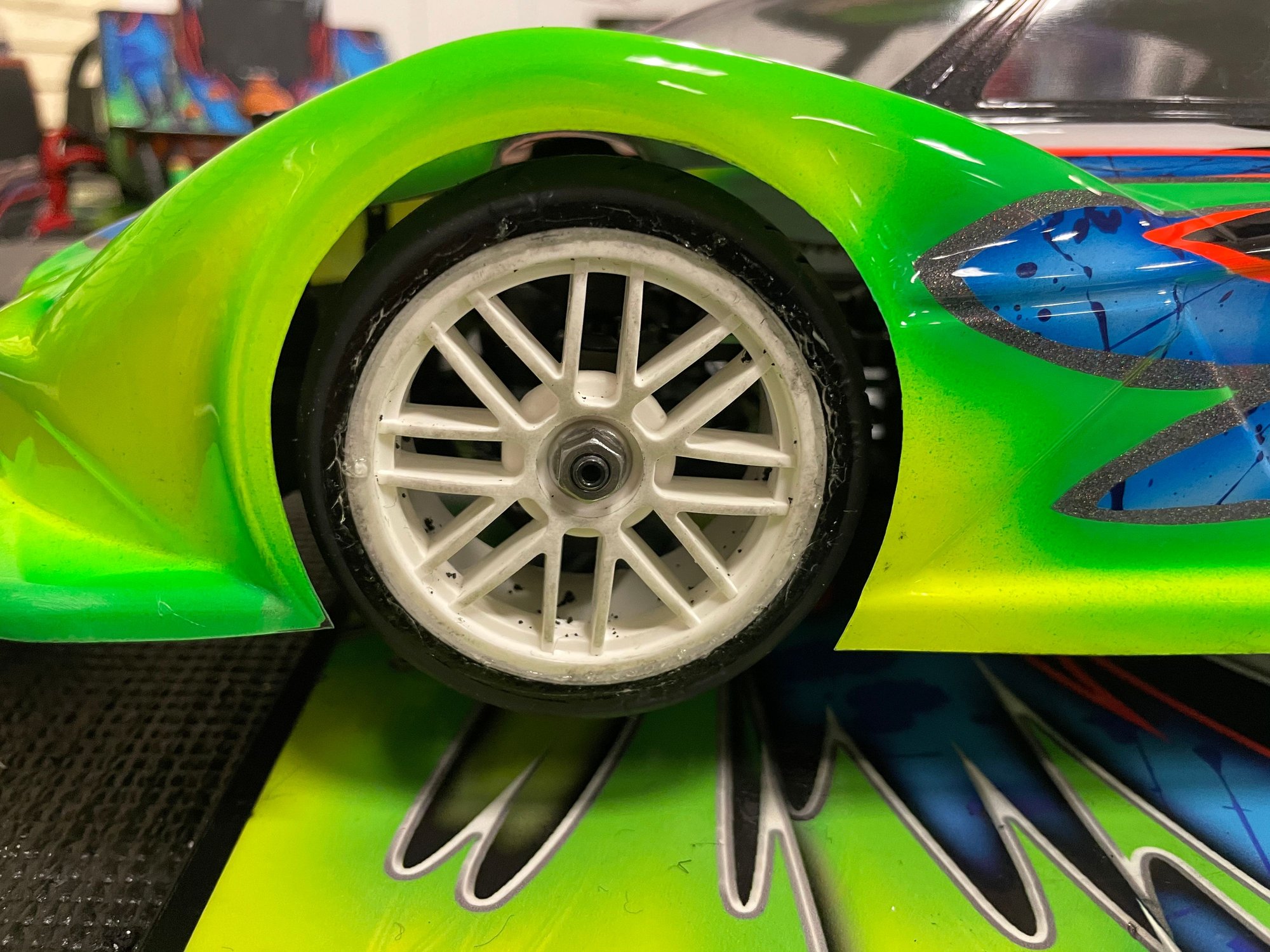

Here are wheel cut out pics to show what it looks like up close to the mold lines
https://cimg6.ibsrv.net/gimg/www.rct...fa760cd2b.jpeg
https://cimg7.ibsrv.net/gimg/www.rct...1d3d41b46.jpeg
Hope this helps! The BWOAH is legit!
