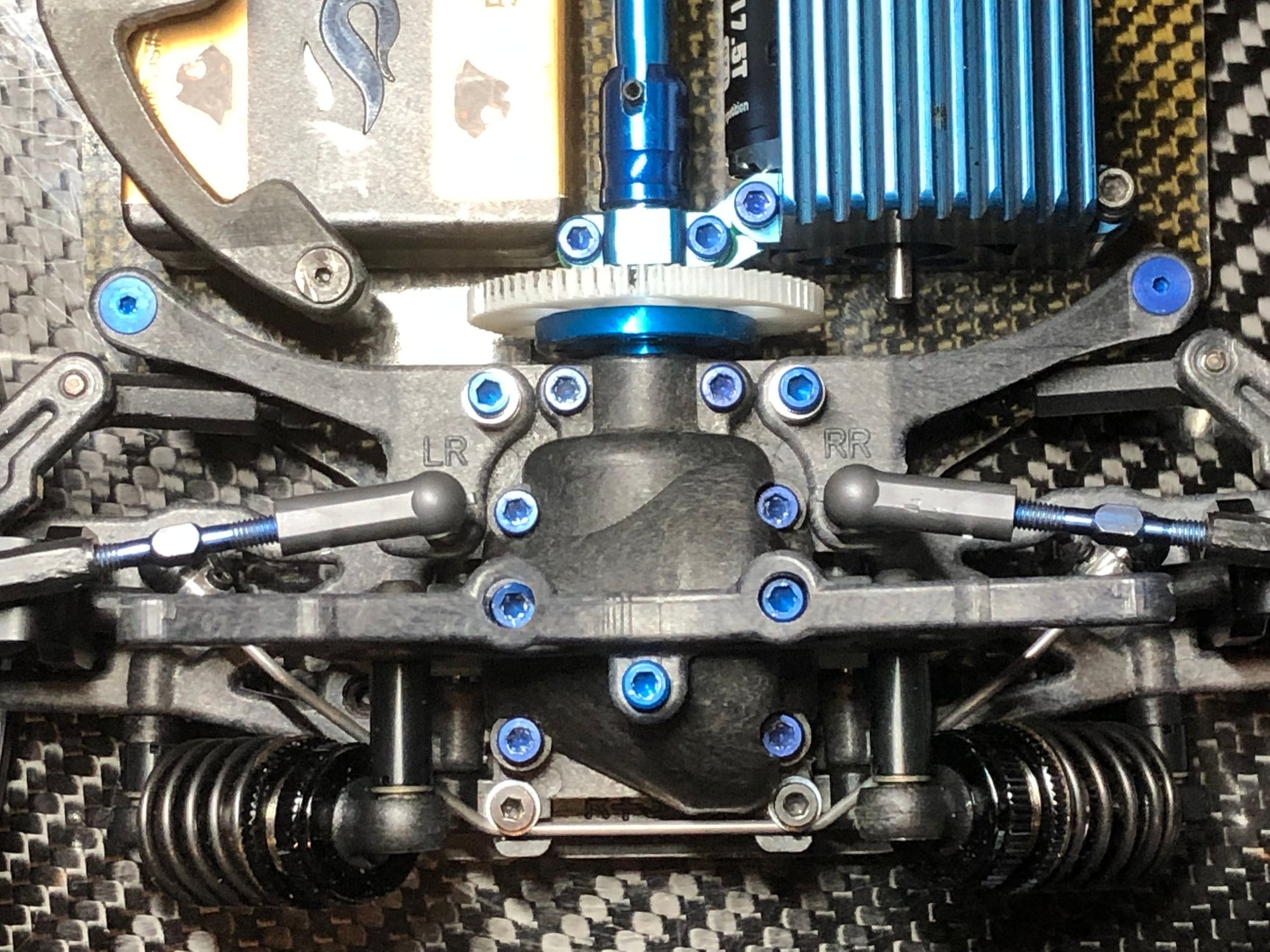

Here are some photos of my modified TC3 IRS chassis. Enjoy!

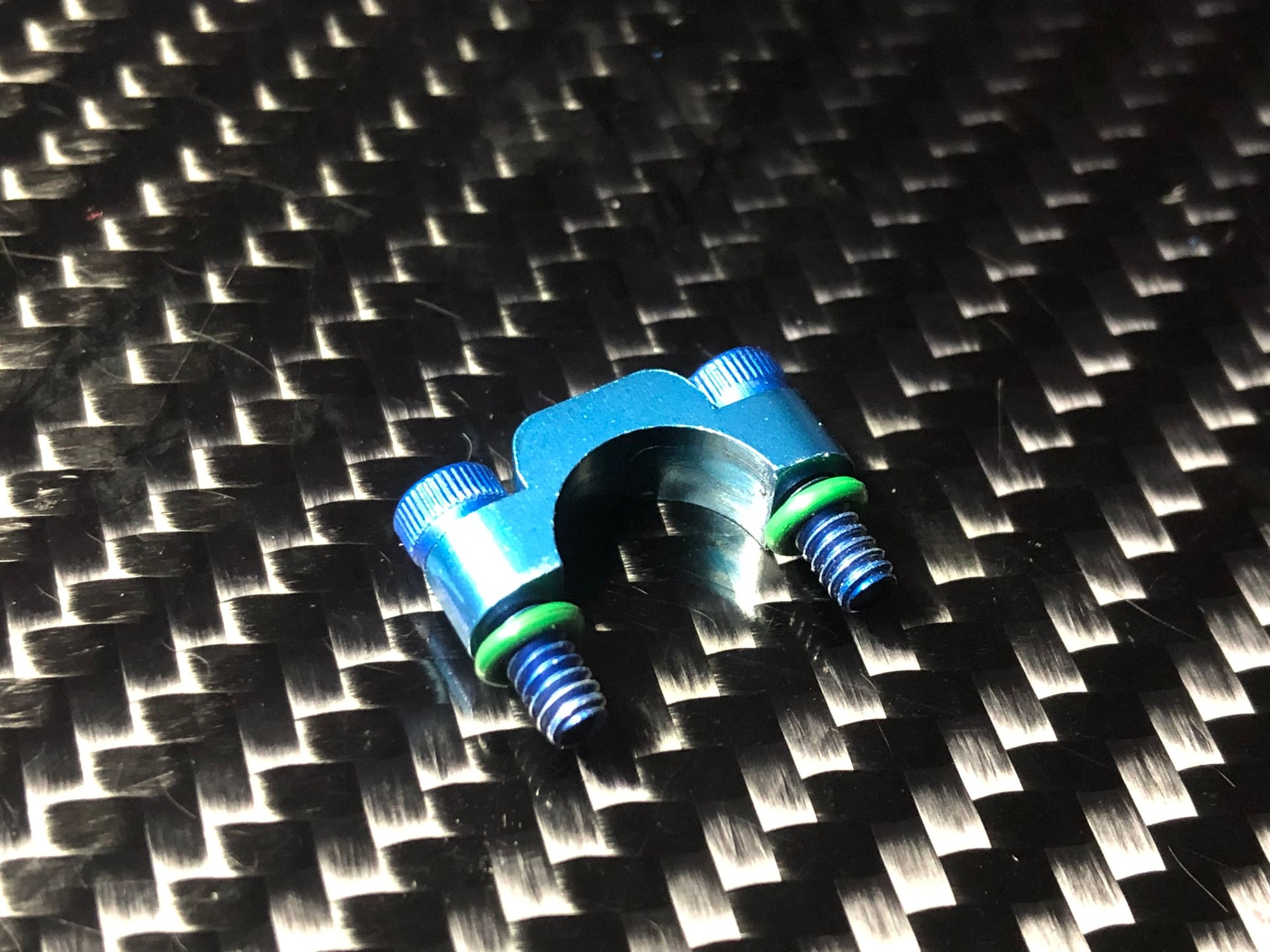

ARC flat screws to allow for some clearance.
Small orings to reduce chatter and retain the screws.
Reduce vibration chatter
Installed on TC3 spindle blocks.

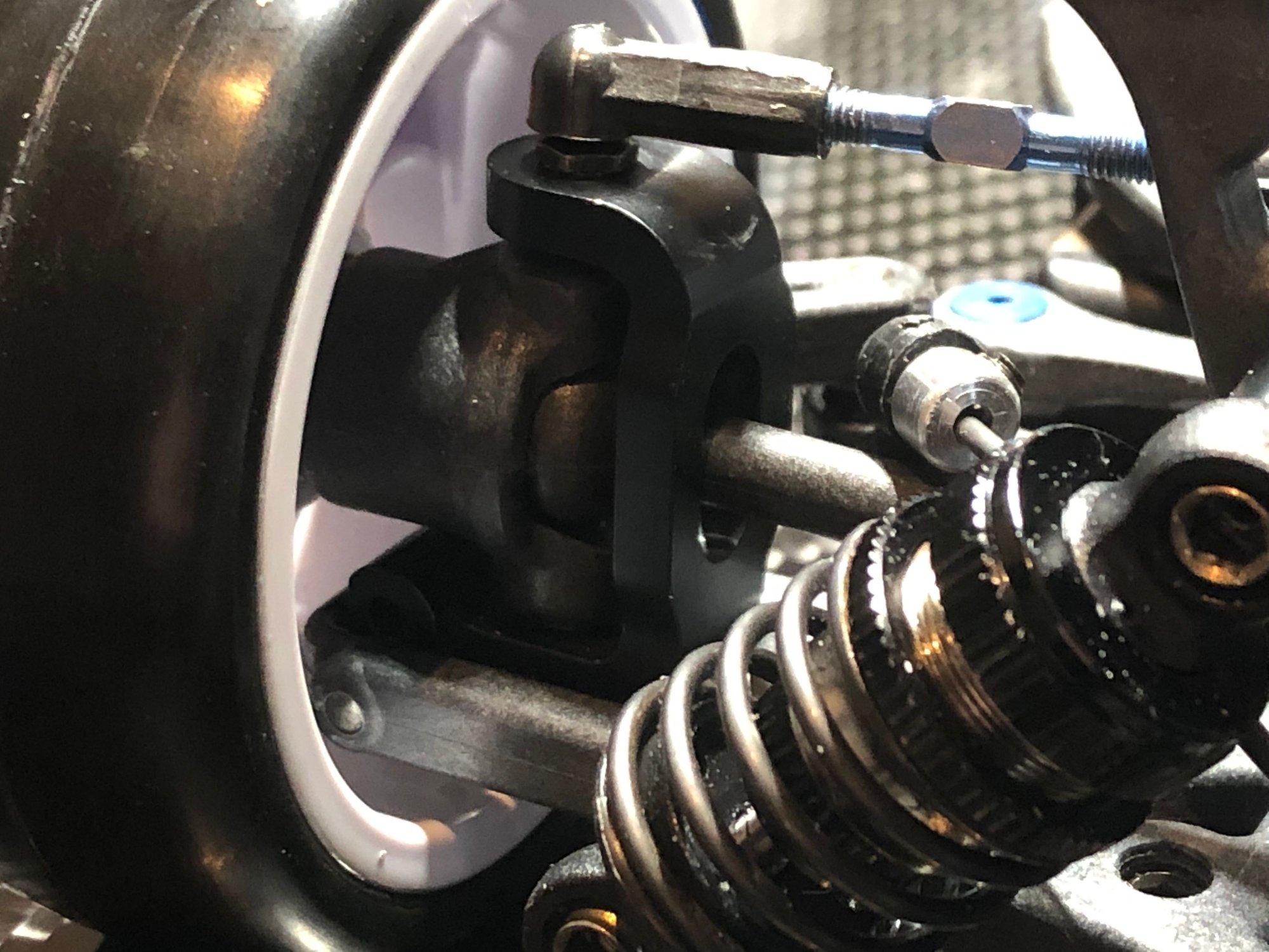

Aluminum caster blocks which are 3 degrees
Shock tower material removed to allow for newer bodies to be mounted.

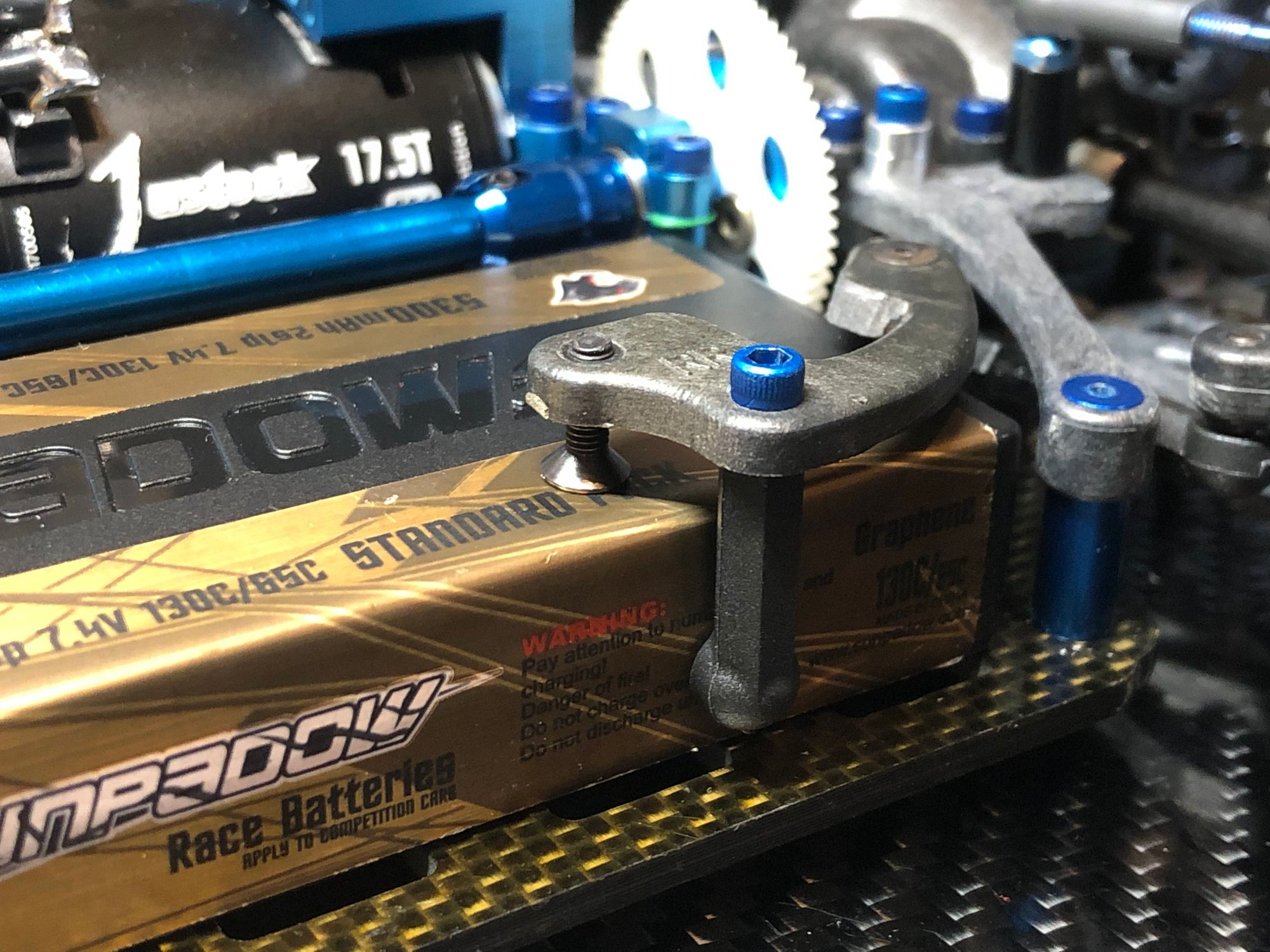

Battery mounting system reae
Battery mounting system front

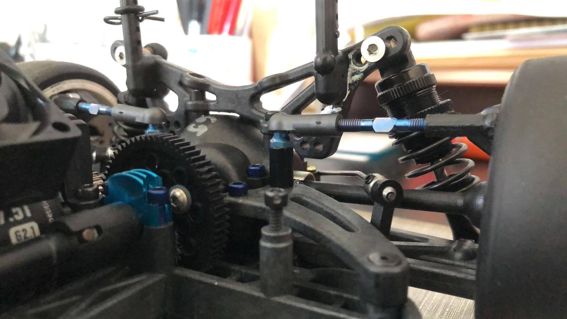

Rear suspension using ARC dampers and offset from the tower to clear the roll bar.
Top view of the rear end which uses rear toe control set at -2 degrees and under compression goes to -3 degrees.
Top view

Nice...Will a top deck fit that car ??? Can the chassis get thinner ???
Another issue is chassis rub in the corners. Hopefully progressive springs can solve the issue, unless some sort of upstop can be retrofitted.
If you want an upstop, just put orings on the shock shaft outside of the shock body.
