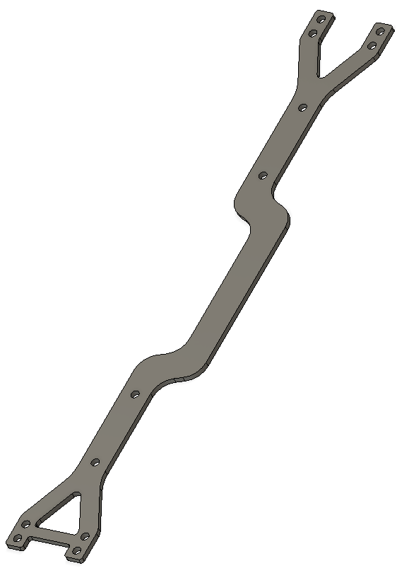

I ran the Arrowmax mid-motor conversion this weekend. Carbon version, medium grip asphalt. The car has way too much flex, you can see it on the bench, and feel it on track. The car is reluctant to turn in, then on exit wants to keep turning when it's time to straighten up. It feels similar to when I tried the 1.6mm topdeck outdoors.
So I'm going to cut some different topdeck options to try. I've seen the Rebellion style one work really well, and that should be much stronger in a crash. I can easily cut a few different widths to try different flex options.

They've gone with a different design to most of the other conversion kits. The ARC, Arrowmax, Capricorn, Awesomatix, Zerotribe, Rebellion... all have a long motor mount, with a mounting point in front of the spur to make the chassis fairly stiff at the front.
The Arrowmax mount is very small, with the mounting points all close together, giving lots of flex.
On the plus side, the Arrowmax quality is great, and the one-piece mount won't tweak like some of the others. And it keeps the motor and battery nice and central. Hopefully with a stiffer top-deck it can be good.

Our motor mount is small as well and I can’t say that I necessarily agree with you that this causes excessive flex. More than likely, the Arrowmax top deck is too narrow at the front. This has a substantial effect in overall stiffness. We found big increases in stiffness simply by widening it by only 2mm in the front section. Our car, while quite flexy, is very responsive on entry and stable on exit.
I will add that kits like the ZT use a std 2.2mm deck, which returns quite a bit of the overall stiffness.
I’m pretty sure that a lot of the ailments can be cured with a stiffer deck. In the meantime, have you guys considered going with softer front springs and stiffer rear to compensate for the difference in flex characteristic? You can remedy some of that behavior by changing springs or raising the roll centers.

A busy morning in the garage, followed by an afternoon at the track!
The conclusion... pretty much anything is better than the Arrowmax topdeck. Even at the start of the day when grip was low it was slower than my normal car.
By the end of the day, after lots of tests and repeated back-to-backs, I ended up 0.1s quicker with the mid car, and a few seconds quicker over a run.
The Rebellion style 'chicane' topdeck and vertical top decks both worked well. Pros and cons of each, but overall I prefer the chicane style as it lighter and neater, and easier to detweak.

I will have to draw up some asymmetric "chicane" style top decks to test. Sounds promising.

I settled on 11mm wide, 2mm carbon. Tried a 13mm one, grip needed to be higher for it to work. Very easy to change as they slide straight under the belts.
