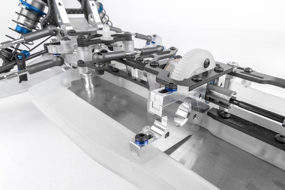

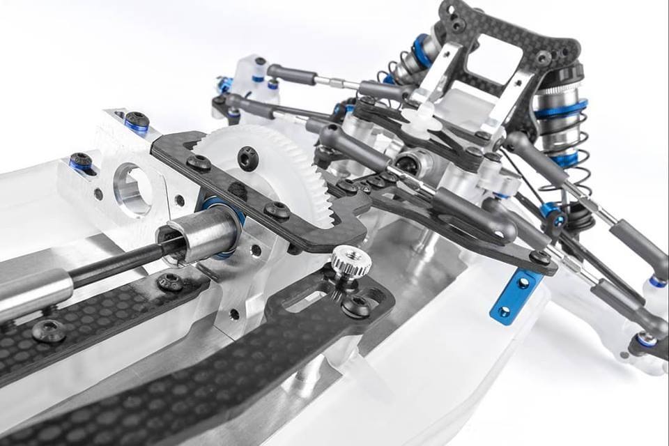

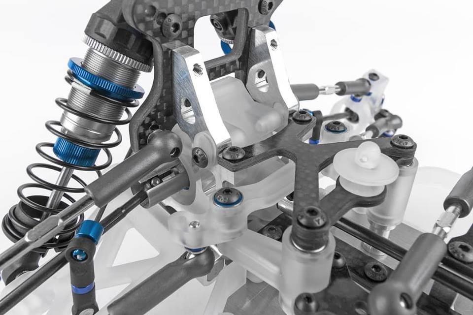

Interesting choice for diff height adjustment. It raises the entire assembly, shock tower, inner hinge pin location. I wonder if they were unable to accomplish it with the spacer layout the B6.1 uses, while retaining the quick-access feature? I guess it probably helps to reach the low ride heights desired for carpet. Adjustable dogbone length also looks interesting. I'm a little leery of the Schelle rear hub design executed in plastic.

The aluminum piece is the actual bulkhead. The plastic diff case will mount inside and be "floating" in comparison to the pins, tower, ect ect. So moving the diff up and down will only move the diff, nothing else. This wasn't the case with the b64 and caused a multitude of changes when wanting to alter the diff height.
...and if I am not mistaken, you only have to remove two screws each and maybe the sway bar to access the front and rear diffs. I like what I see!
Dogbone length will probably not be adjustable on the production car, too many potential issues. With the inserts used for adjusting diff height, the process will actually quicker and easier. I think they nailed it once again!
Yeah remove the roll bar ends and 2 screws on each side of the bulkhead, so 4 to remove the diff case from the bulkhead and then 2 to open the case. 6 total to have the diff in hand. Can't wait, they checked off a lot of boxes that were left open with the 64.
Or now that I look at it you may only need to remove the front piece of the diff case instead of the whole thing. So 4 screws?
Oh yeah, I see it now. Thanks.
I hope that the top two screws will be all that must be removed. Loosen the sway bar ends, remove the two top screws and pivot the diff case down. There seems to be enough space in the D block. Time will tell!
