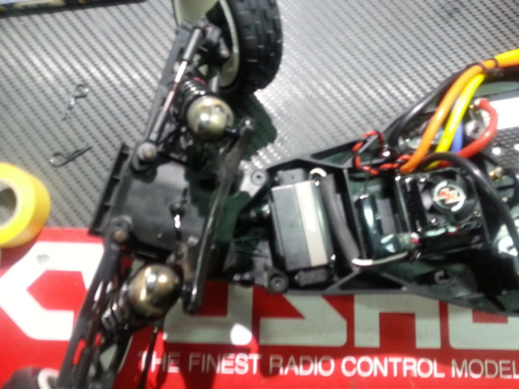

Had my first breakage today. A bit surprised how it happened
But i couldn't ask for a better car to drive. Serpent arms are
Obvioudly stronger than the chassis.
I am glad that my ko rsx 1 10 survive
Wow. How'd you do that?

I've broken two chassis so far, both in the same area. Serpent knows it's a weak spot and have been trying to beef that area up. Contact Serpent and they may send you another chassis and top plate.

I landed a jump side way to be honest ot wasn't a big or high or hogh speed.
It just happened to be at the right angle and then snapped.

email serpent america and they will send you a top plate and chassis,i had mine in two days free of charge! excellent customer service

Unless there is something drastically different between the front end on the RM versus the MM, they most likely will break the same way. This is still a great car, we're just used to arms breaking instead of chassis.
