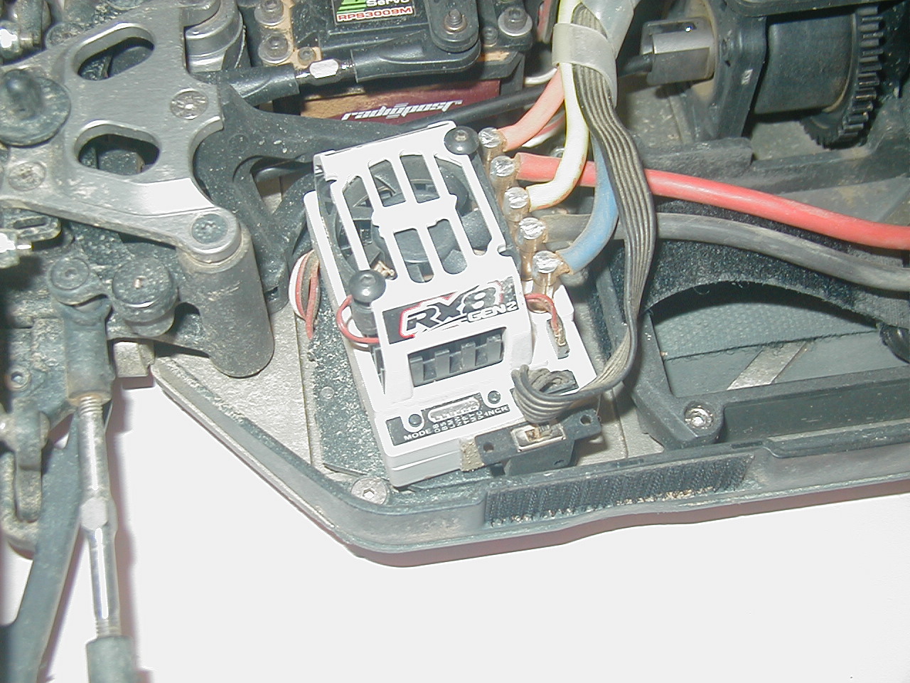

Is anyone using any kind of plate to mount esc to chassis? I know you can just tape to chassis plate but would be much faster to just remove a couple of screws when you get ready to clean.

I mounted my RX-8 to a Tekno V4 ESC tray. I drilled and countersunk holes in the chassis to mount the tray and shortened
the legs of the tray so the ESC wouldn't interfere with the body. Eliminating body interference is why the ESC is mounted
at an angle. I mounted the ESC to the tray using screws into the RX-8 with old shock o-rings to cushion the ESC.
This is probably overkill, but I like it.
