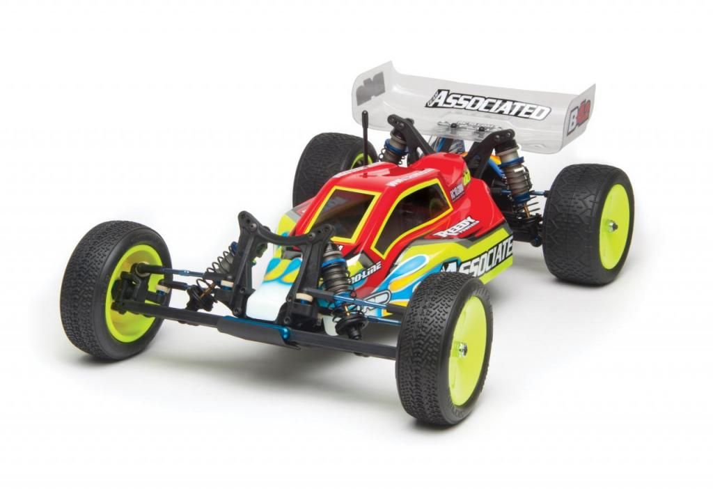

Default Team Associated B4.2 Thread
Discuss
Features
Factory Team 12mm "Big Bore" hard anodized aluminum threaded shocks with TiN "Gold" 3mm shock shafts
VTS slipper (variable torque, multi-plate slipper with 3 drive surfaces) assembly featuring a high-resolution spring
Factory Team blue aluminum bellcrank set
Factory Team 12mm blue aluminum front and rear clamping hexes with hex wheels
Factory Team 7075-T6 blue aluminum 0° rear hubs with oversized outer bearing
+8mm B4 chassis and Pro-Line Bulldog +8mm body
Updated shock towers optimized for the 12mm "Big Bore" shocks
Ball differential with light-weight outdrives
Factory Team carbon fiber battery strap and blue aluminum thumb screws
CVA joints with pin retainer clips
Factory Team rear ballast weight
Factory Team blue titanium turnbuckles
Complete set of precision ball bearings
Factory Team blue aluminum hinge pin brace, milled motor plate, servo mounts, and much more!

Since Mine Was Deleted Heres An Update For U
On There FB Page They Posted THIS! Watcha Think??? Who might sell there buggy to get this????
Features
B4.2 Factory Team Kit Features:
