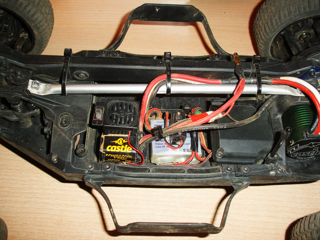

By the way, here's my stiffener setup.
Aluminium tube, compressed on the edges, bolted right onto the chassis. Allows for a bit of side flex, neglects 100% of the front/rear flex.
It is so stiff that I tied up the belt tunnel onto it to avoid it bending again.
