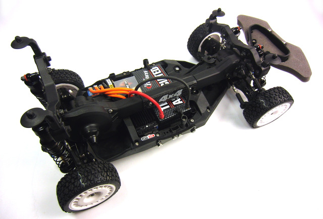

From the looks of the pictures, It appears that the middle section of the chassis has been removed thus shortening it

For some reason when I look at it, I keeping thinking next step in losi xxx-s after owning a couple, but much better!
Very nice, ae could get some reuse there.
Do you have a link to where his conversion is being discussed at all?
