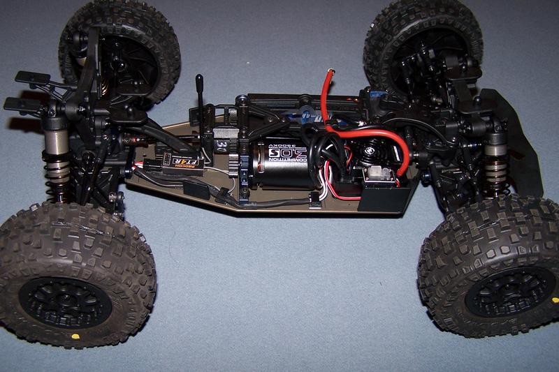

I got everything mounted up
https://i.postimg.cc/fLYZgk6p/100-9006.jpg
and tried turning the driveline by hand...everything was super tight. I thought I was losing my mind, because I have not read about anyone else having the issue with their SC wheels. The second after I took the picture in the earlier post above, I had some wider hexes "in the mail".
