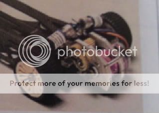

I'm guessing all 4 corners, and the [now open] gearbox, but I get your point.

Actually Gaz,
I think the main issue with the car is finding a body that would fit?
There appears to be a long distance in front of the axles thats now filled with motor and transmission.. LWB BMW Mini shells have a fair bit of space, but whether it's enough is another thing altogether!
