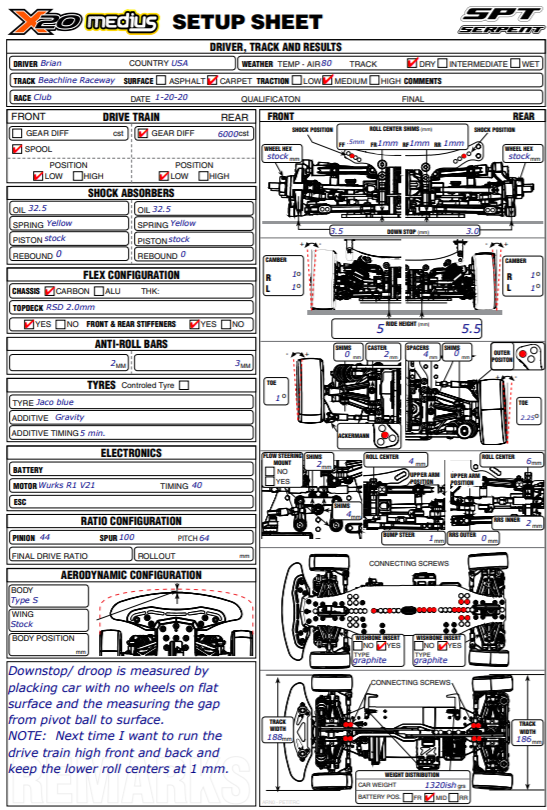

2nd black carpet race review:
I tried the X20 for the second time on black carpet at a track near Cocoa Beach Florida. (I went off of Chris Grenz setup as my base point setup at the beginning of the day with some changes.) From the moment I put the car on the track I could tell it was a huge difference from the first attempt. The RSD 2mm top deck has solved all the issues I once had with the car. The X20 was very well connected to the track and never once showed signs of the traction roll issue I had before. The track started off a little green but as the traction increased throughout the day the car just got better and better. I made several changes and it responded very well to all the changes. The next time I run at beachline I want to run the drive train high front and back. I still want to keep the lower arms at 1mm. Based on my past experience it is the most connected feel and easiest to drive. Perhaps if I ran black carpet often I would find the sweet spot for a higher lower arms.
As all ways I like to hear your thoughts or perhaps ways to improve the setup I have attached with this review. This setup I feel is a great starting point for anyone but it does need some improvements. X20 setup sheet for 17.5 black carpet Medium grip. PDF
when I read “track near Cocoa Beach”, I was going to ask if it was Beachline, but I saw the setup sheet, lol.
