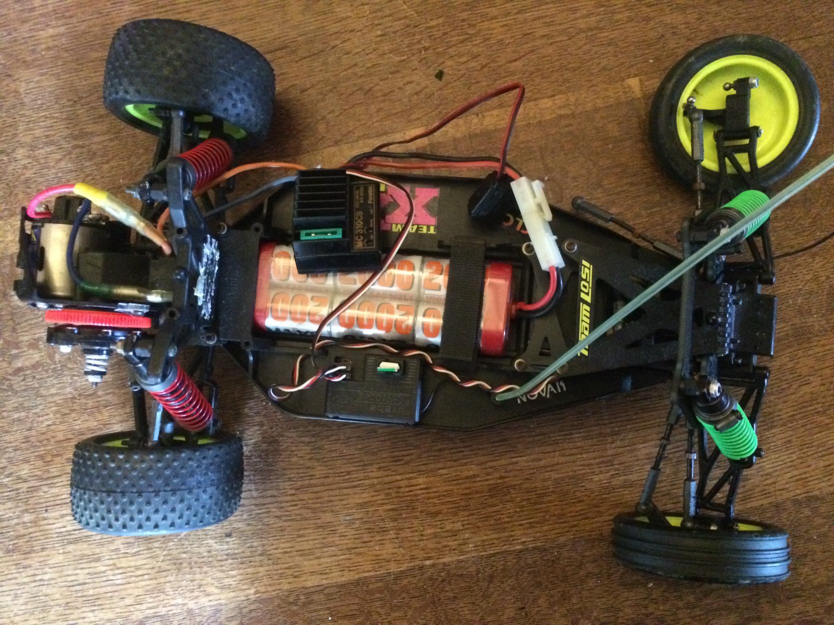

Hey everyone,
Glad I found this place, a busy forum for RC heads! Enjoyed reading some of the new threads and catching up. Long story short, I was into RC a bit 15 years ago (or more) and had a few old bits. (Schumacher Cougar I think, Tamiya TT01 and an old Losi.)
I was going through my loft and found the Losi (pics). From memory I think it is a Losi XX JR or something? I know it's not a proper XX but a cheaper version, but unfortunately that's all I know.
It still works, after pairing with an old Futaba Attack radio - the ESC Motor battery work, it moves and 'steers'. But the steering cranks and camber link at the front left are broken. This will work again beautifully if I can just fix these two bits, and I am excited - but I honestly am not sure what the correct model number or what parts I could get (or substitute) so I'm posting here with the hope that someone can help please! (Googling revealed nothing helpful to me, it's a shame because all the Tamiya bits have old manuals online and stuff.)
I don't have the box or manual, I looked all over the car and there's nothing on there so really, ANY input at all would be really gratefully accepted!
- What model Losi is it, and how do I tell in future.
- Where or how do I get the steering + camber (?) links for it? Don't mind if they're not original, I just want to get the car moving and working!
Got that buzz back when you first used an RC that wasn't a toy and you see how fast it is haha.
Thanks everyone

Looks like a Losi XX buggy (not a JR, that was in the JRX series). There is a 2nd edition of sorts, called the XX-CR along with a few 'special' editions celebrating Kinwald (XX-KE). It appears you just need to pop the ball cups back on? They look a little knackered, you can still pick up the Losi ball caps on ebay and some local shops may still have them on the wall, or go for some RPM. JConcepts makes some nice ones, you can even use AE if you have to, just keep in mind the last 2 are a bit shorter, you may need to get longer linkages to use them in a pinch. You can always go all out and purchase all new ball ends, from the Losi 22 series & then upgrade all the ball cups to the most current Losi offerings as well. It was be pretty truck, but maybe more than you want to invest in your Vintage racer. Ditch the HydraDrive if you plan on racing it, use current slipper plates & pads/spur (again, 22 series is fine) to bring the spur area up to modern standards. Give the shocks a rebuild, toss in current electronics and go racing

Oh, and here is the manual - VintageLosi.com is awesome
http://vintagelosi.com/Manuals_files/xxmanual.pdf

Honestly, unless you are racing in a dedicated vintage series you should look for something else to play with. Whilst the XX is still mildly competent on the track, it is old and parts are getting harder to come by. The only place you will find spares is Ebay. If parts do eventually show up, with shipping to AU/NZ expect to pay a LOT. I've sometimes waited 6+ months for a XX part to pop up and then had to pay a fortune for it.
The only thing from the 22 that fits the XX is the spur gear. The 22 is metric, the XX imperial.
The first thing you are going to break is the front bulkhead. Luckily, these are being reproduced and are available on Ebay. The next thing will be front arms which are sometimes hard to find (I recently paid just shy of AU$100 delivered for NIP graphite ones). You will want a brace on top of the gearbox as they snap the top mounts off and are again hard to find and expensive.
If you're just getting nostalgic and only want to get the car running I'd just replace the ball cups, give it a tear down, run it carefully around the block and call it done. If you want to actually race with other people (who will crash into you), look for a second hand 22 or similar and put the XX on a shelf.

You can also switch to an AE slipper like the ones used onB/T4-B/T6. They fit the Losi shaft just fine. Keep your Losi lock nut that is 4-40. You can run your old Losi spring and spring adapter or the AE ones.
AE #'s
7485 Slipper hub. You will need two.
9603 Slipper pad. Also two.
9739 Slipper Spring
91423 Adapter (check fit, B/T6 uses a M4 nut not 4-40)
I use this on my Losi and TRX cars when I can't get the Losi parts I want.
Camber links can be had as RPM
Longs-http://www.rpmrcproducts.com/shop/suspension-accessories/long-shank-rod-ends-12-4-40-black/
Shorts-http://www.rpmrcproducts.com/shop/suspension-accessories/heavy-duty-rod-ends-12-4-40-black/
Replace them by Axle. I.E. Do all the fronts at one time and same for the rears. They are not exactly the same size as the Losi ones.
I have seen XX parts at https://www.losipartshouse.com/default.asp It has been a long time so try Emailing them to see if they have anything left.
I have had some luck with XXX parts fitting. P.M. me for info because it a long list for how too.
Also, the Duratrax Evader was a near copy of the XX's. some suspension parts cross. Kind of at least. Duratrax Downloads
