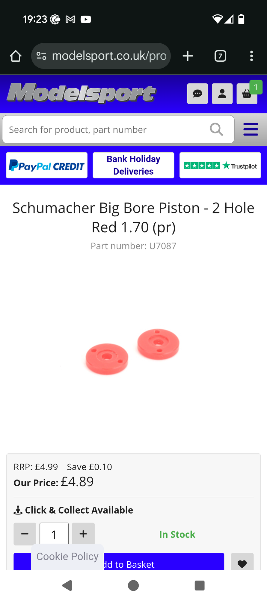

I used these and drilled out the rears to 1.8, there also tapered ones available which are yellow.
