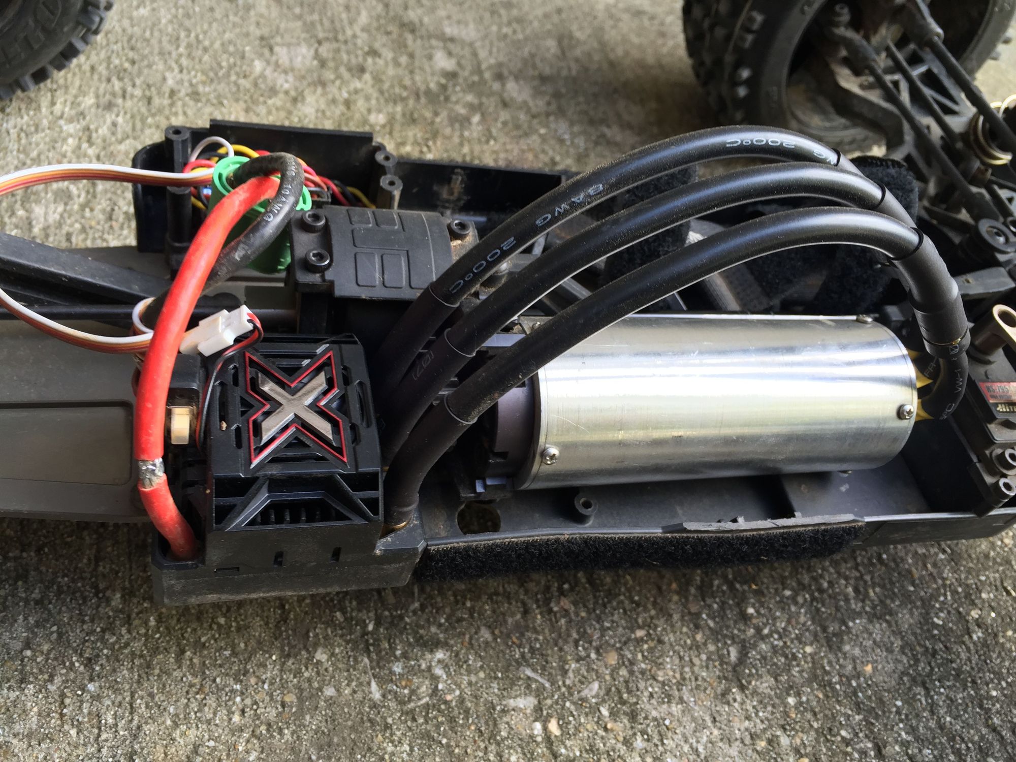

Switched to the MMX ESC.
I'm going to put a larger fan on it and it will stay on the whole time.

Nice, please post some of the Cordova’s Current and Ripple numbers from the MMX when you get to it .
