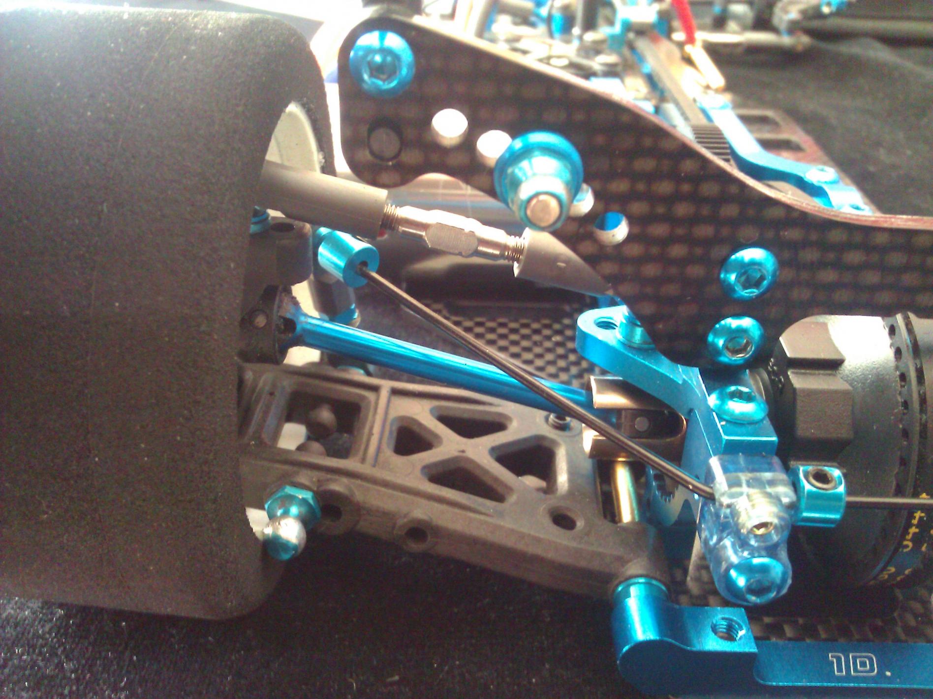

Originally Posted by Blueman Austria
Hy!
I read your question and tried it out.
Look at the picture. I am using short arms with the 416 uprights.
You have to use antoher damper position hole, and have to sand a little edge into the arms where the rims touches when the supension gets compressed.
But i think it is possible!
Attachment 823317
Thank you for the insight
I am still using the kit 415 suspension/hubs etc which will probably differ a little from your setup. Ideally I would just like to bolt them on, and use a 2mm spacer between the hex and the wheel, but I suspect its not possible.
It seems that the 415 is not too kind when it comes to fitting foam tyres.
I suspect I may need to continue using 26mm all round.
It's no big deal, just thought I would ask someone first.
