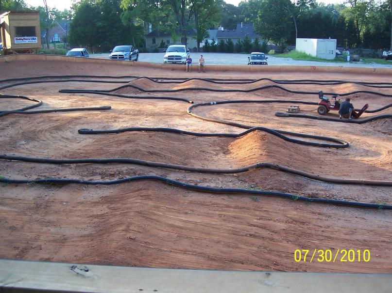

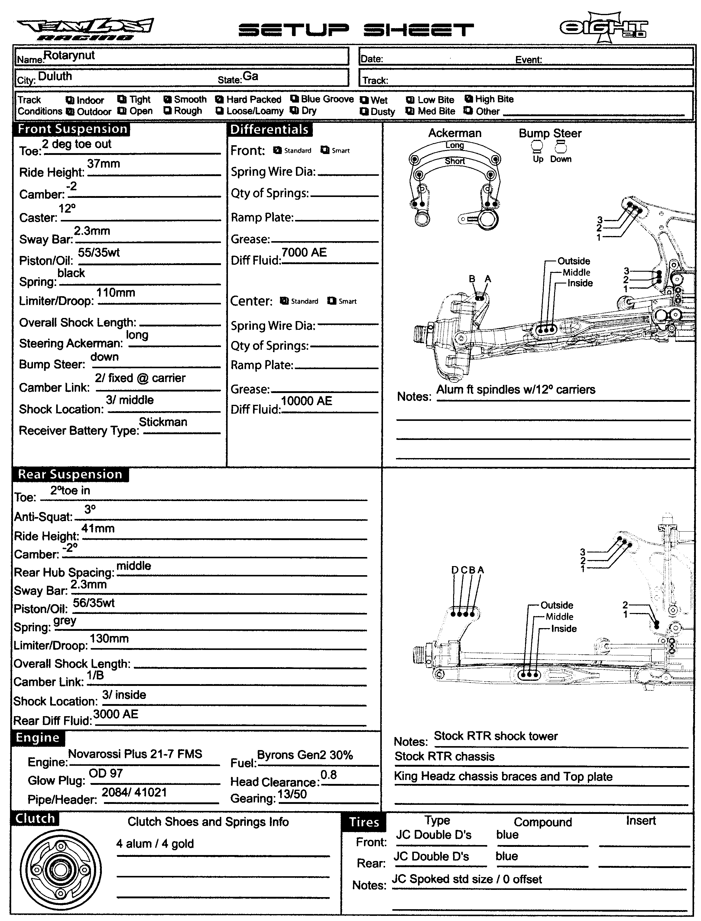

OK guys, my original question is on pg 590,I've checked the truck and all my info is on the setup sheet attached, also the part of the the track thats giving me fits is in the picture attached , the track runs in the opposite direction in which the tractor is facing.the S turn behind the tractor and the double S's leading to the 2 double jumps on top of the picture, If you can give me ideas as to what I can change to get more onpower steering to get thru these two sections I would greatly appreciate it,thanks.
Attachment 634394 Attachment 634405
thanks Jensen for picture of the track Atlanta r/c supercross, Lilburn Ga. &
www.georgiarcracers.com
I would go back to the stock caster blocks, go to 1 degree front toe, and 2-A rear camber link. I would also put the stock rear chassis brace back on and consider 10K front diff oil if the other changes don't help enough.
