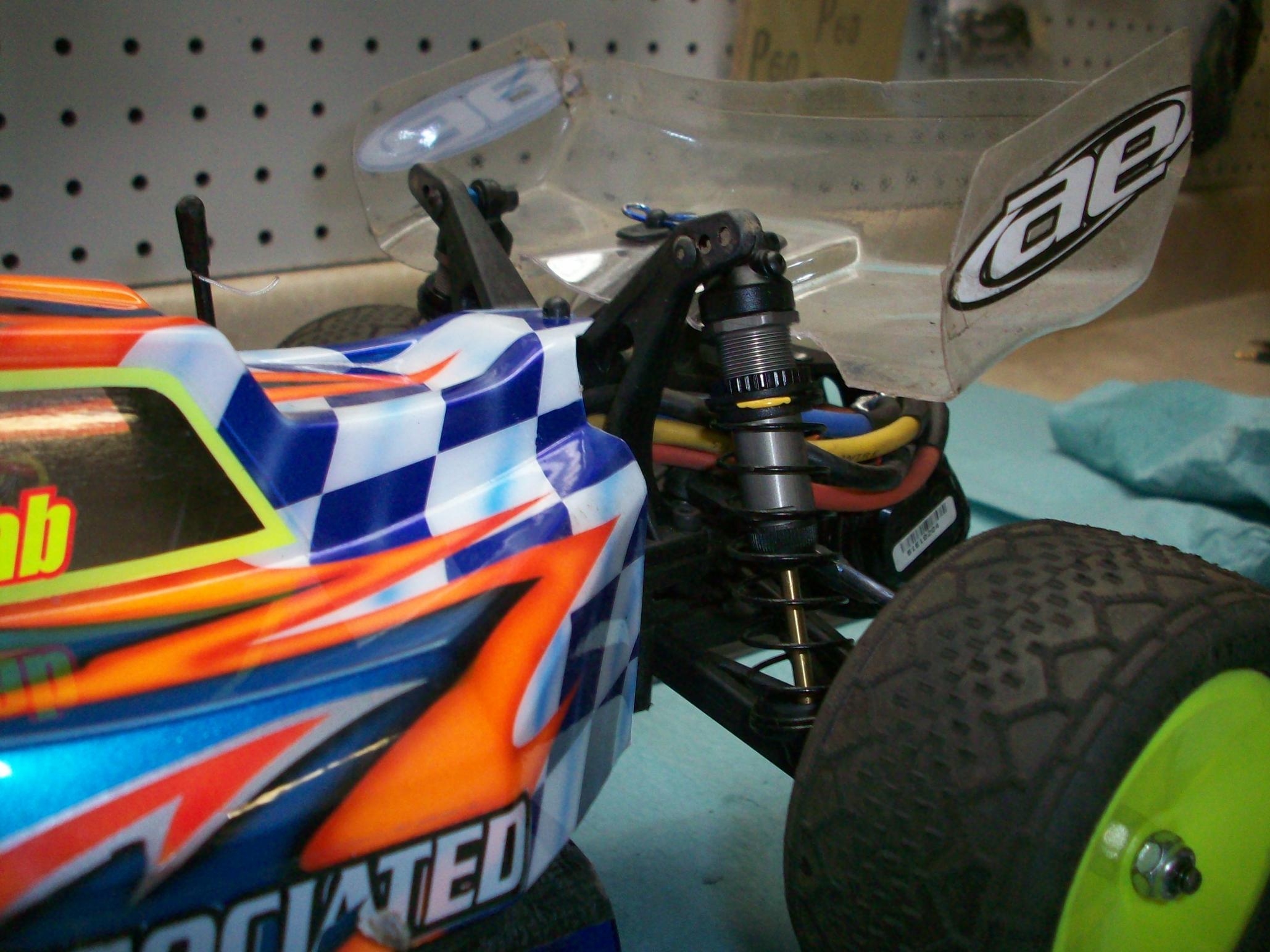

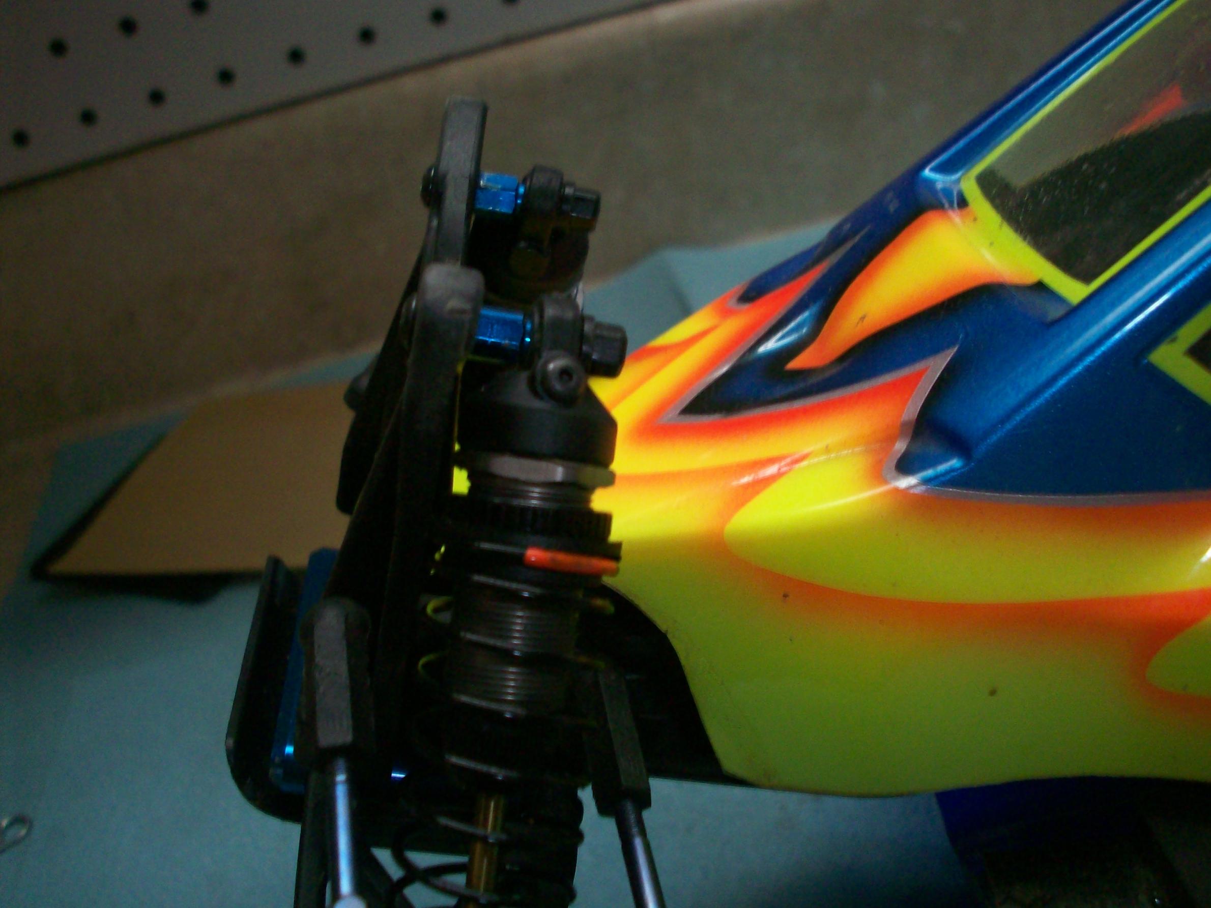

Here are some pics. I use the orange springs on the front and the yellow springs on the rear. Ride height is 24mm for both front and rear. There is still room for adjustment on the shocks. I use 1/2 oz weight in the rear and 1/4 oz in each triangle, so that could make some difference. I also use Traxxas uppers rather than the RPM's, they seem to fit better.
Attachment 850175
Attachment 850177
...Do you have a part number of those upper spring retainers?
