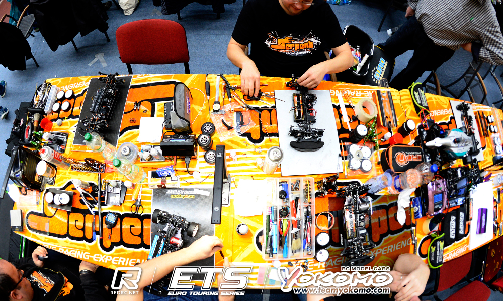

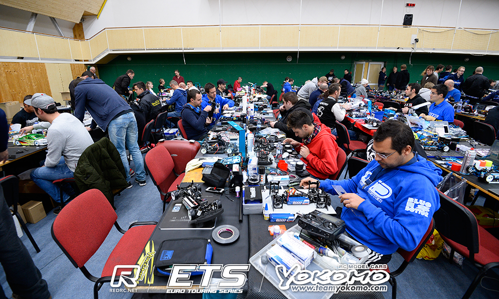

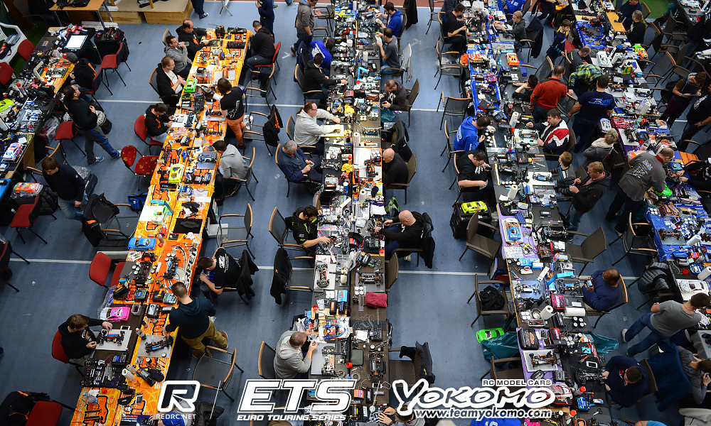

Basically that's what I have gathered from searching older threads, and got me thinking that a money box could be the best compromise. But if the small glass fiber boxes could work as well then they would be much more comfortable to carry around and take up less space. At recent races in Europe those seem to be the standard, as can be seen at recent ets pictures:
I just wonder whether they contain the fire well enough and give enough time to disconnect the packs and dispose of them safely if something goes very wrong. Or maybe they are only using them because of sponsorship deals and will only be around until the first failure?
