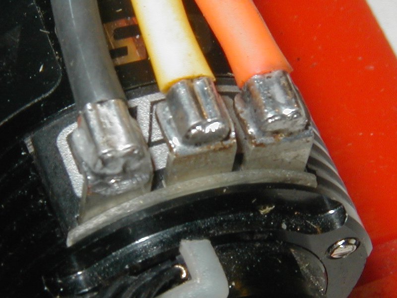

Opinions vary. I started soldering in 1963 scratch building slot car chassis from piano wire and brass strips. I think it is technique that comes with experience, but I pretty much do the opposite of your advice and this is an example of the result I achieve:
IMHO, it is important to put the flux on the thing you are trying to tin, not the solder. Wire ends, for instance. I dip the wire end in the flux so it is coated all around, apply solder to the iron and touch the iron to the wire. The flux already being on the wire, it flows into the strands as the wire heats up assuring full penetration of the solder (in my experience).
For the joints above, the wire was dipped in the flux to coat it, a small copper ferrule crimped on the wire (which caused some flux to extrude), solder applied to the iron, and the iron applied to the end of the wire. (Of course in this case the ferrule prevents fraying.) At that point I also tinned the top and bottom of the ferrule. Soldering the wire to the motor terminals was then pretty simple but again, flux applied to the components, solder to the iron, and then iron to components.
I find that with the ferrule crimped on the wire, the solder flows completely into the crimped section and pretty much stops there. It doesn't take a lot of solder to tin the wire in the ferrule.

Cool use of the ferrules on your leads but what I see in the pics only the center one looks close to perfect. The one on the right appears to have crystallization which is indicative of a longer exposure to heat from the iron and the left one appears to be a bit on the cold side. When you apply solder on the iron the components generally take longer to accept the solder, which is why you find applyind flux onto components more than effective.
When you apply heat to a lead from underneath and coat your solder with flux, you have 3 things working for you. One is obviously the flux and the others are gravity and heat draw. When solder liquifies it want to adhere itself to the greatest surface area that will accept it and with the tip of your iron being considerably larger than most contact points, it needs the flux to help it deep down and I to the wire. Without it your be hard pressed to get it to seep into the wire. In contrast, if you heat the lead and apply plain solder without any flux, you will be able to tin it just the same, but it will likely require a few more seconds of exposure to the heat, but the end result will be the same given the top of the iron is hot. Applying flux to your solder simply accelerates the transfer of heat sioner than without.
BTW, all three of those joints are fine - I think you were extracting more information than was available in that slightly out-of-focus image.
