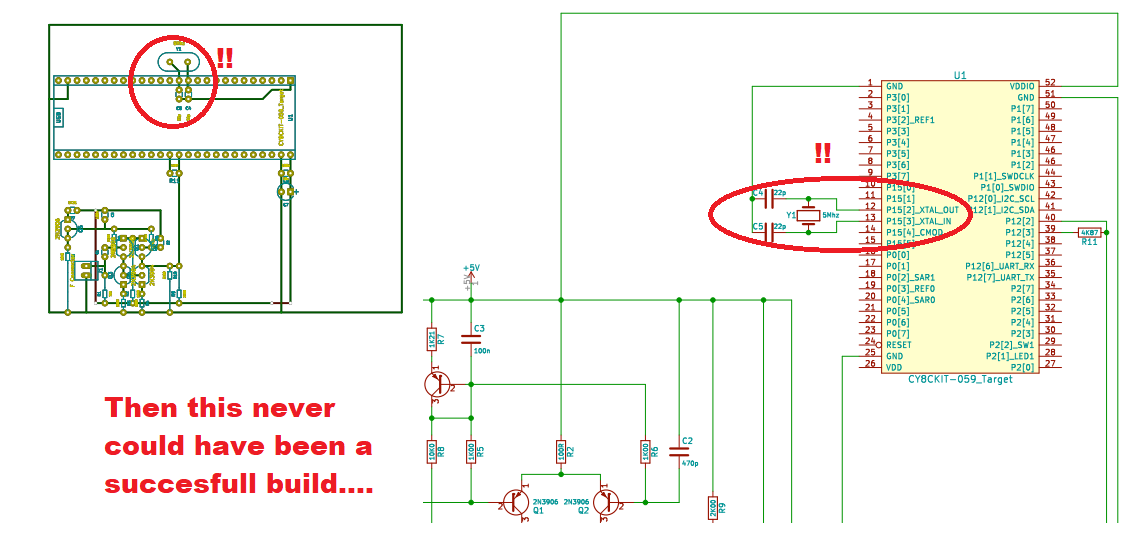

Please advice:
I bought some PSoC kits this week. Installed the adviced Programmer from the Cypress site and tried to upload the latest .hex file.
All fine, no errors.
I attached a 5MHz crystal as well as the two 22pF's like in several diagrams is shown to 15.2 and 15.3
But when I connect the small USB connector to a 2nd USB port, the device manager doesn't show another COM-port.
I did NOT supply the PSoC by 5V at pin VDDIO, because I measured 4.8V DC at that pin already (=due to PC USB also being connected to the large USB pads).
I measured the 15.2 and 15.3 pin of the PSoC, but there is no oscillation found. Changed the crystal out for another one did not solve it.
What is going on here?? In Marco's post that shows the method, the programming takes 23 seconds, in my case just below 4.
It looks like the target is not programmed....is my setting in the Programming environment wrong somewhere?
My PSoC setup is at this moment thus as minimal as possible, only connected the 5Mhz crystal + cap's. Supply of the PSoC through the daughterboard.
Then I tried if I could program at all. so I did the project described here which indeed worked and my blue LED can blink:

I was put the wrong direction because in some early post from other builders were pictures shown were the crystal was at the 15.2 and 15.3....See here below....
And also because the writing on the PSoC PCBA itself indicates the other 2.
I try now and let you know later this evening.

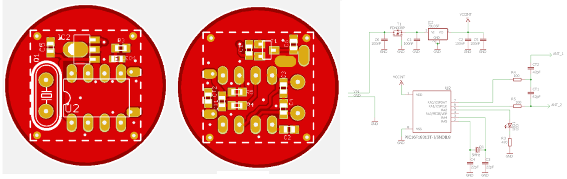

These stupid component shortage globally...not only affecting my daily job, but now also the evening hobby....Just finished my SMT version with the PIC16F18313, did a quick check on availability before ordering the PCBA....Now need to change all to the DIP version PIC. Oh well, then I don't need the ISP pins anymore and can use the RC Hourglass programming socket. That saves some space on the PCBA ;-))
#780
Joined: Jan 2013
Posts: 61
From: Schoonebeek
OK, few hours later the DIP8 versions done. The idea is to use the round shape if the PCBA is to be mounted inside a PVC ring, cut of 32mm PVC, some 8.5mm height. The outer surface of the ring can have a groove machined in, in which the windings will fit. In case a dedicated 3Dprinted housing can be made, the disc PCBA is cut into a square which remains as a 18mm x 18mm transponder PCBA. In that case the windings are in 'free-air' fixated by the 4 poles that I see others do before me.
