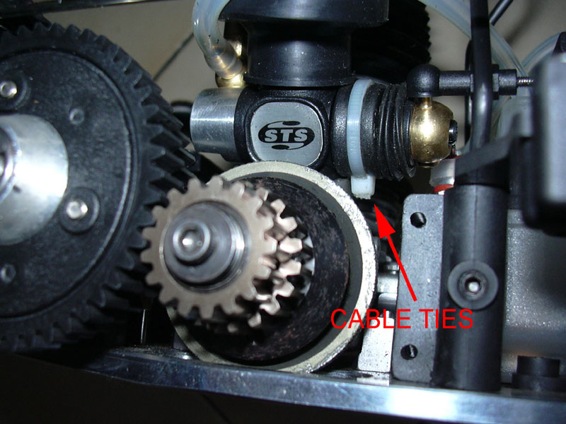

man I am still having trouble with .28 still has the stall problem when motor gets in the upper revs, carb started leaking also leaking from brass pinchers that hold the carb. so I sealed the carb and holders with some silicone. thought that may have been the problem. its very strange when motor leans out on its own at the very end of the tank it doesnt die when reved but if I try to lean it out with the needles it does. i am so lost. could the needles be bad if so where can i get some new needles and an oring for the carb. also what are the factory settings for the needles
ryan6682 is offline   Reply With Quote
Old 02-25-2005, 09:46 PM   #42
Nitro Tech
dino.tw's Avatar
Join Date: Oct 2002
Location: I can drive!
Posts: 1,459
Sorry for any inconvenience. I thought I knew where is the problem. You said it will die when you WOT? And somewhere leaking when you WOT? Try to use a CABLE TIES to tie the Dust Protection of the carburetor. Please see the attachment.
I just tried a .28 and recorded the needle setting.That is running setting not break-in setting.
High speed needle -- about 2 ~ 1 1/2 turns out
Low speed needle -- about 4 turns out
I'm using 0.4mm shims with 25% nitro,#5 plug.
Try it first. If you still have problem after testing,don't worry. Just send this engine to me. I will check it carefully. And let you know the result. But you know it will take some time.
