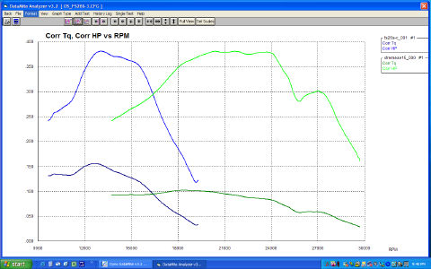

Here are the results of the 2 stroke vs. 4 stroke dyno tests.
The blue lines are the OS FS26S-C 4 stroke and the green lines are the AE ThunderTiger .15 sport engine. Both are completly std. No modifications.
Note: The four stroke came with no exhaust so currently I am using a short headpipe and FS26 silencer I picked up today.
Results clearly show the 4strokes superior torque in lower rpm's.
Almost 50% more than the .15 2 stroke. However the 4stroke is definitely limited in the rpm dept. Powerband is very narrow compared to the 2 stroke.
Later I will show more tests as I make progress in testing.

mxwrench is pretty much right too about the 4 strokes info.
I'm very interested in the development of this "modified" 4 stroke. I'd like to see stronger pushrods paired up with stiffer valve springs. That would certainly give it a little more RPM. And with a new profile cam with bigger valves that you're making, I'm sure it will be a beast in the top end. But definitely keep us updated. I love running my thumper but just wished it had more power!
