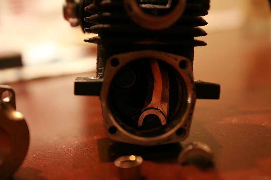

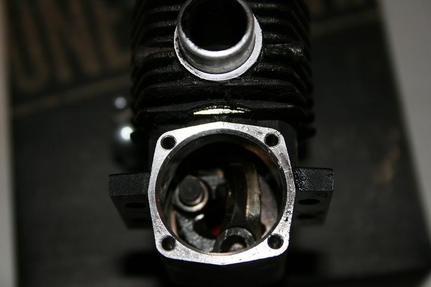

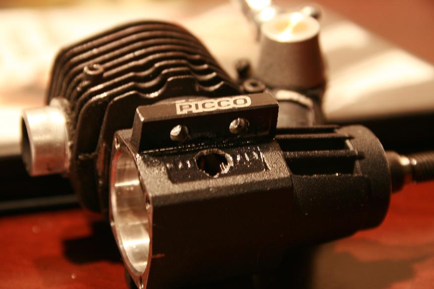

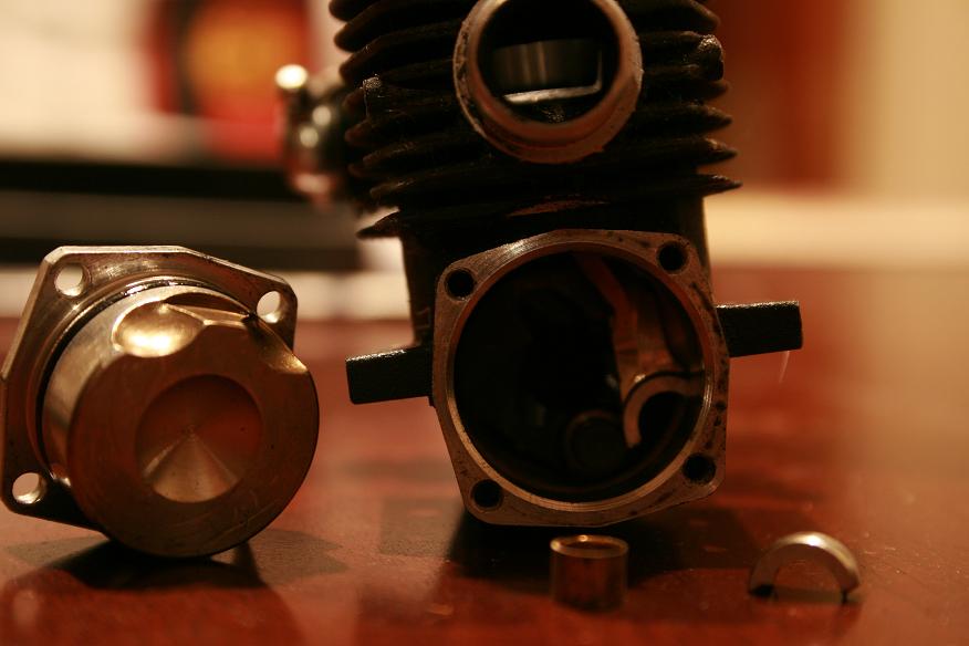

So I've had a Picco Red Dot Evo3 in my Serpent for the past 1-1 1/2 months. SOB blew up on my a** today
I've heard all the stories already about these motors .... but DAYMN LOL
Here is some history on the motor
Broke it in ... ran great
Change Connecting Rod before 1st gallon was finished (about 2 full fuel bottles of fuel left in that 1 gallon container)
Installed new Rod ... ran needles Rich ... 1 tank idle .. tuned it
Was using PowestMaster 30% Nitro 16% oil fuel ...
Motor was running strong ALL day today and just blew the blew on me
14th tank since connecting Rod was replaced and it blew today
Oh well ... I'm going to look into Novi, RB or a Maxy's motor next.
Attached Thumbnails BYE BYE PICCO-picco-blown-002.jpg   BYE BYE PICCO-picco-blown-003.jpg   BYE BYE PICCO-picco-blown-004.jpg   BYE BYE PICCO-picco-blown-005.jpg

as spotted by somebody in another topic, what did you do with the engine?
If I look at this picture, it is not surprising me that the rod let go...
good lord... how rich was this thing running? All those black deposits are from either running REALLY rich, cheap lubricants, or both. I'm betting both. As we all know, solids and liquids arent compressable like gasses are. So, the parafen (wax lubricant) deposits built up on the crank, top of the piston, cylinder head button, glow plug, etc. Compounded by the excess (unburned) fuel and lubricant in the combustion chamber, reduced the compressable volume. This increased the compression ratio and placed more stress on the conn rod, resulting in catastrophic failure.
BTW black deposits like that are from running too rich or to cool. Running too hot results in white ash or a rainbow discoloration of the metal parts, depending on the alloy used.
Just goes to show the importance of taking your time to get the tune right.

Ok, so we the help of some friends we figured out wtf happened to this Picco motor.
I'm a noob so GO EASY on me
Upon replacing my connecting rod I had mis-placed the shims. Causing the motors compression to rise to only God knows what level.
I had only put 1 shim back in
It was my fault why the motor took a dump. As far as all the grease and what not around the motor when it blew I the gasket for the header had ripped about 9-10 tanks prior and I just never replaced it
