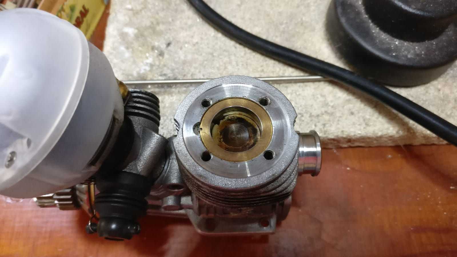

The course..???...Whats the course of an engine?.....anyways.....I just ran in my Nova Ison in the C803 at the Mach in Heemstede. Ambient temps of around 20 to 25 degrees, relatively dry air for the Netherlands. It now has about 4,5 liter of runnertime through the chambers and I just changed the conrod.....By the looks of the piston it has been run pretty rich....care for any comments in this?https://cimg5.ibsrv.net/gimg/www.rct...0bb91c51f.jpeg

Stroke was what I wanted to say ... I use Google Translator sometimes the translations are not the best.
ralphierace13 05-31-2018 01:25 AM
Dam what did you do to that piston!! Lol
Roelof 05-31-2018 02:02 AM
My piston and head after 5.5 liter:
https://www.rctech.net/forum/showpos...7&postcount=37
Runnertime is a fuel with a high content castor oil, it just burns brown/black. And the stock ISON21 is not the highest performing engine so it does not burn cleaner as well, as long the temperature, smoke tail, sound and speed looks right is must be OK.
ralphierace13 05-31-2018 03:38 AM
pedro look at his pic that's how it should be! when shimmed right, you got some funky looking burn pattern going on is it shimmed right? in your post you put temperature 25-30 degrees is that correct degrees? If so, thats way to cold to break in a motor
