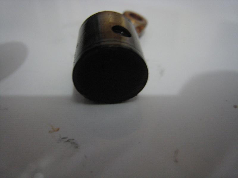

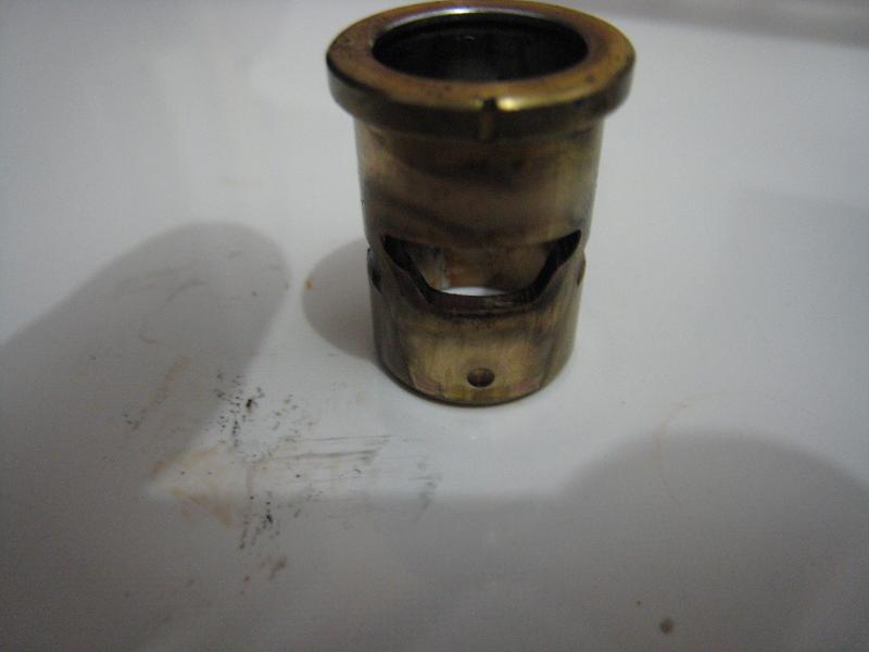

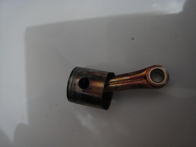

Okay I think I cooked the engine tonight, it was running over 150 degress celcius.
To me it looks like the sleeve is discoloured (like when you heat a piece of steel it goes rainbow) but I can't tell
what do you guys think?
it's an OS TG so the liner isn't brass coloured to begin with.

to me the colour looks ok... what u need to check is the pinch of the p/s and is there any detonation on the piston surface!

It still has pinch (a bit thristy though) and the top of the piston is dark brown in like one spot,
I pulled the wrist pin and conrod out and there is a spot of brown colour underneath where it is on the top of the piston.
What do ya think?
Also I can't be sure but the top of the piston doesn't look "flat" anymore

Gday ashley, that engine is fine, u should see mine lol. also u got a pm (about increasing performance on them)

cleanup the piston and button head and check for any tiny holes...
if the surfaces are still smooth then everything still ok.

Well I gave the piston and head button a polish and it looks good.
Thanks for all the help guys
