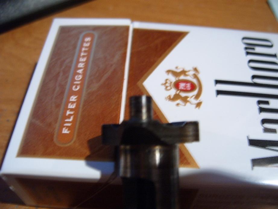

I will try to make pics of my collection of cranksafts with wornout pins (with visible damge), but not sure if my camera can catch it. I will try anyway. If anybody has good camera and have worn out shafts-plaese let's halp each other and post your pics here. I was ale to catch with my camera only one visible damage
