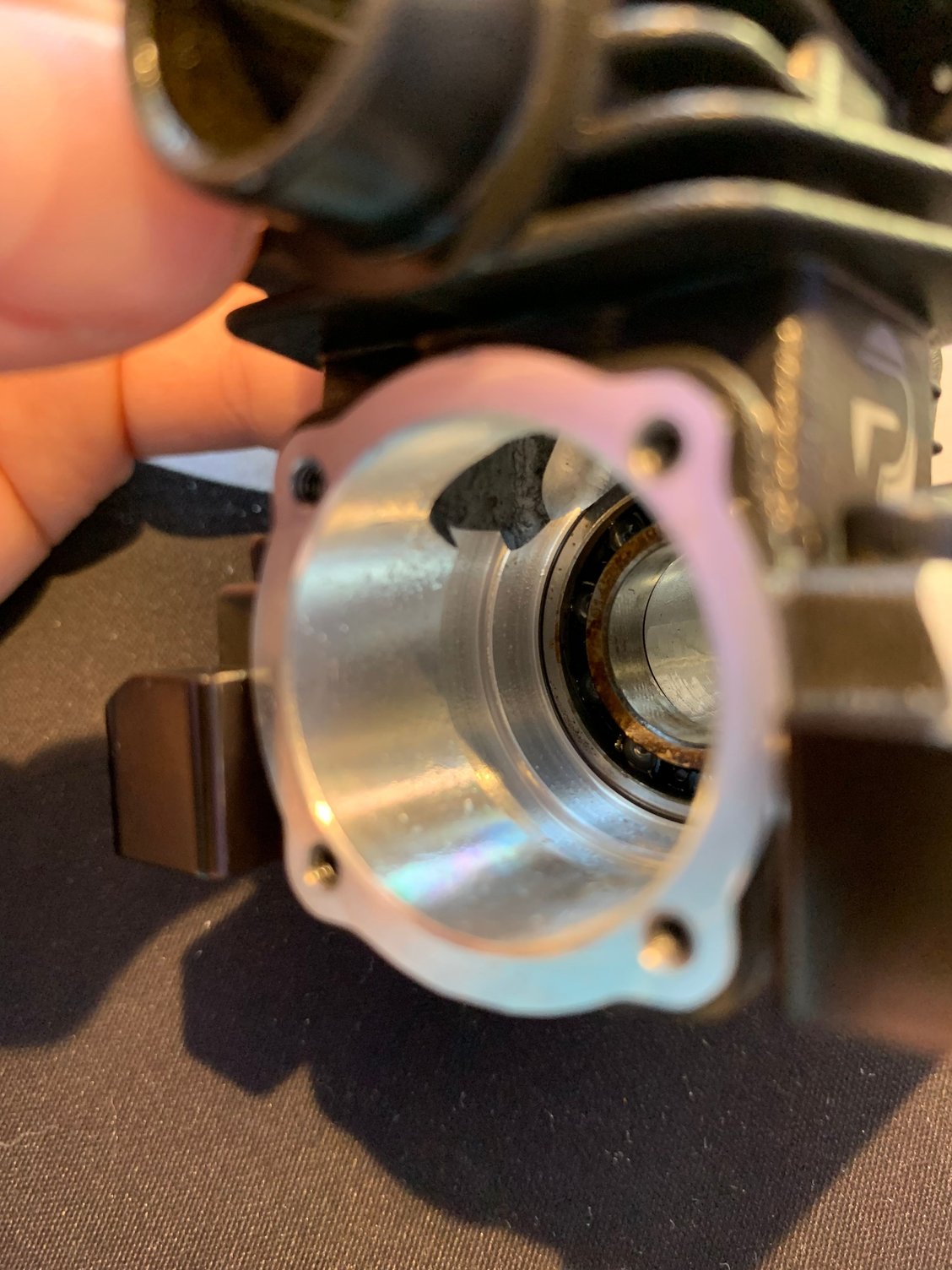

I'd like to hear some opinions on how engine bearings generally should feel when theyre good and when they need replacing.
In particular i have heard that rear engine bearings (especially ceramic ones) should feel perfectly smooth, no doubts at all about it, when spun from the rear with a finger. Almost like there is zero friction in the bearing.
Is this true?
I have been hearing a metallic sort of hissing sound from my engine when running and upon inspection of the internals i find the rear bearing to be slightly sandy in feel. Its very slight and not catching at all. But its not absolutely perfect.
Keeping in mind that this engine is basically brand new and just finished breaking in recently, does this mean it needs replacing?
The front bearing did have an air leak and is being replaced. Again strange for such a new engine. Could this have been the noise?
Bottom line is... The ceramic rear bearing feels slightly less than perfectly smooth and the engine is making a sound that i would describe as bearing noise. Does this mean i should replace it, given that this bearing is still pretty new?
(The engine is a picco p3tt)

For sure, the rear engine bearing must be smooth, no grit or anything notchy. If there is grit in the bearing chances are there is damage to the crank and possibly the crank. If you are capable you need to do a full inspection. If you are not I would recommend either Adam Drake or AMR to inspect and diagnose your engine. Good luck.

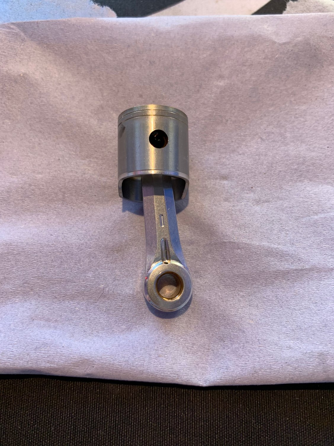

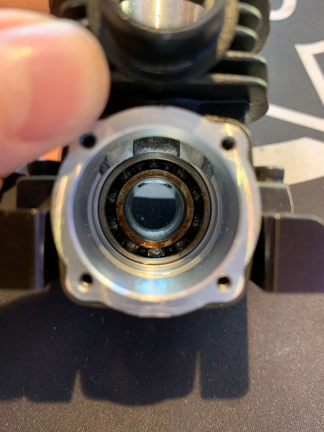

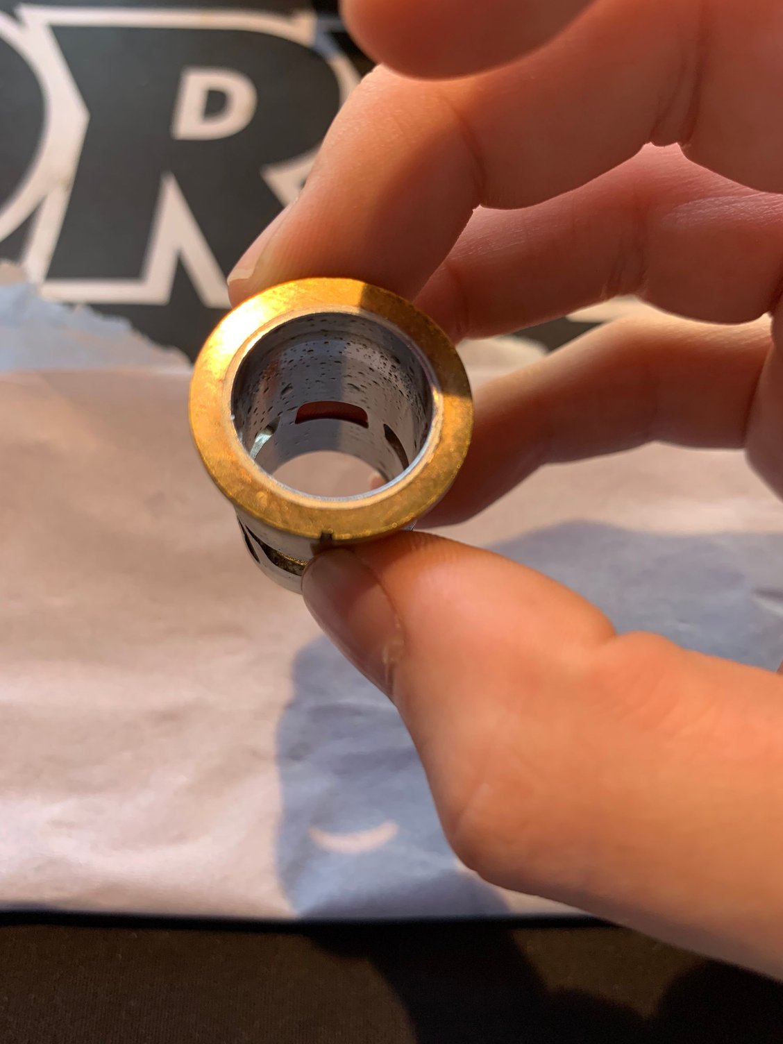

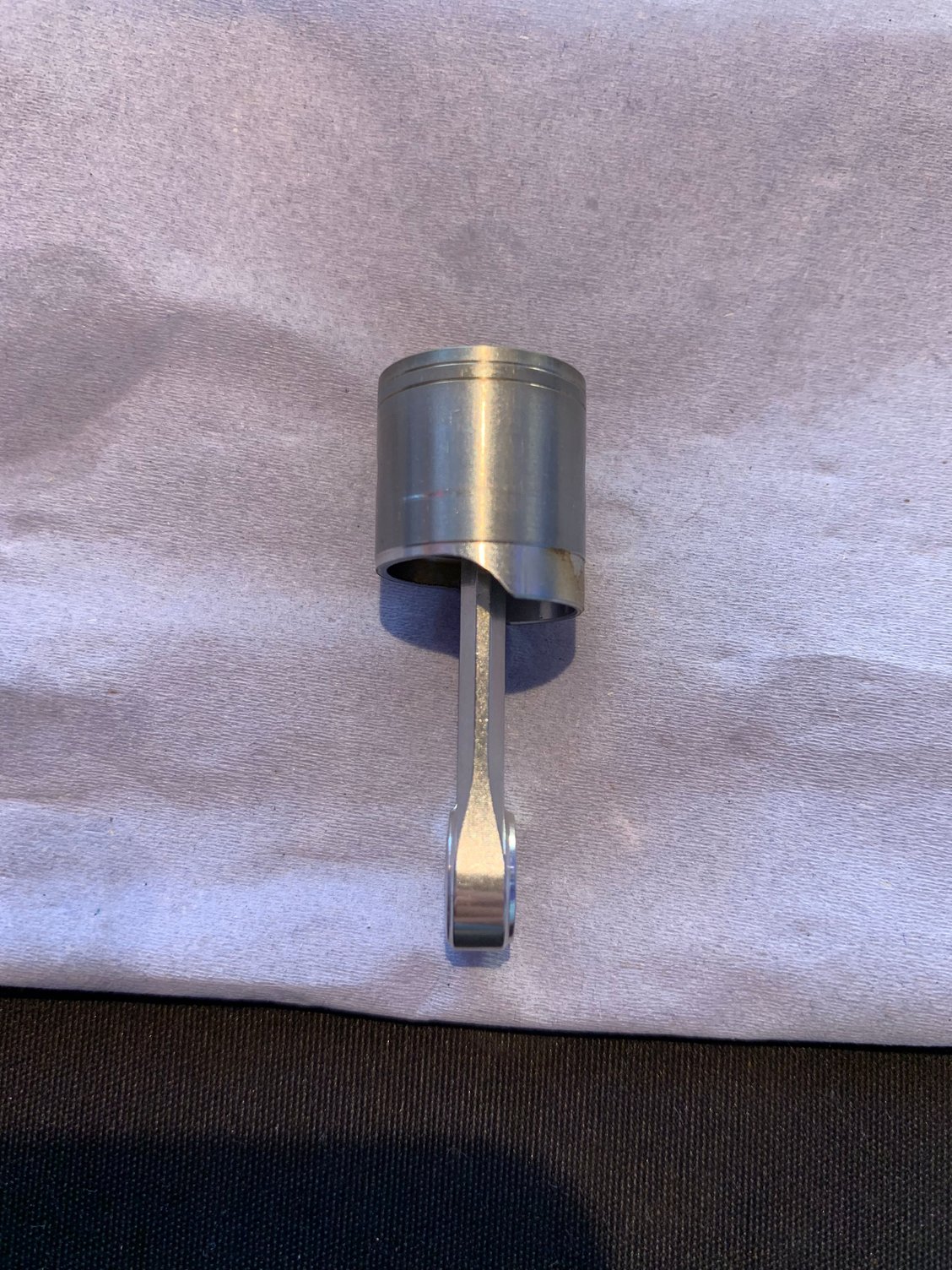

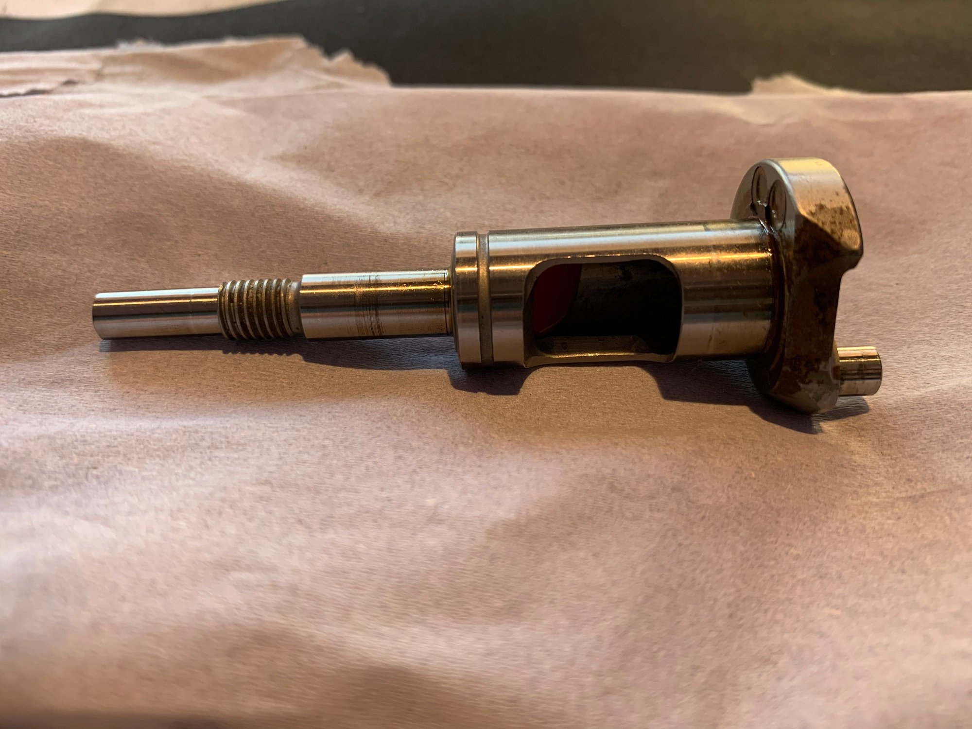

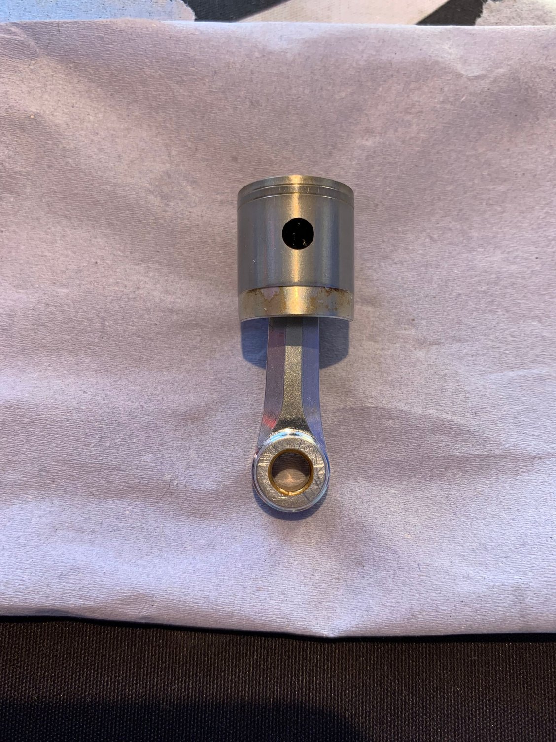

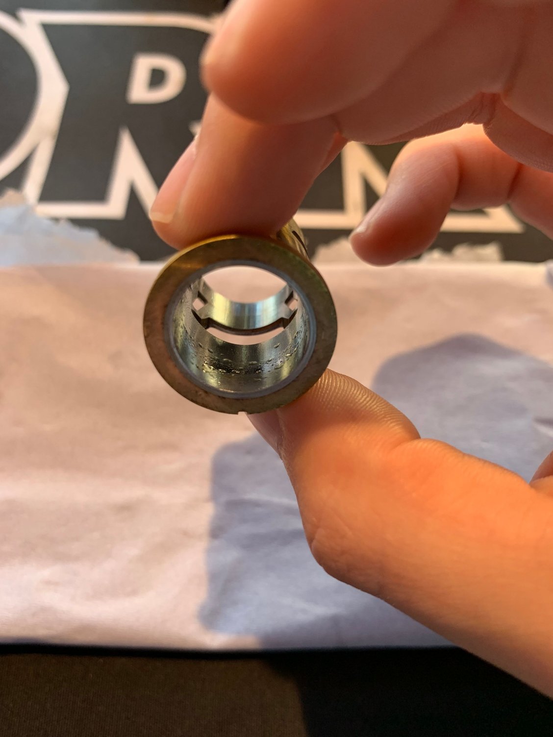

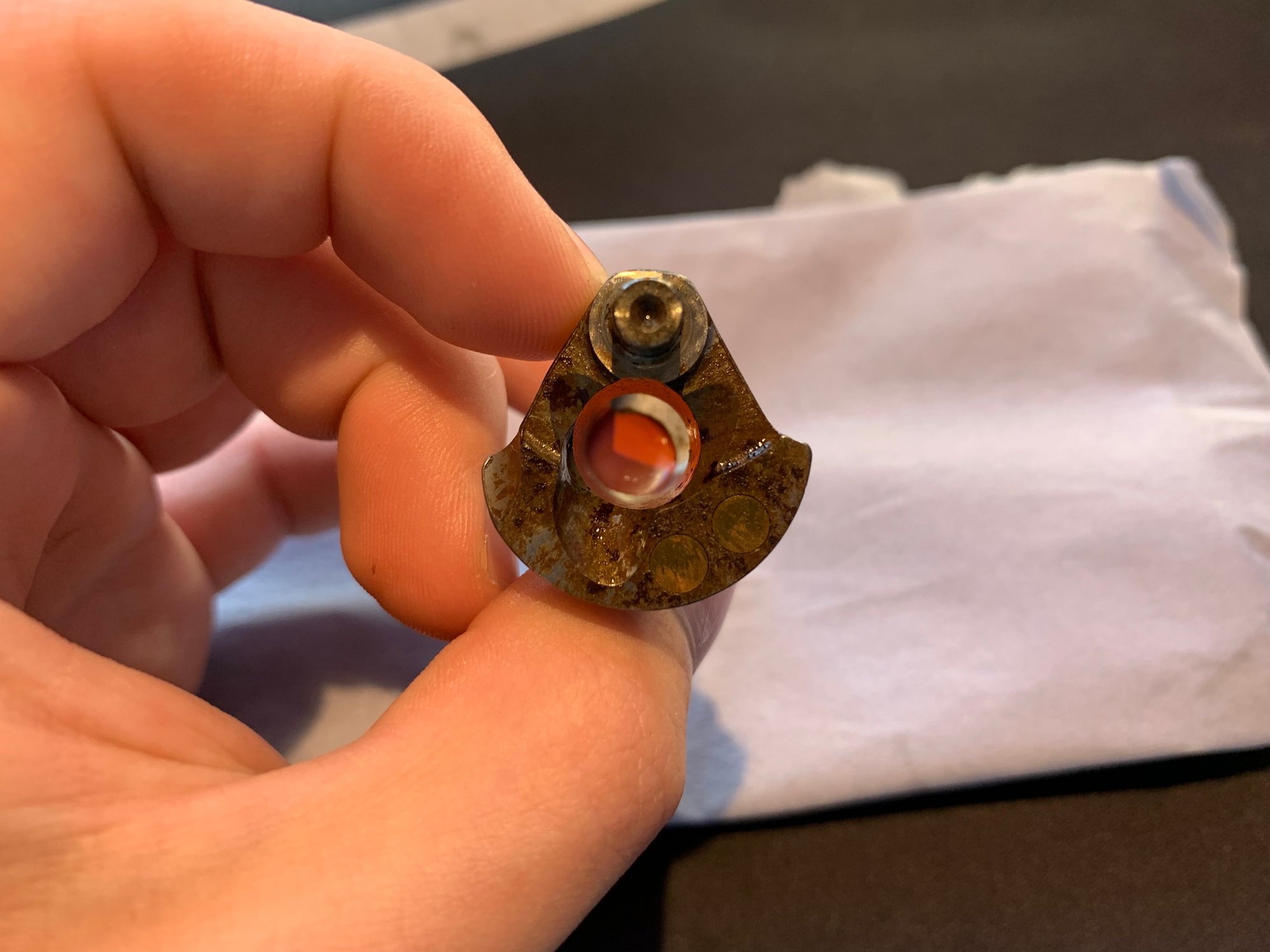

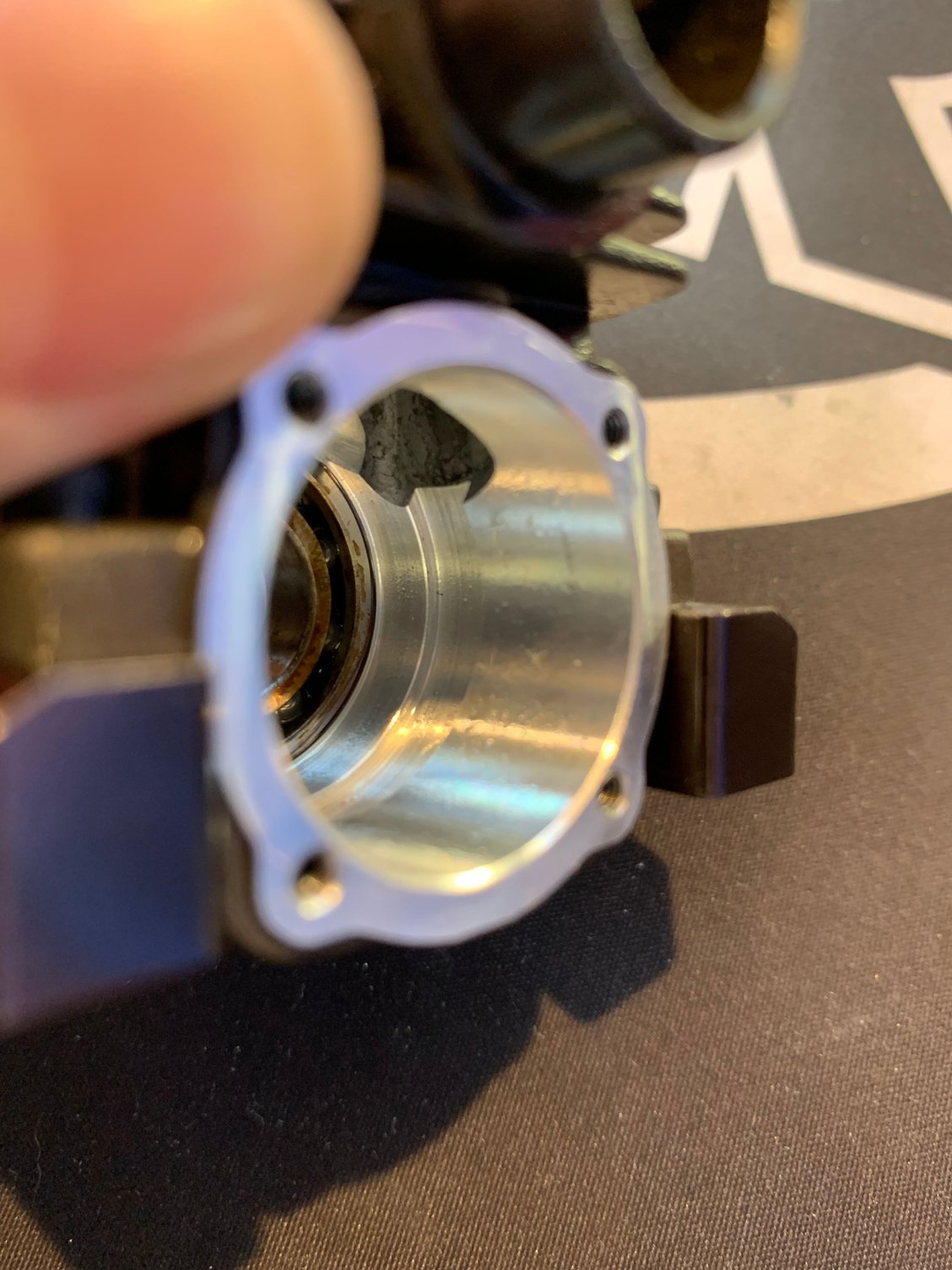

i can provide some pictures of my engine's internals, i see nothing wrong with any of it and know roughly what to look for.
The crank has some rust around the rear but that is very common with this picco engine given that it lacks a DLC coated crankshaft.

Max Rackstraw, I hate to say it but if that motor was broken in with that rust on it? That is your bearing damage. Little bits of rust would flaked off and would get in the rear bearing.
If it were me, this is what "I" would do. I make no claims but have been racing a long time and like to get my moneys worth.
Take the motor completely apart and clean everything.
Get a new set of bearings.
Completely clean off all the rust from the crank. Use a dremel with a fine wire wheel and some type of oil. Maybe the Mugen Seiki assembly lubricant, something that wont attack the silicone in the crank.
Put the engine back together completely clean, rust free, and with the new bearings.Use the assembly oil on everything during reassembly. I bet you will be fine. I have done this several times and the motors ran flawless for the lifespan of the motor, 8-10 gallons.
Good luck.

Your bearing feels gritty because it's rusted. Whatever you are doing in terms of fuel, after run and storage needs to change.
