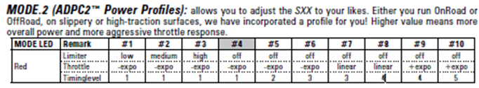

After going back and looking at the manual, it does add timing.
I run profile 7 with a 7.5 in 2WD buggy, and there was a noticeable increase in power. I do prefer the linear feel though.
edit: lol @ the little pic. I'll see if I can enlarge it.

Second try

Y- I have the sxx and there is a no boost/no timing setting/profile. Mime is a stock spec sxx though. Which are you running?

The stock spec sxx profiles are all boosted....the sxx only profiles 5-10....

Should have clarified - stock spec V2 has no boost/timing setting. See you boys tonight!!!
