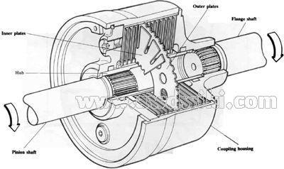

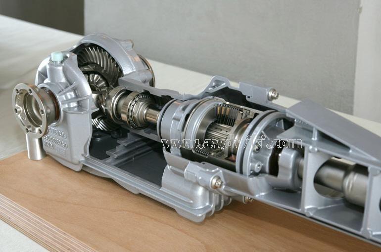

He's asking about a viscous coupler. The rear drive shaft of such a diff/couple is locked to the carrier like a 2wd car. The front half of the diff/coupler floats free inside the diff. No gear connection at all. At the end of the front drive shaft is a fan like impellor inside the diff. Fluid resistance spins the front of the car.
It would suck in 1/8th scale, which rely on front wheel drive. Might be nice in 1/10th scale, when 2wd buggies are lapping the same times as 4wd in very high grip conditions like astroturf.

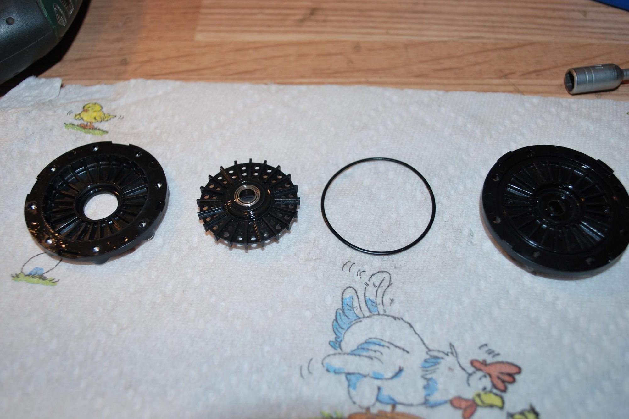

Sadly, they usually look more like clutches. Losi's ''hydradrive'' gives you a better idea. Just apply it as a center diff, instead of as a slipper.
