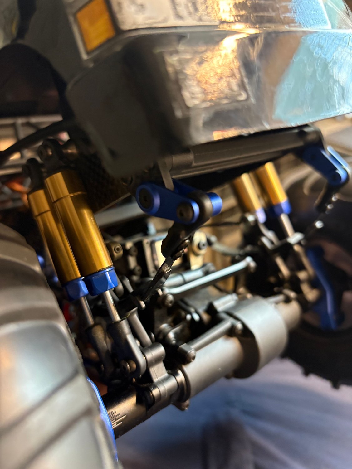

Bent leaf springs happened to me too! Only in front, though. They need to make harder ones. I will try harder oil.
Otherwise a really fun truck on a backyard grass short course.

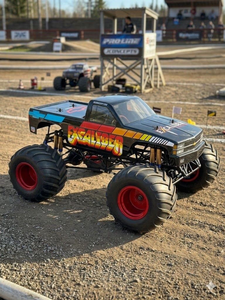

And when the front springs are collapsed, you end up with no suspension travel, and the next thing that break is the front gear case. I broke my second one this past weekend while racing. I'm running a pair of Hobbywing's 5400kv 3652SD motors, and the track is sealed clay.
I'm the blue monster truck starting at the back of the pack.

I noticed the bent one had the leaf ends attached to the wrong (opposite) side. one out of four. I fixed it.
