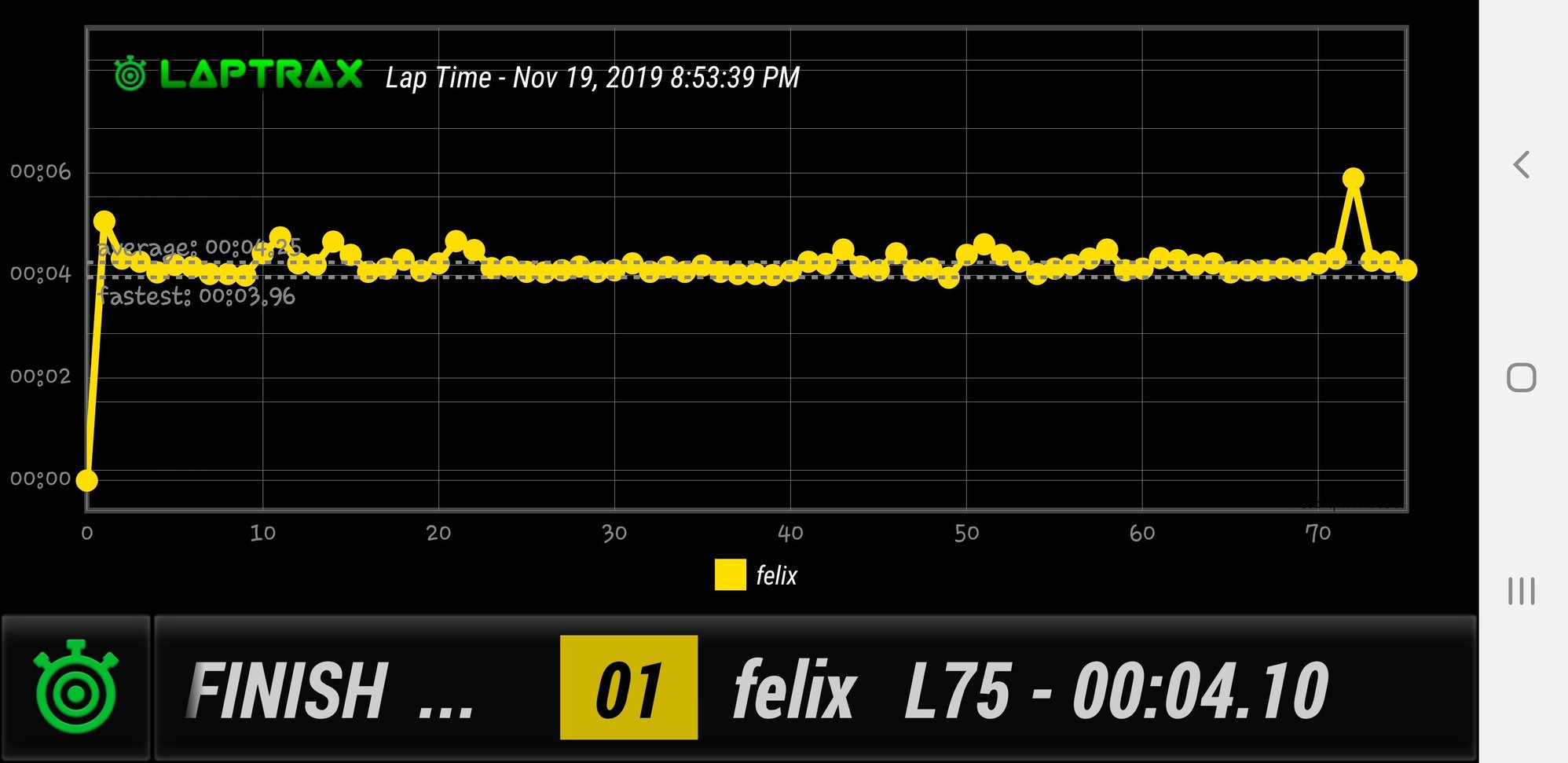

Scionara05 11-20-2019 08:57 AM
Class-stock
Date-11,19,19
Location-basment
Race Time-5:18.63
Fastest Lap-3.96
Chassis-pn2.5w
Body-12c gt3 mclaren
Wheelbase-98
Tires-pn ss rear kyo 30 low height
Motor-pn 70t
Batteries-pn750
Front Springs-pn orange
T-Plate-pn fiberglass #4
Motor Mount-pn 93-102
Dampener (If applicable)-pn double spring also has pn side shocks with pn center shock springs in purple on it Dampener Fluid (If applicable)-dry
Gearing-52x10
Notes-aw grease in side dampness with purple springs
