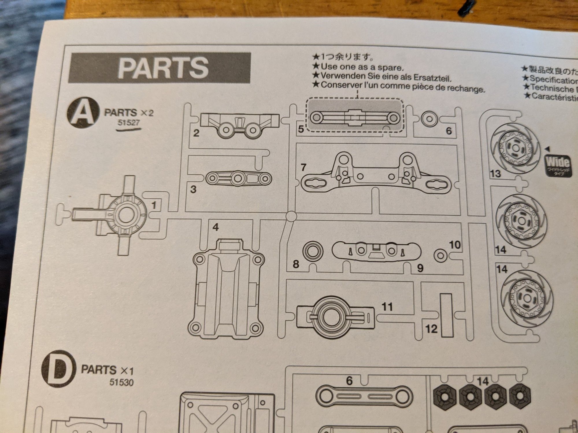

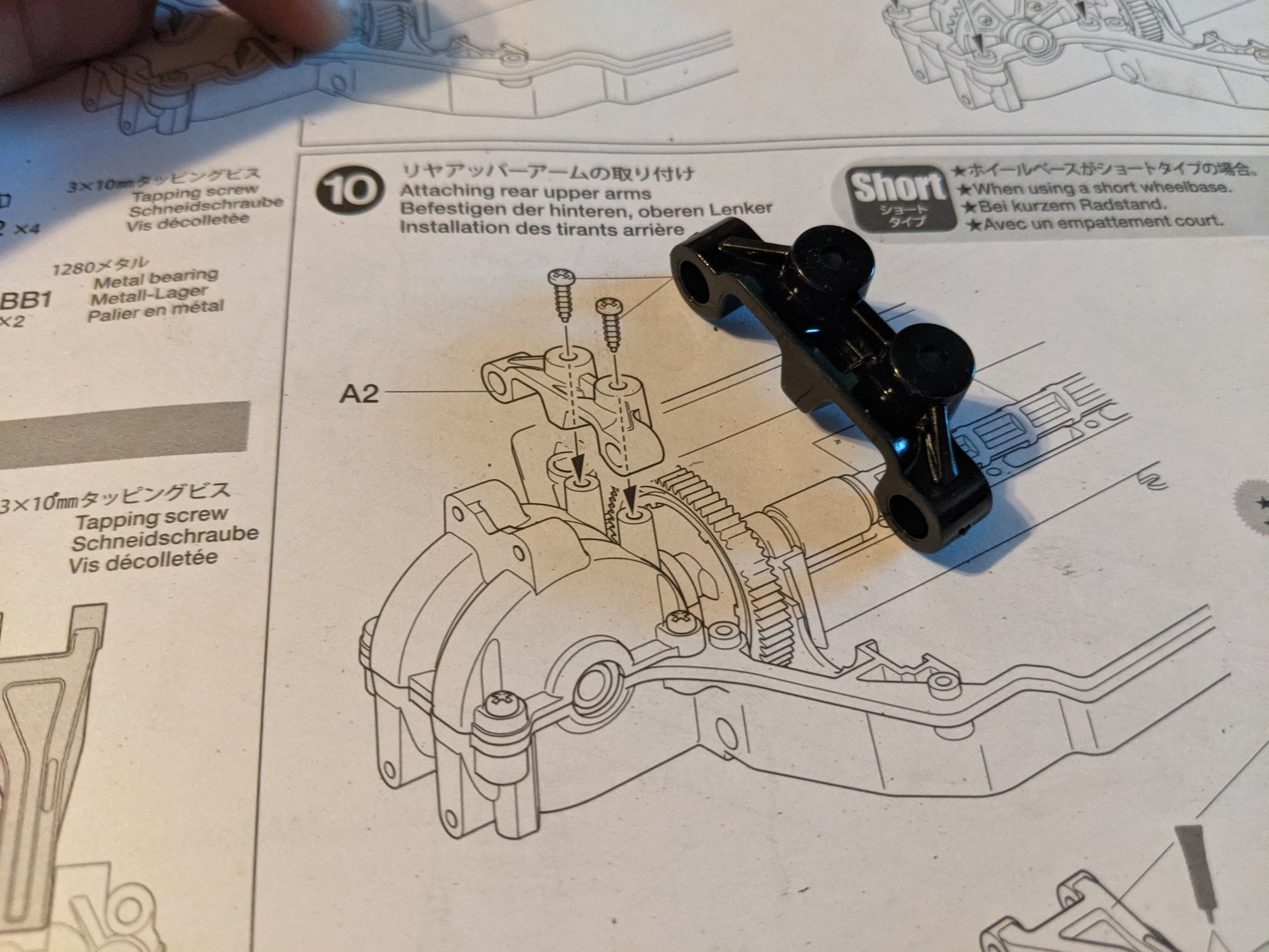

A parts tree is 51527. If you need A-2 I have a spare I could send you. If it's A-6 or A-10 I don't have spares of those, but you could use a properly sized washer for A-10, also for A-6 with some trimming.
