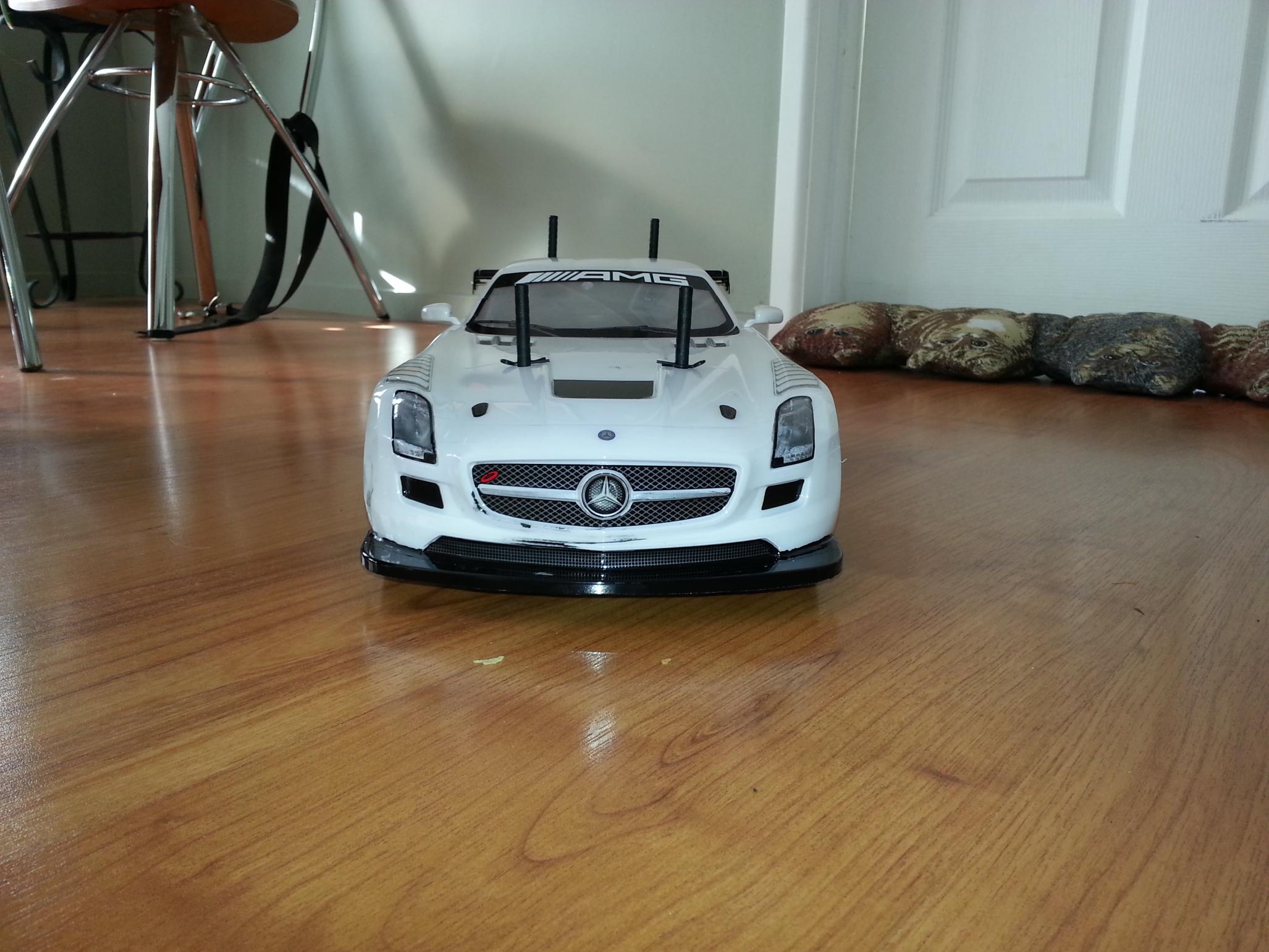

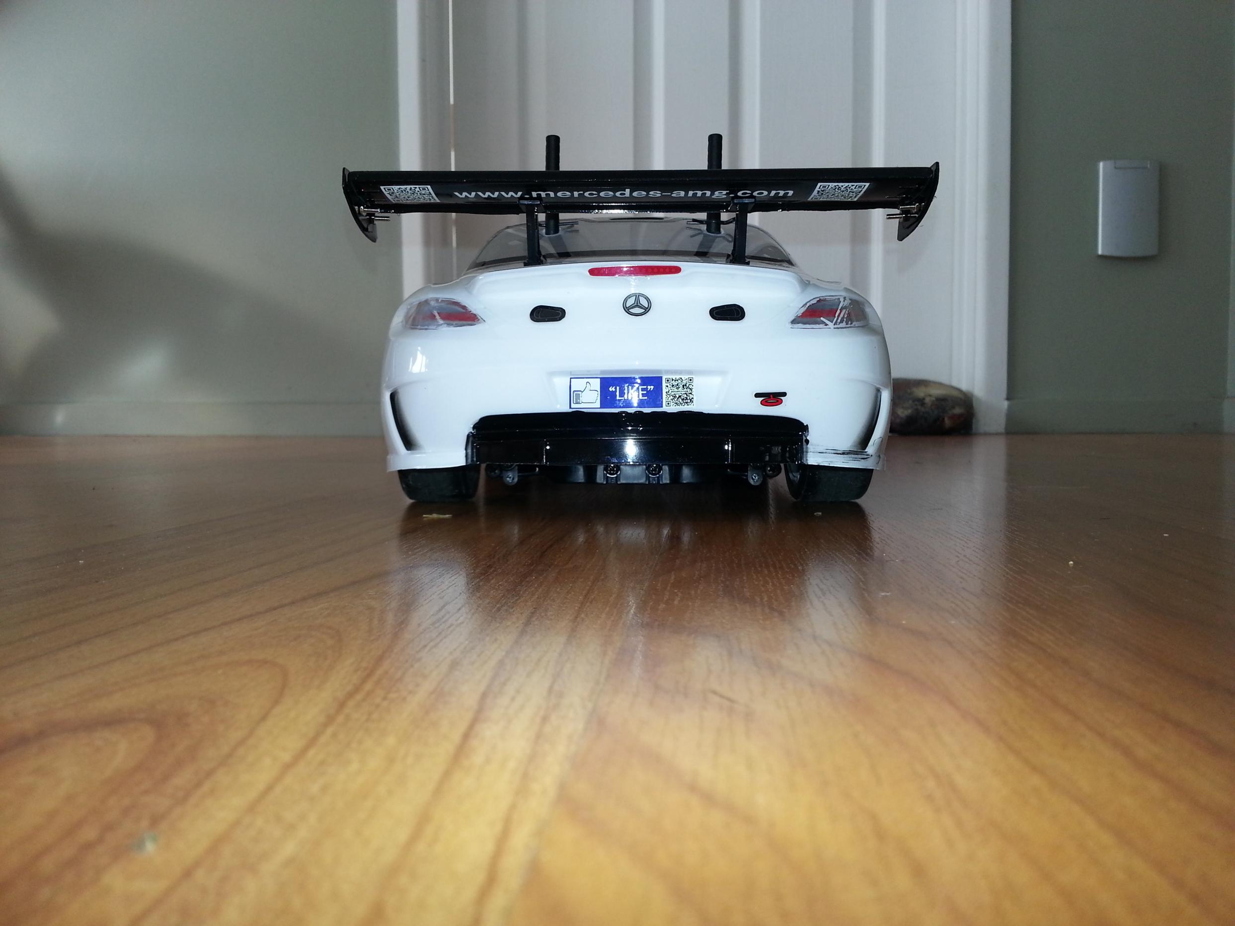

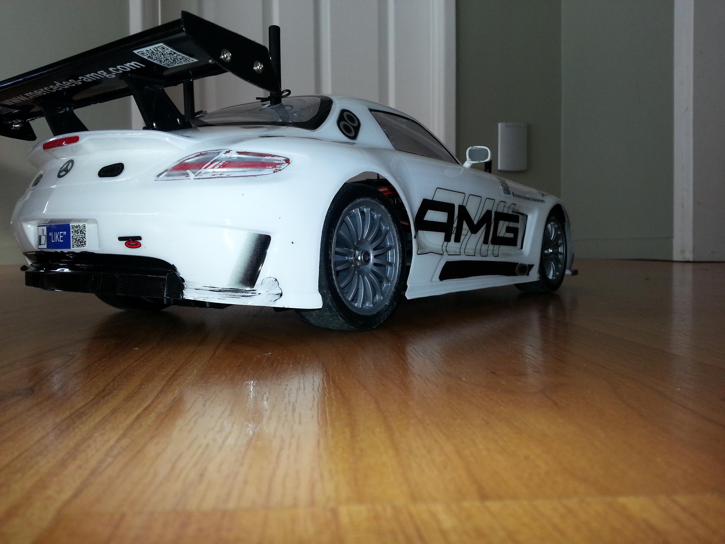

Hi I'm new here. I'm also a bit of a novice in the RC world.
So I just picked up a TT-02, built it and test drove it, I'm running it stock except for the motor/esc which is a 6000kv 5.5T motor and 60A esc, it seems to understeer ALOT, is this because of the standard friction shocks? or my driving

All cars with a 5.5 will under steer on power
Getting a nice set of adjustable shocks, with some soft (say 40wt front, 35wt rear oil). Tamiya blue springs front and yellow rear.
For more turn in move the front shocks to the inner holes if you don't already have them.
