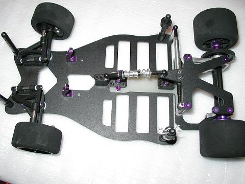

I just got my spashett ed switch blade:D :D Itis so cool,(better than i expected!!)The purple aluminum servo mounts screws, axle, etc looks great! i cant wait to get the turnbuckles and manual...by the way, does anyone have the parts numbers for the turnbucles...im going to call trinity for a manual tomorrow, and ask them what turnbukles i need( if u don't know:D )
Cant wait to get it up and running:nod: :nod: :nod:
Switch Blade 02-21-2003 04:30 PM
as i compared my car to some pictures...it seams that mine is different....i don't know exactly how to explain it but here it goes: On the front end, there are 2 plastic arms on the left and the right...The top one has a threaded rod conecting to i think the steering knuckle(don't know if thats what the part is) and the bottom arm is connected to a plate thats like a centemeter above the chassis...i am wondering what the name of my car is to get the right manual.....It seems that i only need 2 turnbucles so could i use rc12l3 turnbuckles??:confused:
Thanx
wheelmanST 02-21-2003 05:32 PM
Are you saying you have the associated style front end??? if you are then yes you can use the rc12l3 turnbuckles for the steering links. also i think the front end may have been different for the older models of the trinity car, the revolver. if i remember right it has two plastic arms like you described, but im not sure if it used turnbuckles or not. could you post a pic? i would be able to tell you when i see it
Switch Blade 02-21-2003 09:48 PM
Here see if this works...this is from the buy sell fourm...so if it doesn't work, look on either the 14, 15, or 16 page to find a pic.
http://www.rctech.net/forum/attachme...&postid=263166
I saw them at my LHS and tower has them for around 10, so if i could use them, it would save a little money:)
wheelmanST 02-21-2003 09:51 PM
yea thats a trinity revolver...the older model before the switchblade. if you are needing the turnbuckles that go to the servo saver for steering, the rc12l3 ones will work fine.
Switch Blade 02-21-2003 09:58 PM
thanks..that will save me a little money..now i just have to phone trinity about a manual for the revolver, and will be set...i noticed that a standard servo wont fit...o well mini servos arent too much:D the car looks as if it was just produced not an older model(after reading many race reports, it seems that the newest 1/12 isn't nessesary for winning...doesn't seem to be to much new tecnology...or has there:confused: :weird: )
