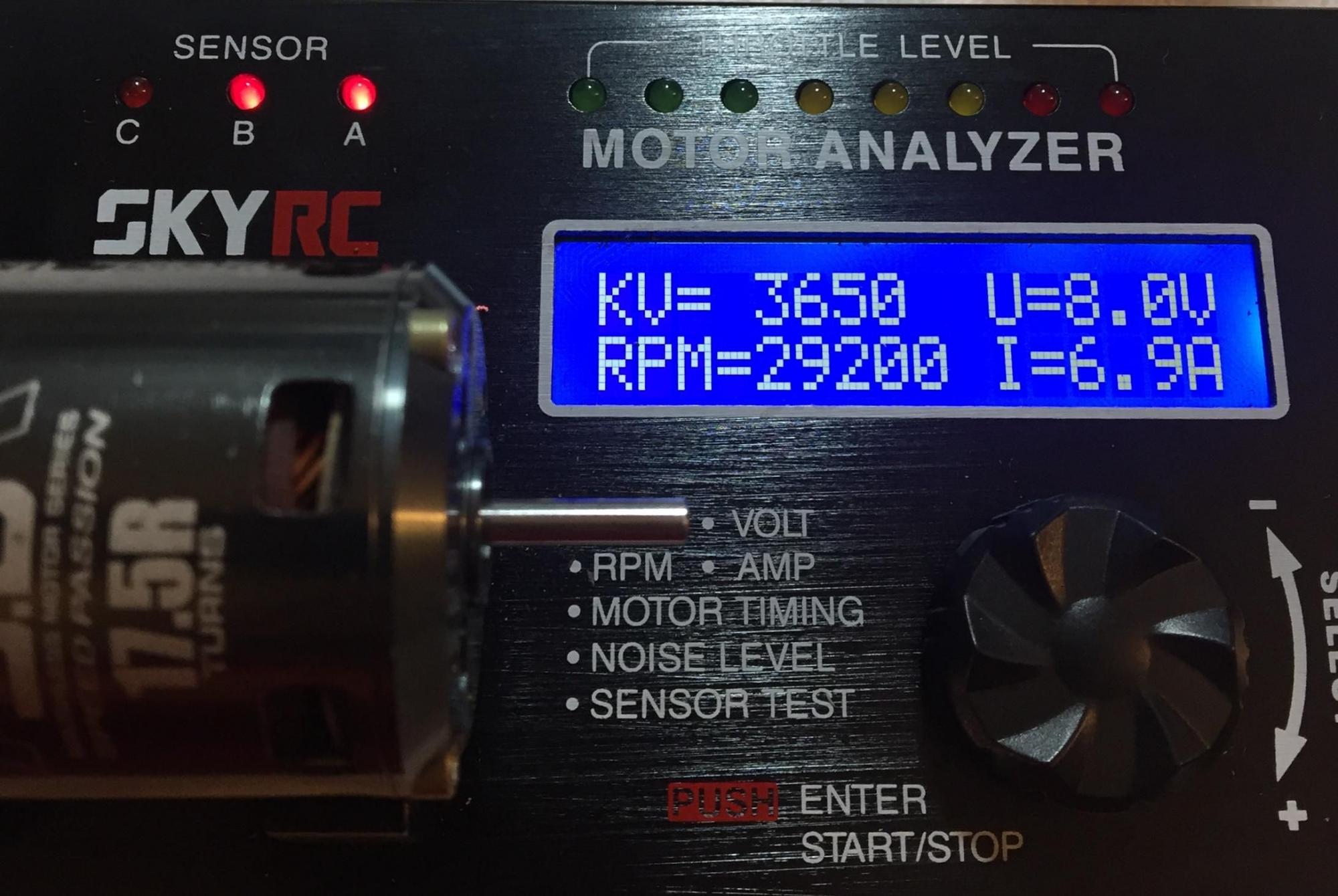

[QUOTE=Marcos.J;15030851]my 17.5MMM is set at 50degrees its has 3650kv, 29,200 rpm and its draw is 6.9 amps, i dont go by the amps different motors draw different , my mmm comes off the track about 145 degrees , and has no fade at the end on the run.
