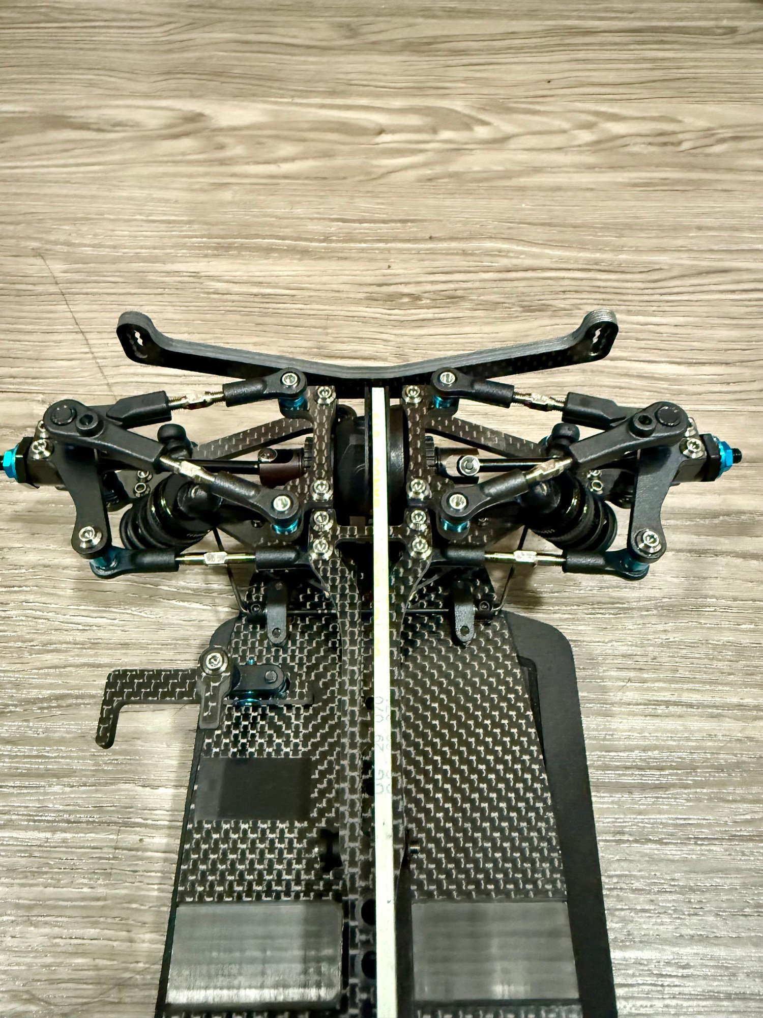

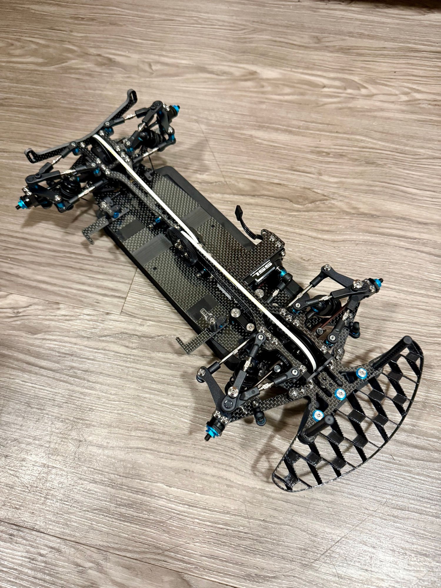

Finally completed. Enrico has some good building tips on his facebook page for those who are going to build one.

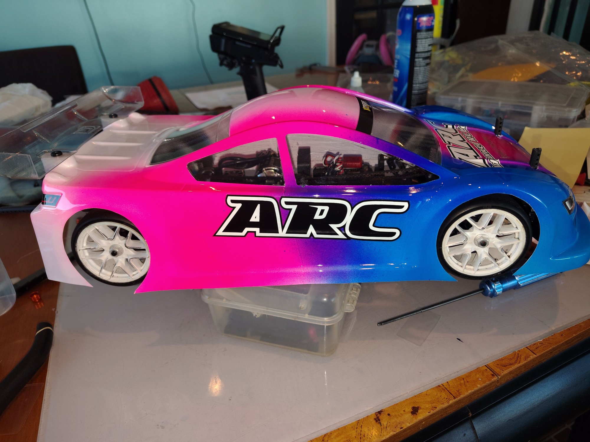

Just finished the build on mine. Went together well, not Xray quality but still very good.
I built the 1.5 alloy but had a few of the small headed screws missing in my kit and none seem to be available that I can find in the UK.
Any other cars use a similar small headed screws like this? Are the Amx 120 degree compatible?

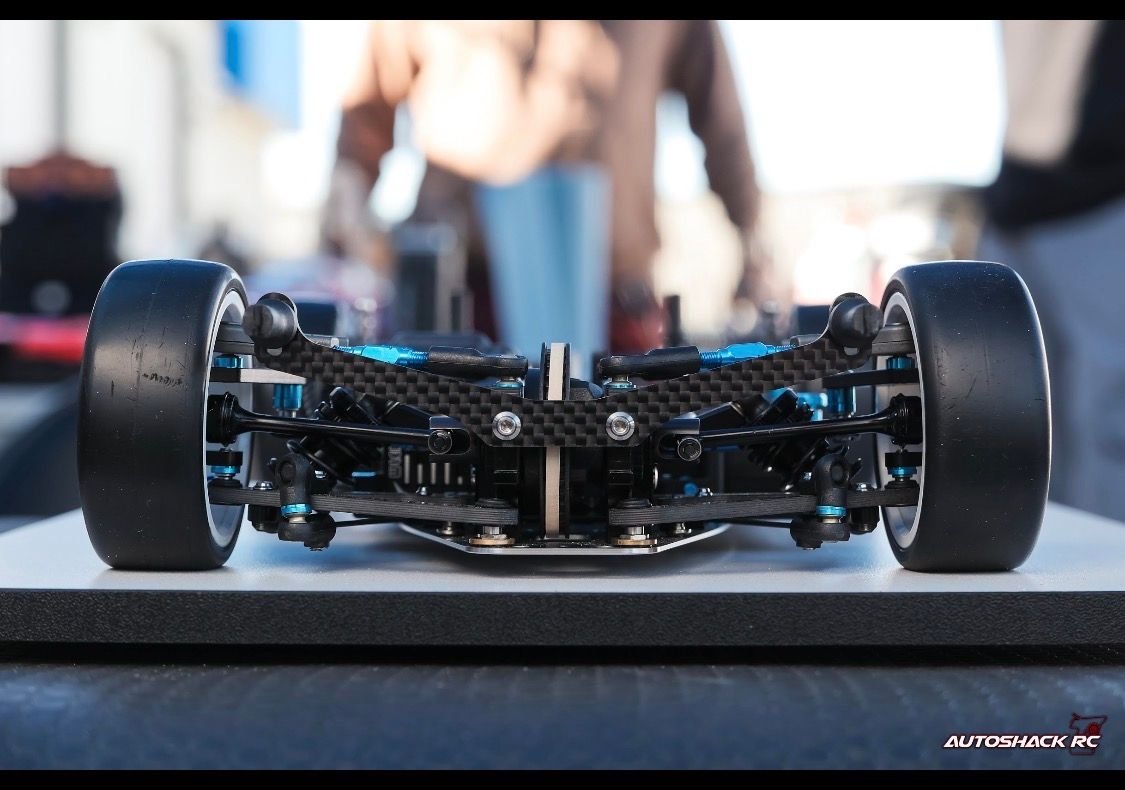

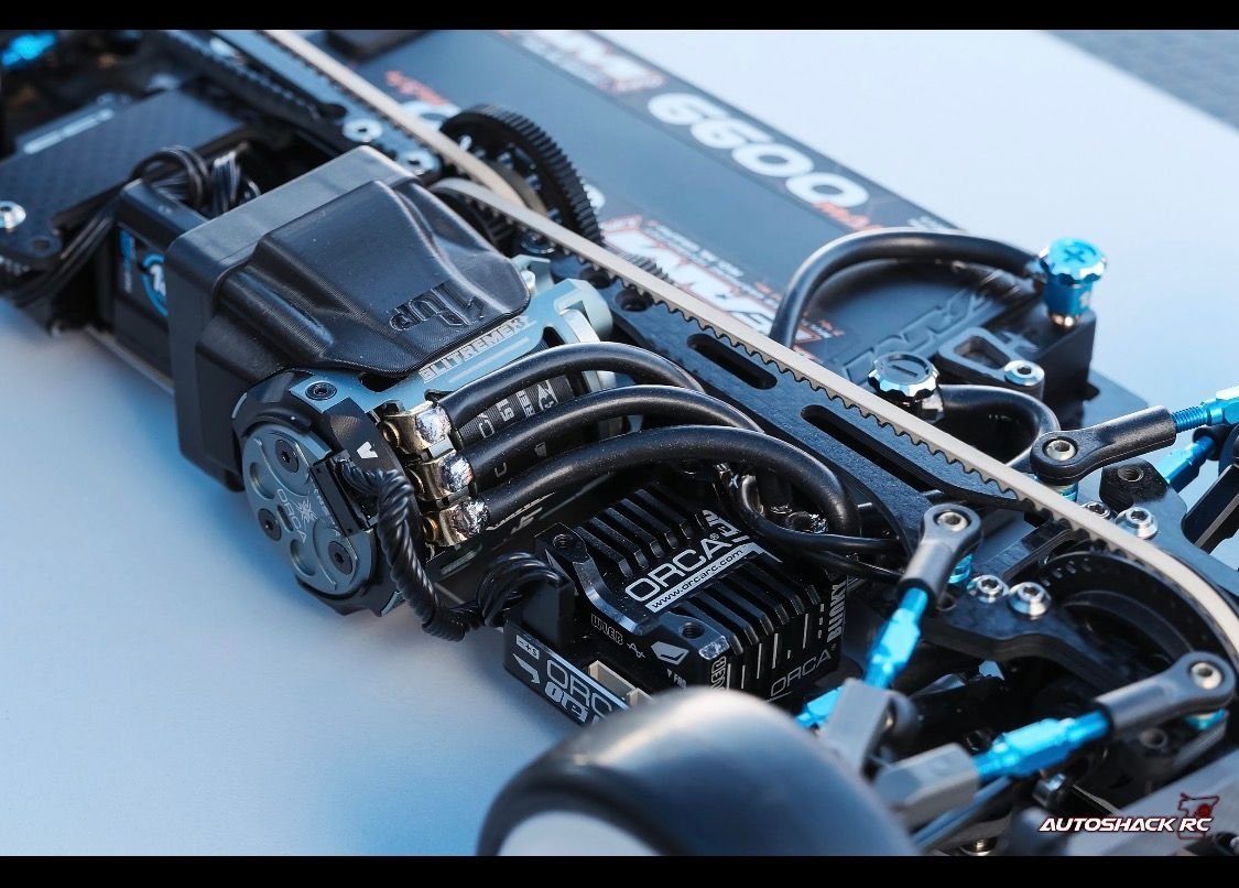

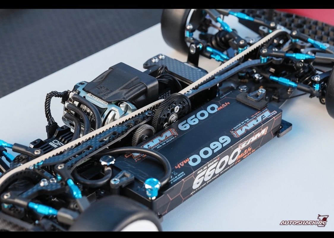

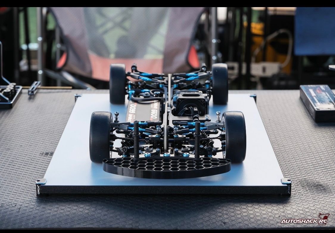

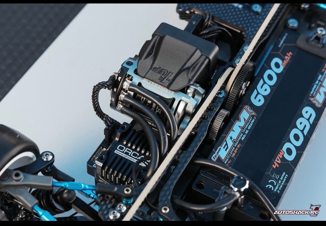

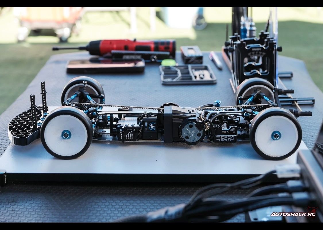

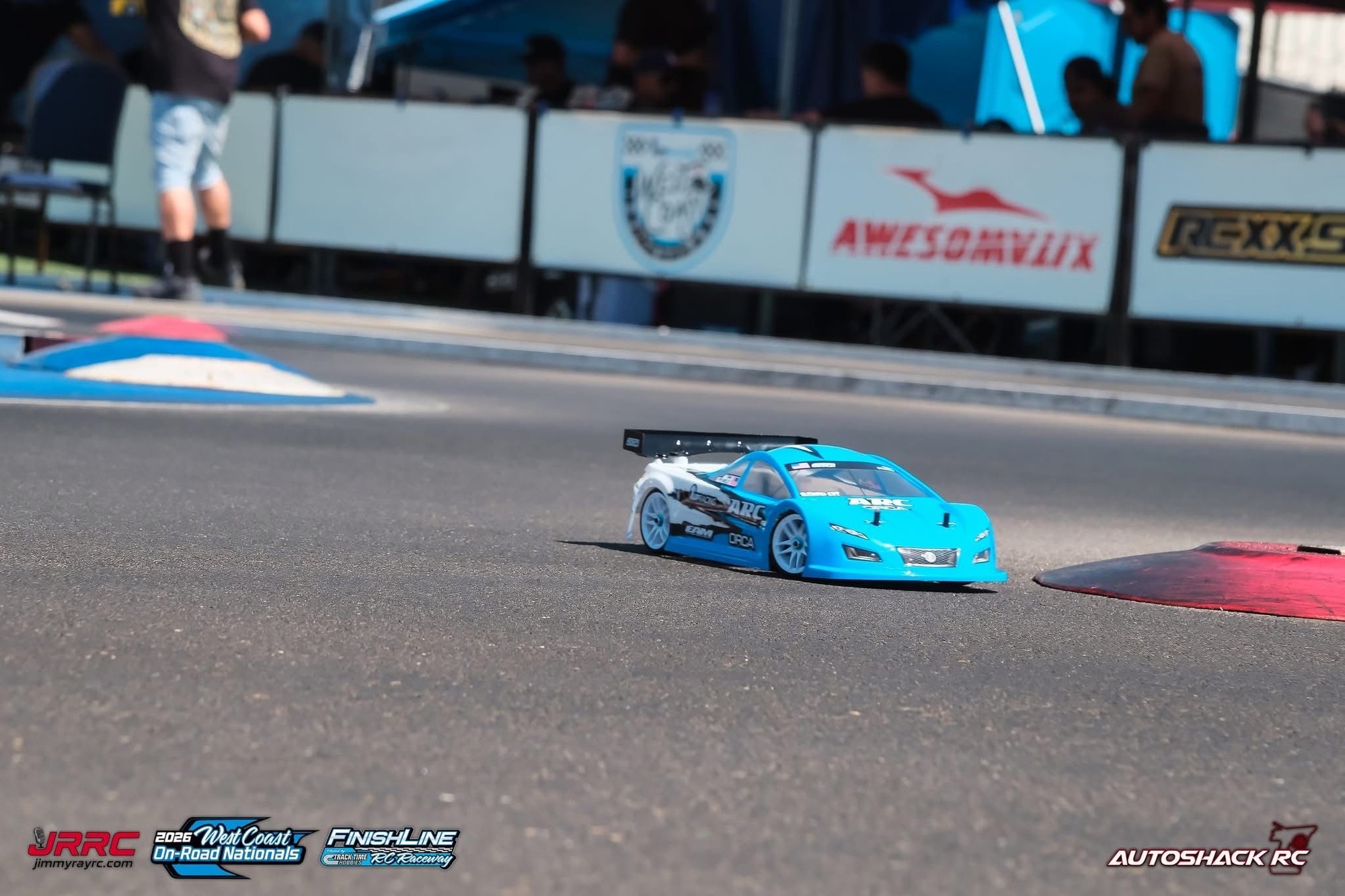

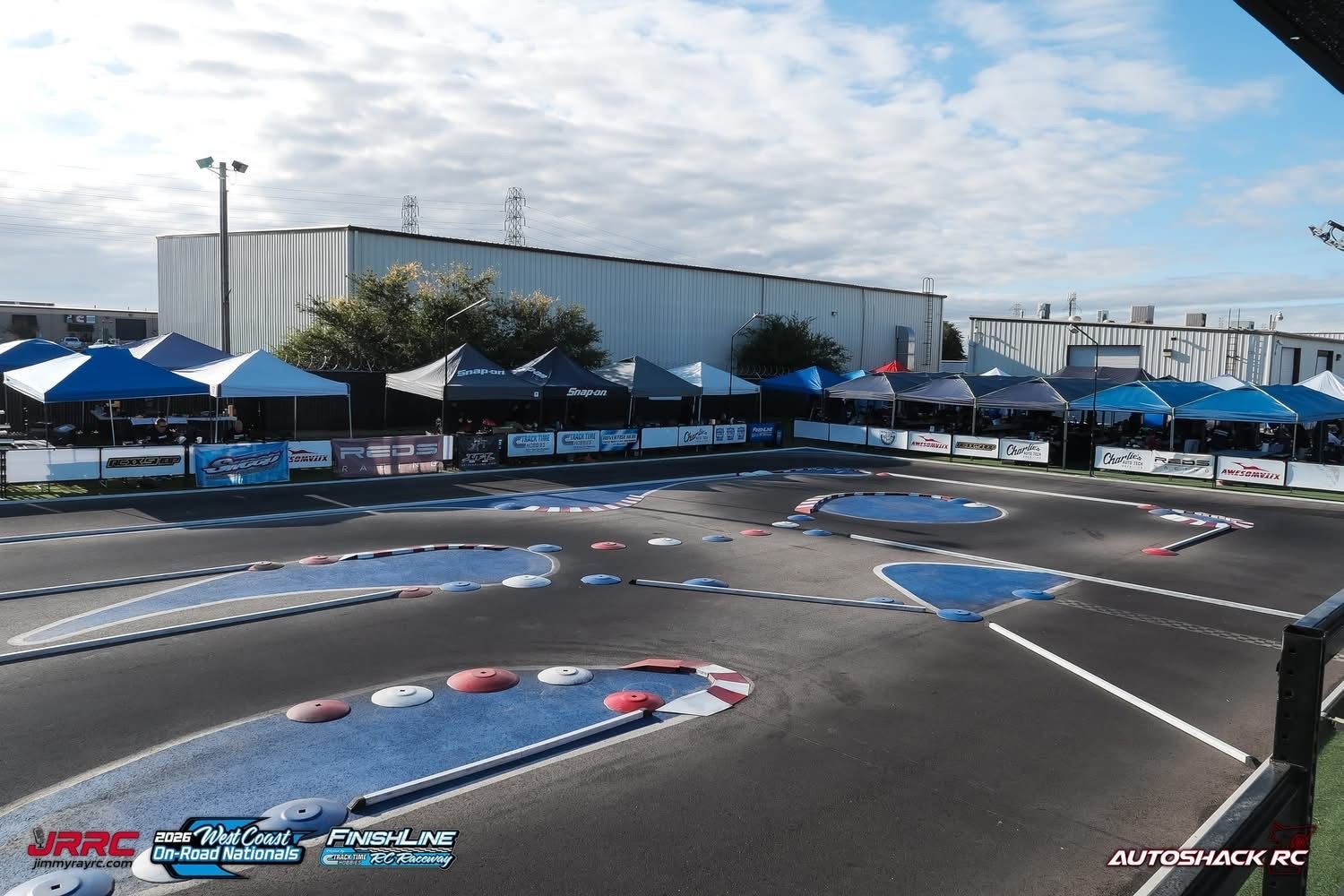

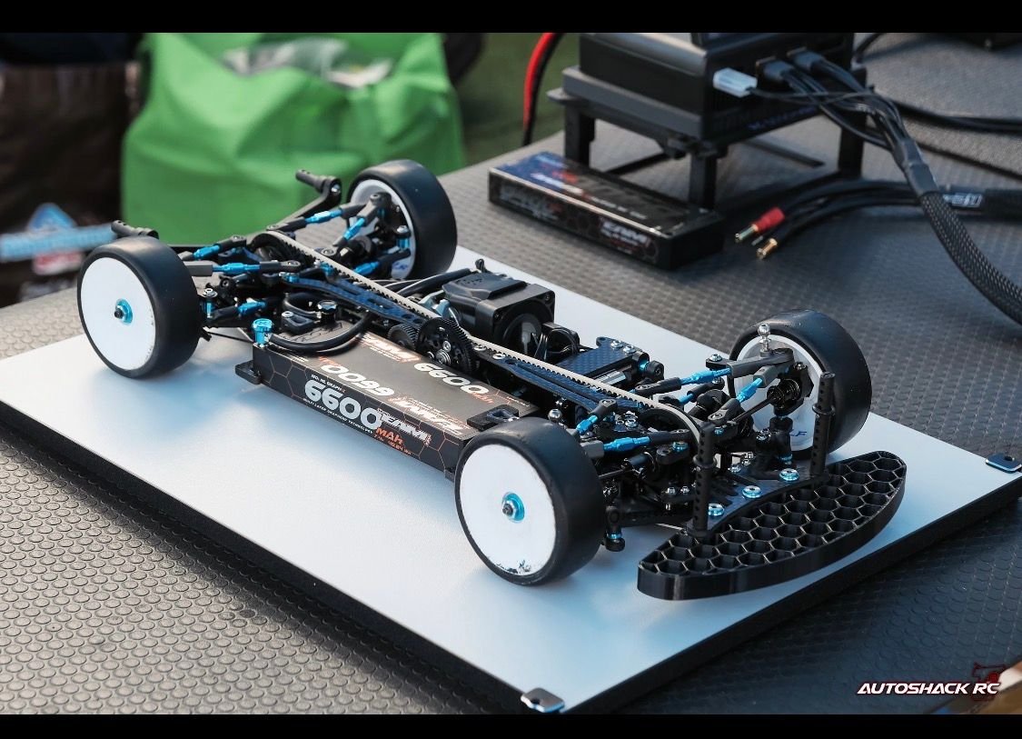

Lets get this forum moving. Heres a little photo dump of my A11 from this past weekends West coast nationals at Finishline raceway. I ran the factory steel 1.2mm chassis with short rear arms.

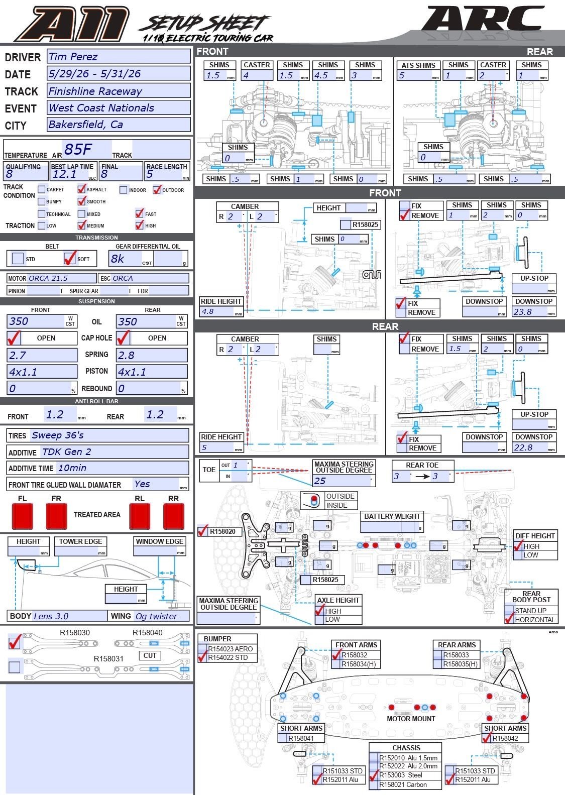

Also heres my set up from the weekend.

Nice post! what was your felt effect of short rear arms?

To me it felt like it rotated a lot better. I had the single piece top deck but it felt a little on the stable side, but once I swapped to spit top decks it made it rotate earlier and the flex was more noticeable like more direct.
