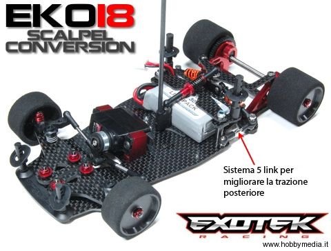

I have this chassis and before I move to another fwd platform I was trying to lighten it up as much as I could and was inspired by my 1/18 Scalpel to design the rear end like the front of it. Never got past the idea stage and just quick drawings but it may give you some idea.
