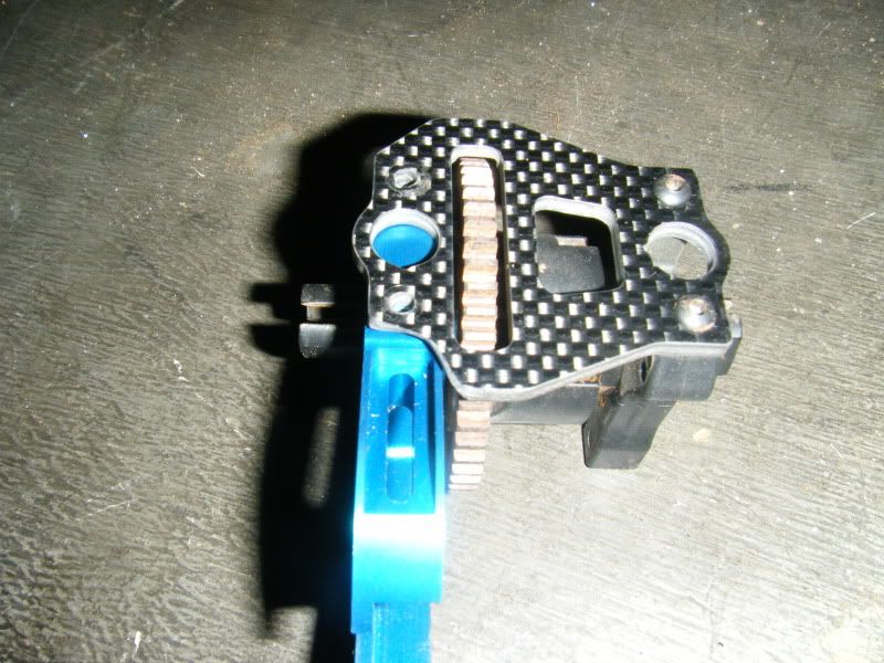

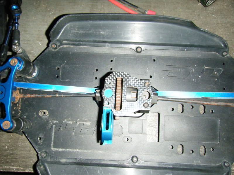

First thing I did was flip the diff around to check for clearence.

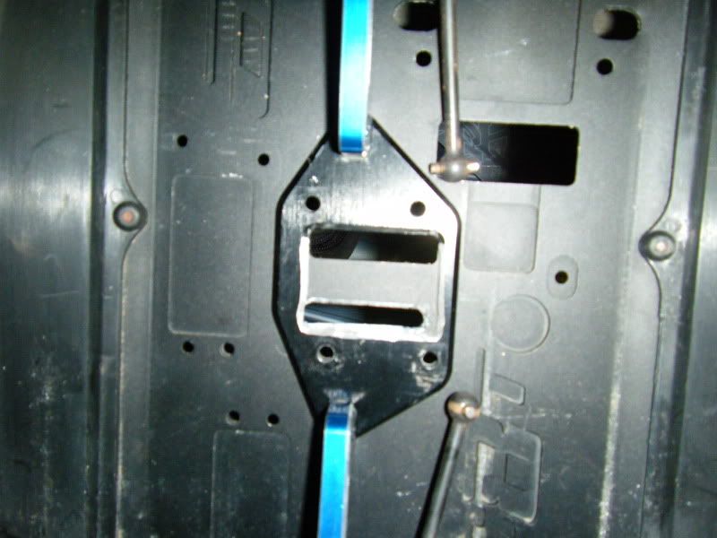

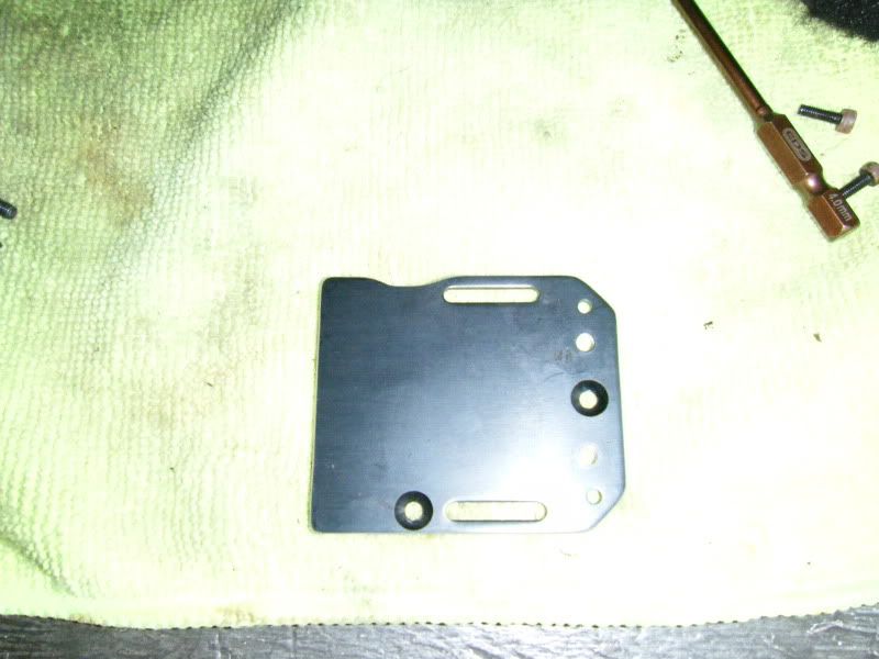

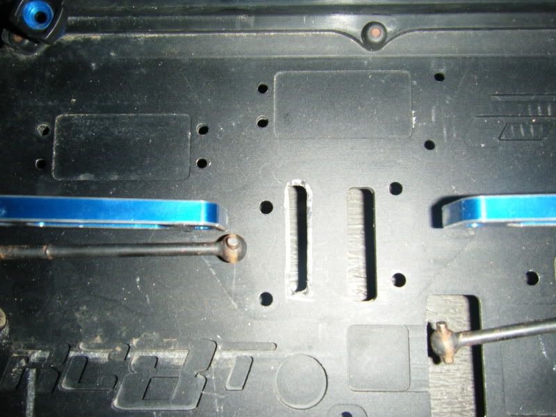

I tryed flipping the riser around too, but that ain't gonna work. So the diff riser & chassis needed clearencing. Unlike Brandon & some of you, I got no mill so I just used the trusty 'ol dremel & grinder.
First the riser.
Then the chassis.
That's done & the spur has all the clearence it needs.

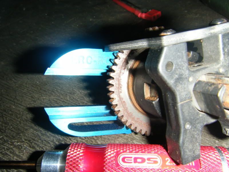

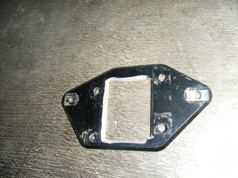

Ok, got the motor mount on. I don't know why but I had to do some trimming on the CF diff plate. You can see her how the mount rises up.
Here you can see how much I needed to remove to get it to sit flat.
I seen Ryan Maifield's & his didn't need this done. Anyone else wiith a AE mount need to do this?

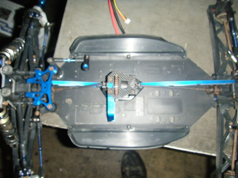

Got the Diff in & everything spins nice & freely.

Why did you grind the plate and chassis? Mine fits fine with the plate and elite mount???
trap121 is offline
Old 12-11-2009 | 08:00 AM
UK.hardcore's Avatar
Joined: Aug 2007
Posts: 2,315
From: Belgium.
His diff is in backwards.
UK.hardcore is offline
Old 12-11-2009 | 08:15 AM
gholt13's Avatar
Joined: Dec 2008
Posts: 234
he is putting the motor to the front
gholt13 is offline
Old 12-11-2009 | 10:49 AM
Joined: Oct 2009
Posts: 63
Yes, thanks guys.
