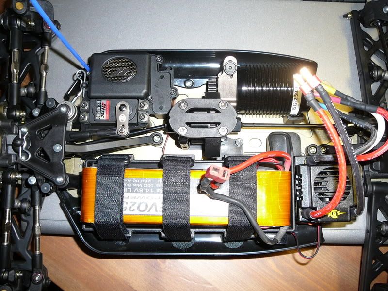

I just drove my Losi 8ight-E today for the first time and WOW...this thing has got tons of power! I still have to play around with the MMM ESC settings. I'm running a Neu 1512 2.5d/f 2050kv motor and a Flight Power 4S 5000mah Lipo. I'm also going to go down from a 15t pinion to 13t.
Here's a few pictures:
