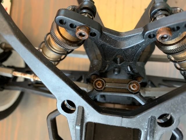

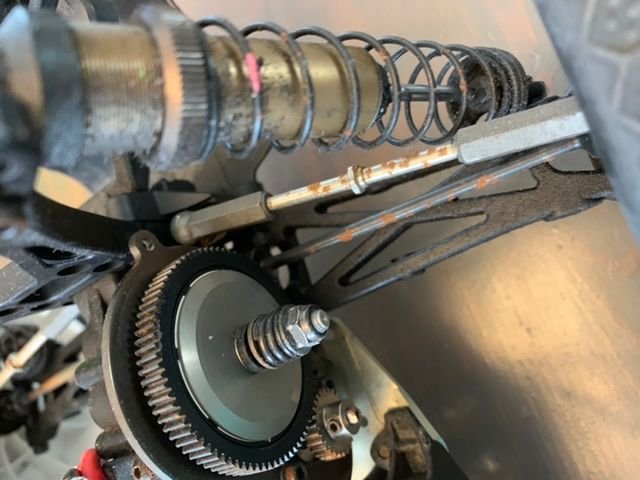

Hey guys, I have a Kyosho SC6 that needs some help. It was in good shape when I quit racing it a few years ago, but has been sitting in the shed and accumulated some surface rust on some small parts. The driveshafts, turnbuckles, some of the screws and bearings have some minor surface rust. I want to take this thing apart and make it like new again. What is the best way to clean surface rust off these parts? I don't want to spend a ton of money on new parts, but I will if I have to.

Turned out to be much simpler then I thought it would be. I backed the screws half way out, sprayed them with liquid wrench and scrubbed. I used a drill and metal polish with a Brillo pad on the turnbuckles, shock shafts and driveshafts. I then took it apart, cleaned everything with simple green and silicone lubricant. I replaced a couple bearings, rebuilt the diff and new shock o rings. It really does look like new again. Iíll post a pic a bit later.
