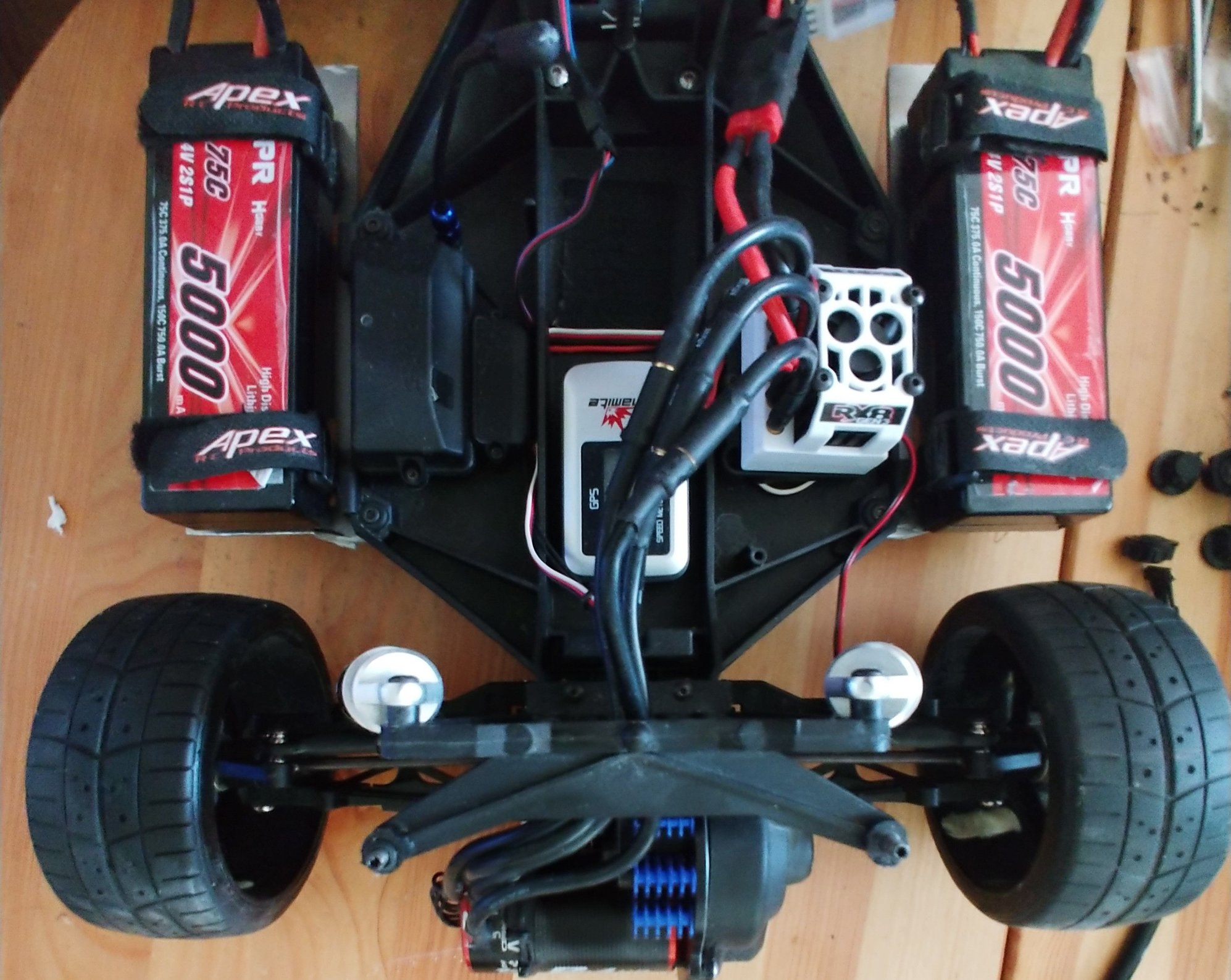

I have a question about Rear Toe-in.
What's a general good starting spot? I'm building a slash conversion with the TRX-272R trans and it has almost 3deg rear toe-in with the Bandit rear arms I'm using. Does this seem like too much? Most of the build pics from an eyeball look like 1deg~ish
I see a couple of options out there from STRC to reduce the rear toe from the stock 3deg to around 1deg but it's not adjustable (and Alum). Pemberton RaceWorks has "The Final Answer - BANDIT Edition" adjustable rear arms, but they are 70$ (and out of stock). another option is from CW racing as well for adjustable arms. If I can use static arms it'll be less of a hit to replace when the car eventually takes a hit (haha..) and I typically stay away from aluminum parts when I can.
Also out of curiosity does anyone know the stock slash arm length (2555) vs. drag slash arms (2750A) vs. bandit arms (2750R)?
Looking to let my fingers do the walking before I order a bunch of parts I might not need. (I'm also running the PL Reaction+ which is the main reason I'm not suing the stock slash arms, they are too long to tuck nicely under the body when the suspension is compressed).
Thanks!
