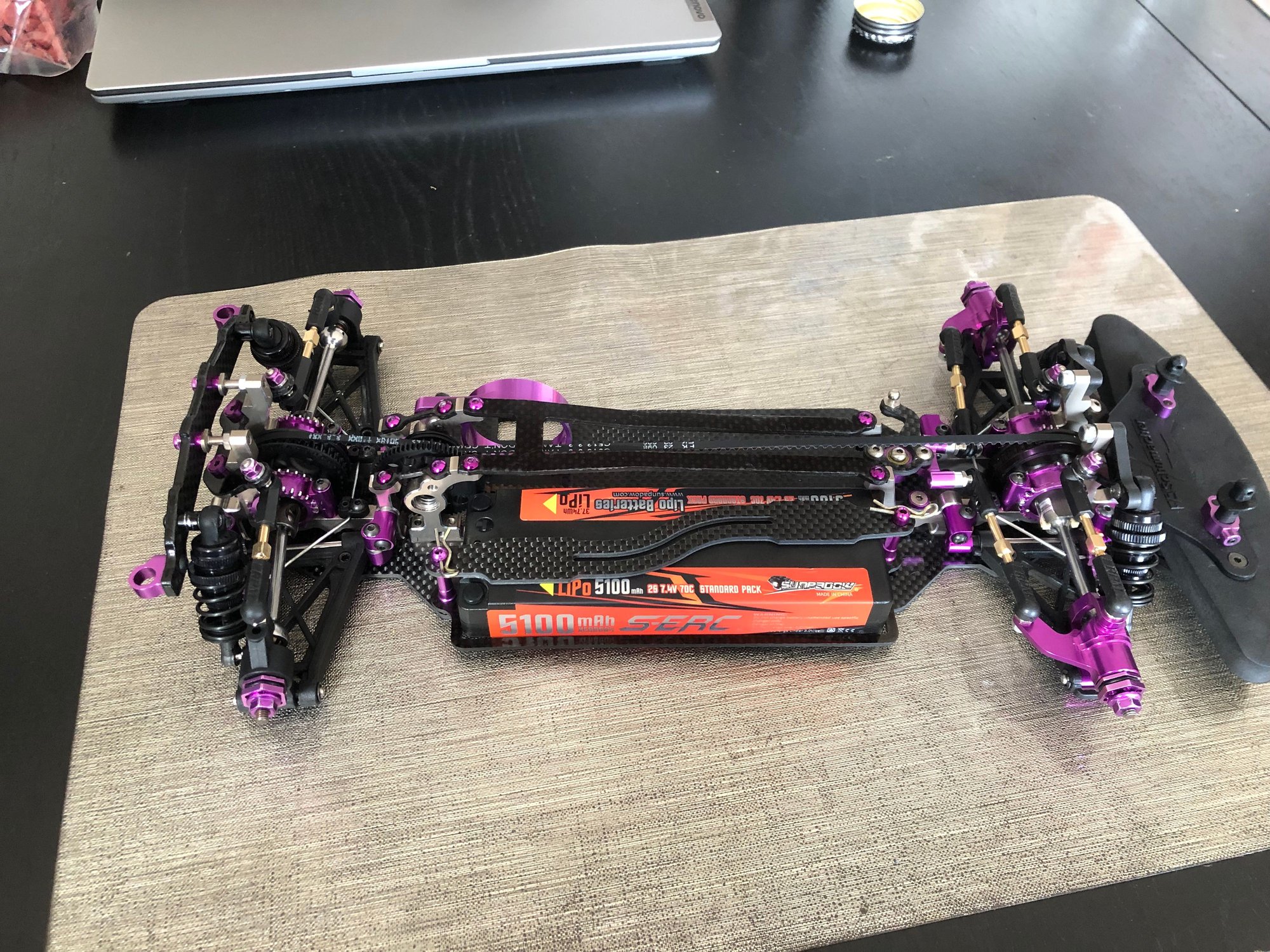

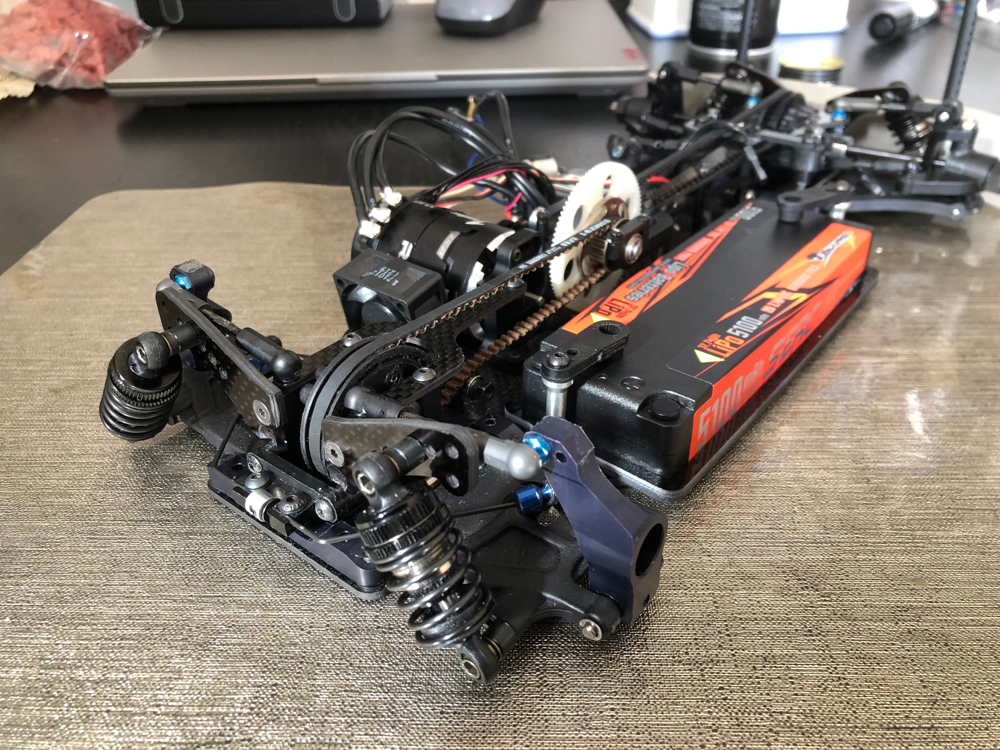

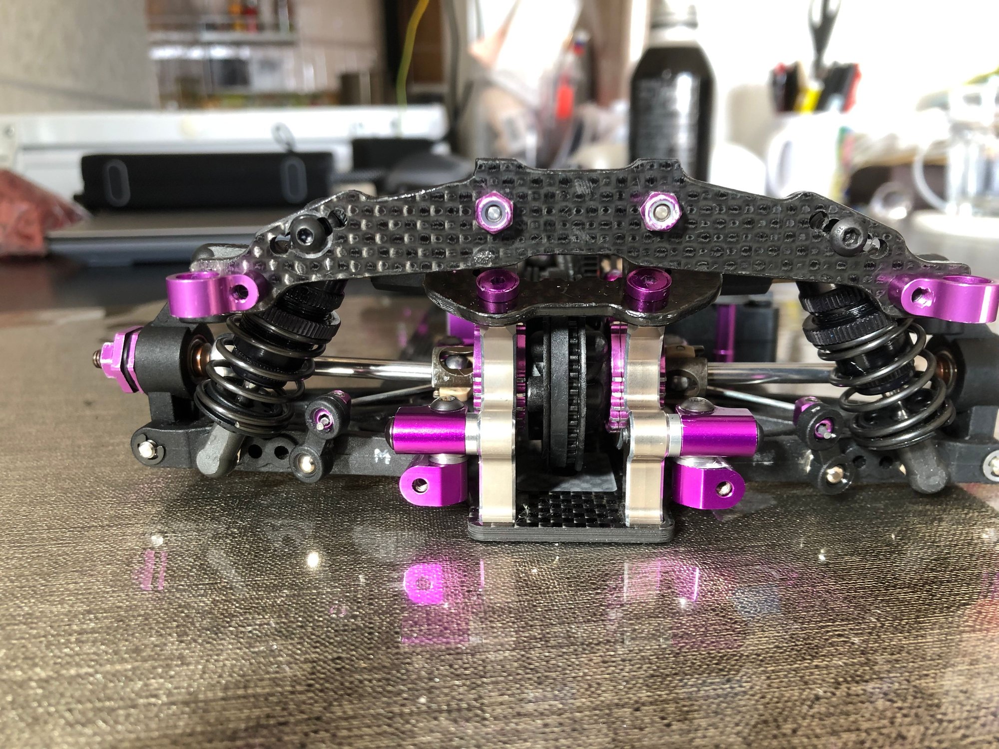

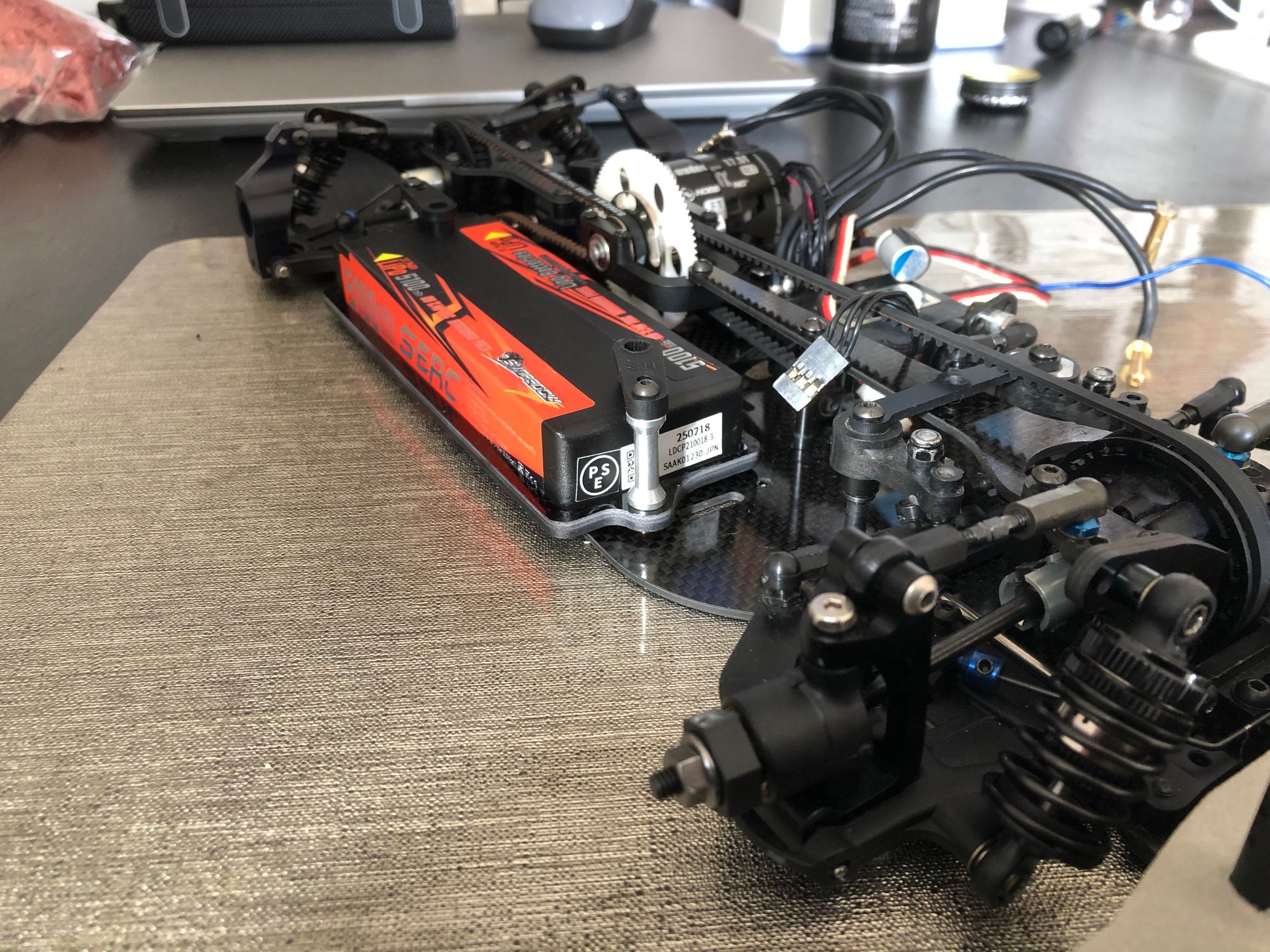

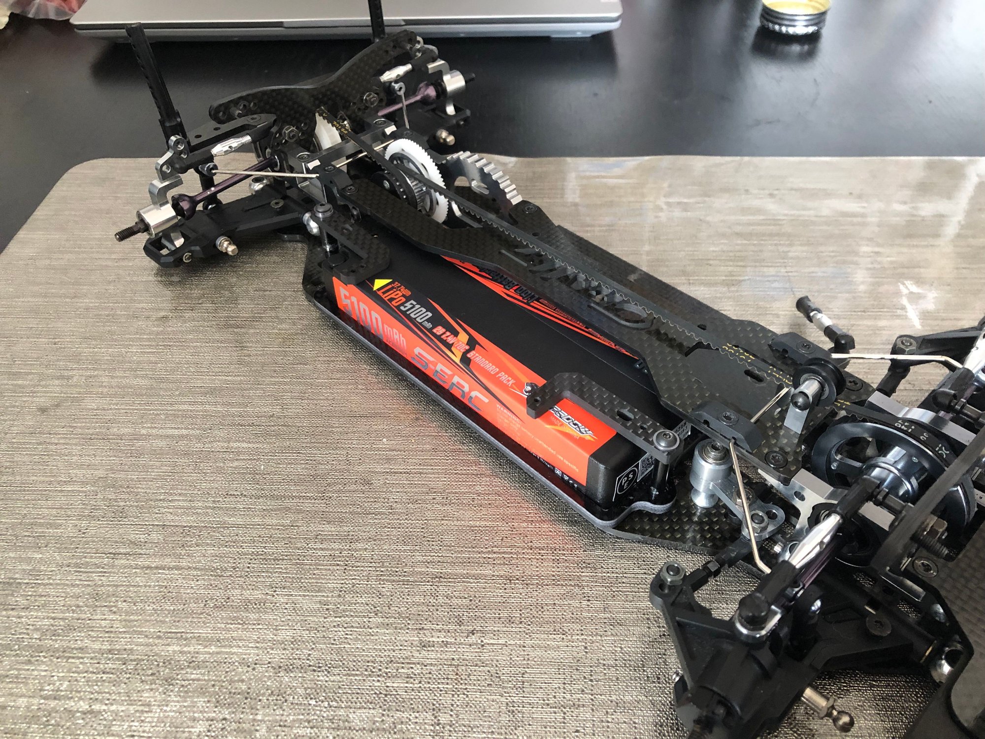

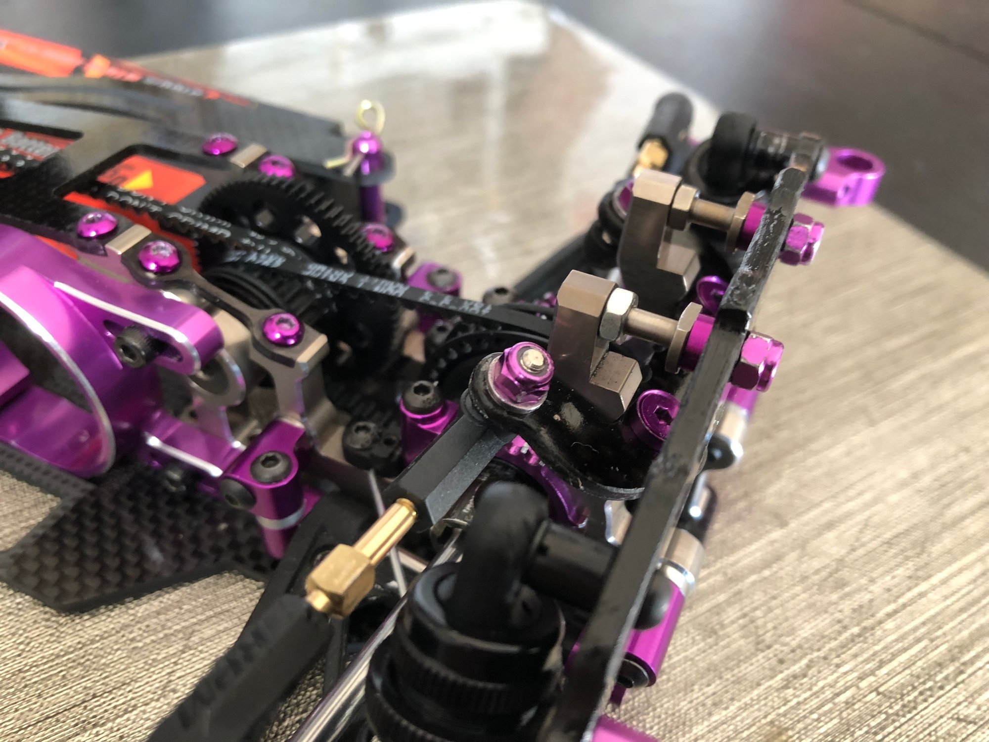

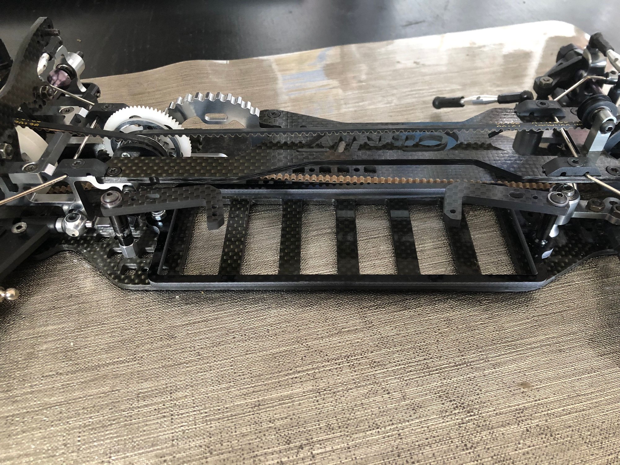

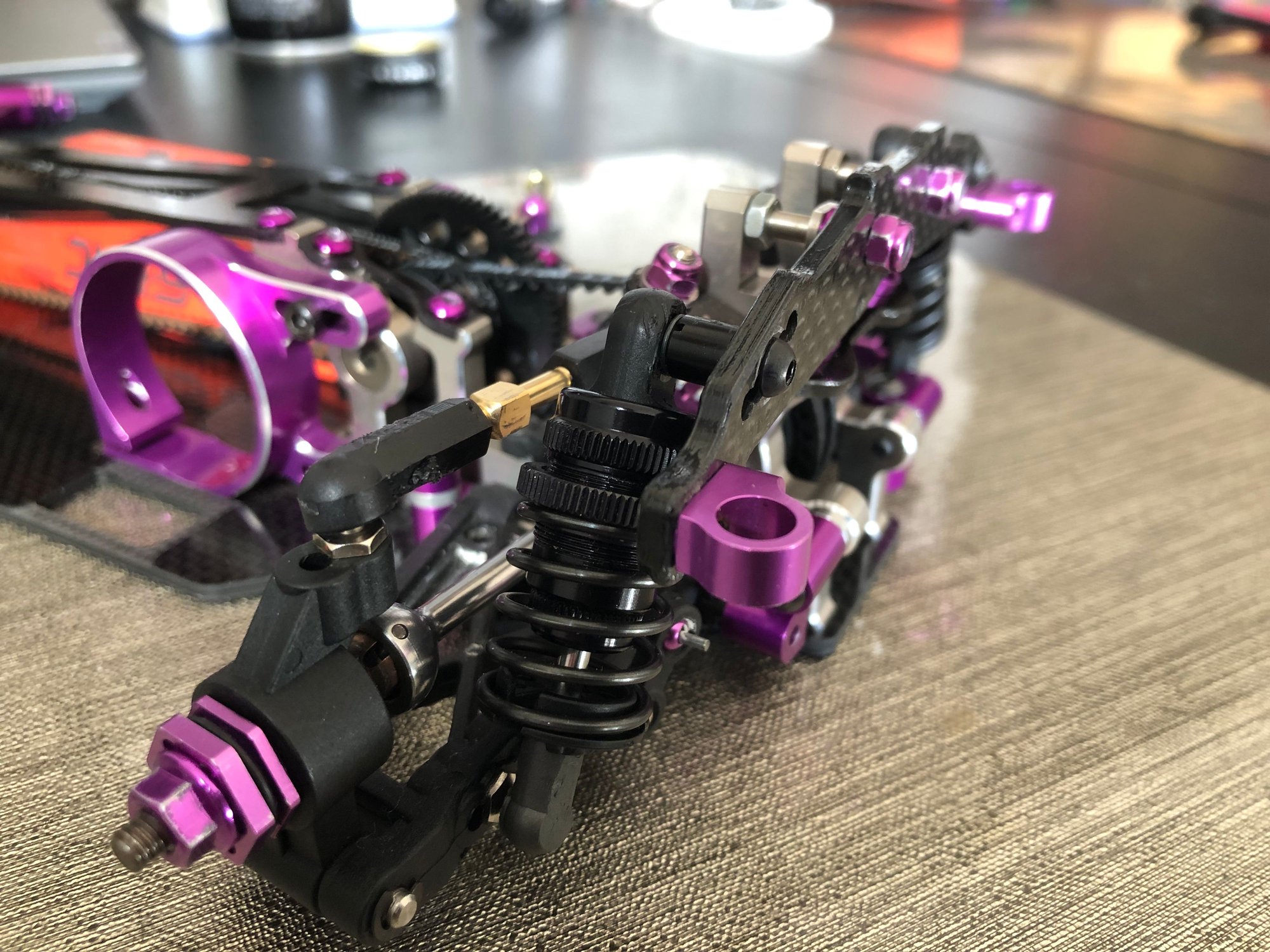

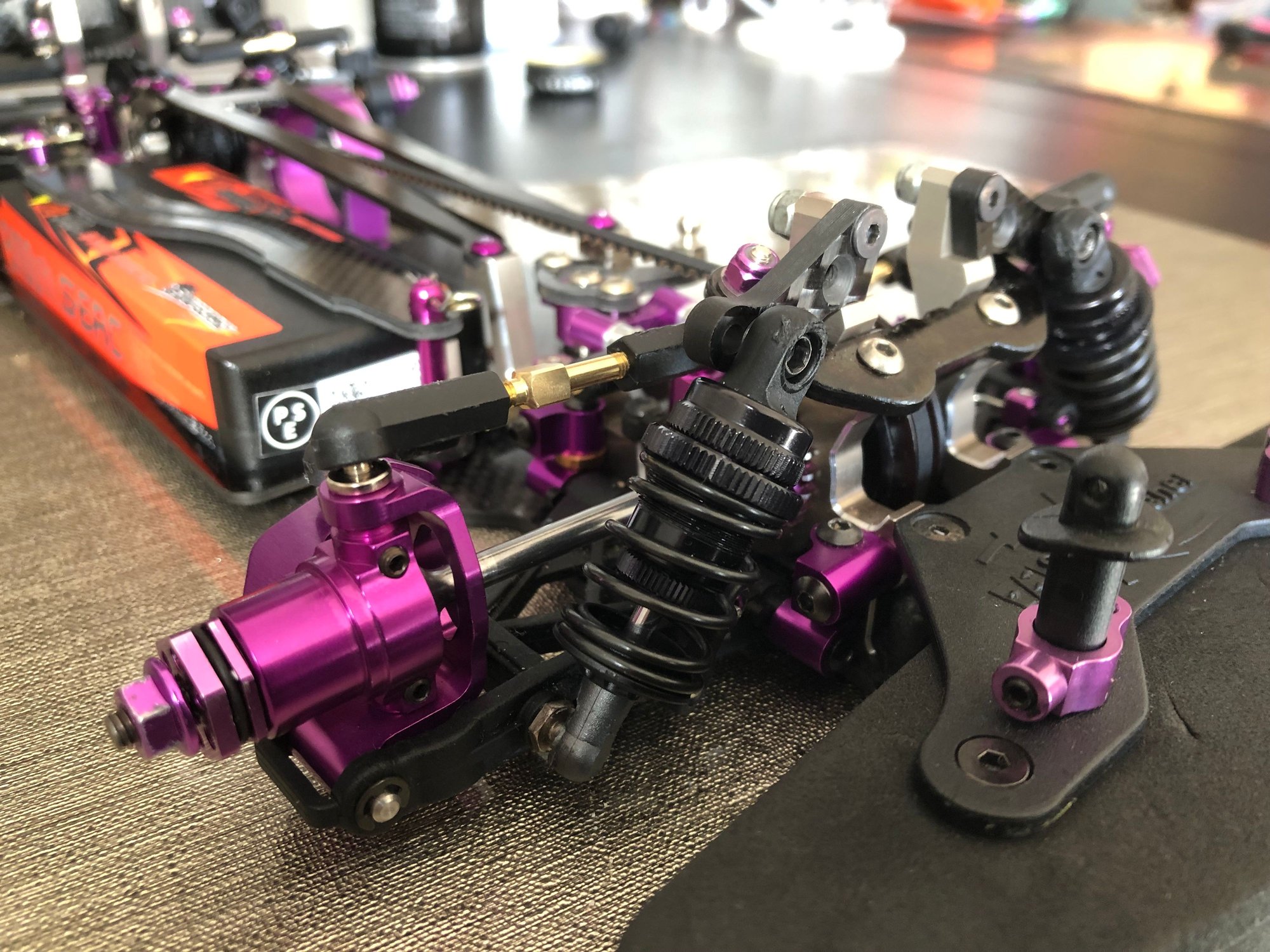

Here are some other projects I’ve been working on.
Corally RDX almost ready to hit the track.
Corally RDX
OVA T4
OVA T4
Schumacher Mi4 flipped tower for LCG shocks
Schumacher Mi4 front tower using LCG shocks
Schumacher Mi4 mounting setup.
Looking forward to trying this chassis out.
Corally RDX
OVA T4
OVA T4

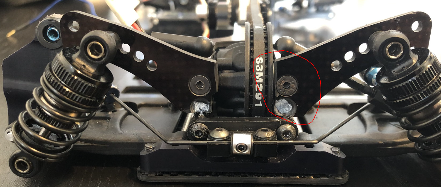

Those are some really good adaptions, getting it down low.
In the snip from your bulkhead photos, the circled area is a possible issue where any rotation of the arm would cause rubbing on the rotating diff.
While the original two screws are too big to use, can you tap in a small screw or even a pin to lock the arm in position? Accidents happen all the time!
