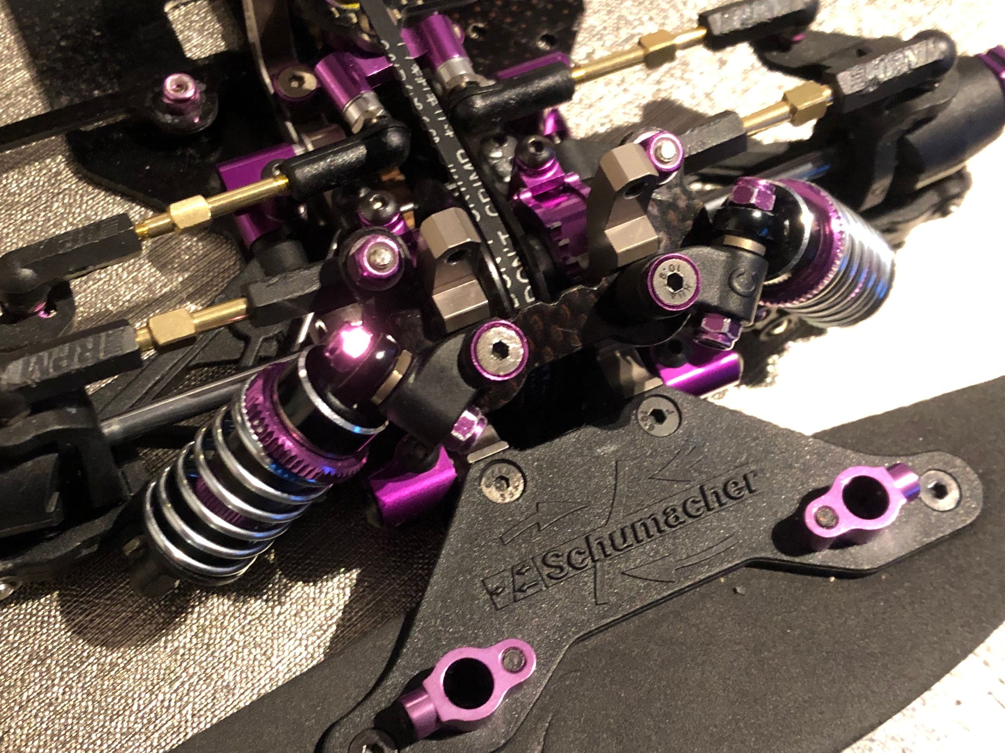

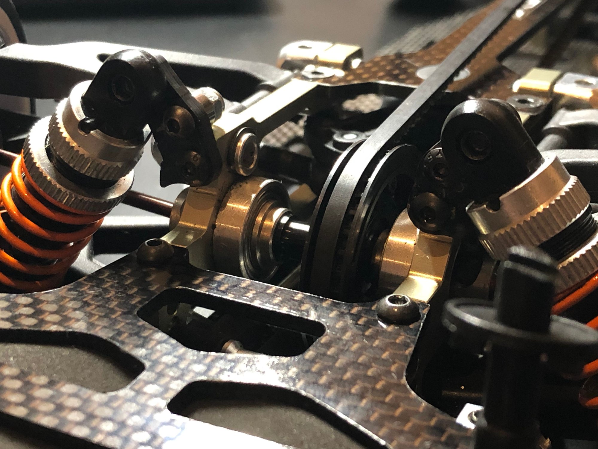

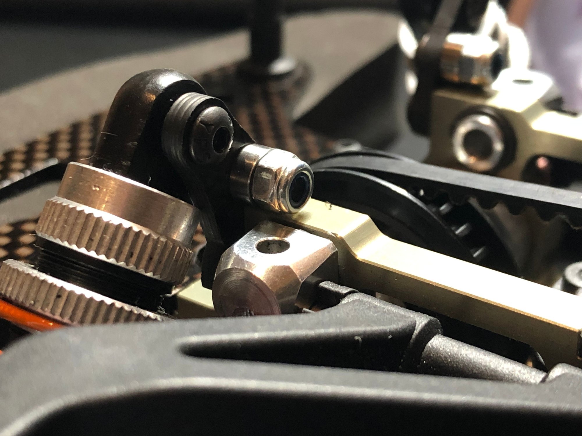

An old Schumacher Mi4 has a new lease of life with an updated front suspension setup. I went this route because the Mi4 front carbon shock tower was too tall and wouldn't allow for HD bodies to rest on the body posts properly. Now this new setup allows for
HD bodies to be mounted without any issues and luckily for me all the parts are used from the Mi4 and required no fabricating or grinding of any materials.

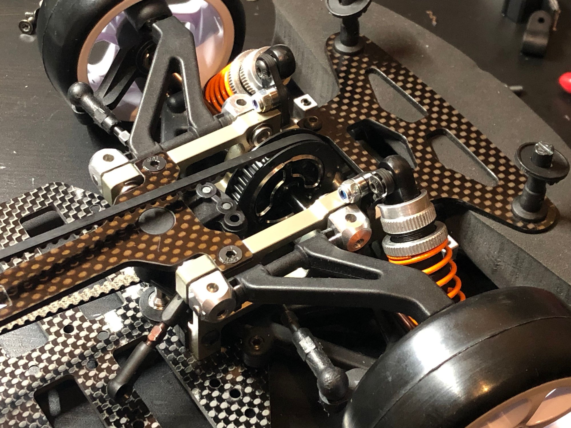

Project OVA T4 is ready for testing.

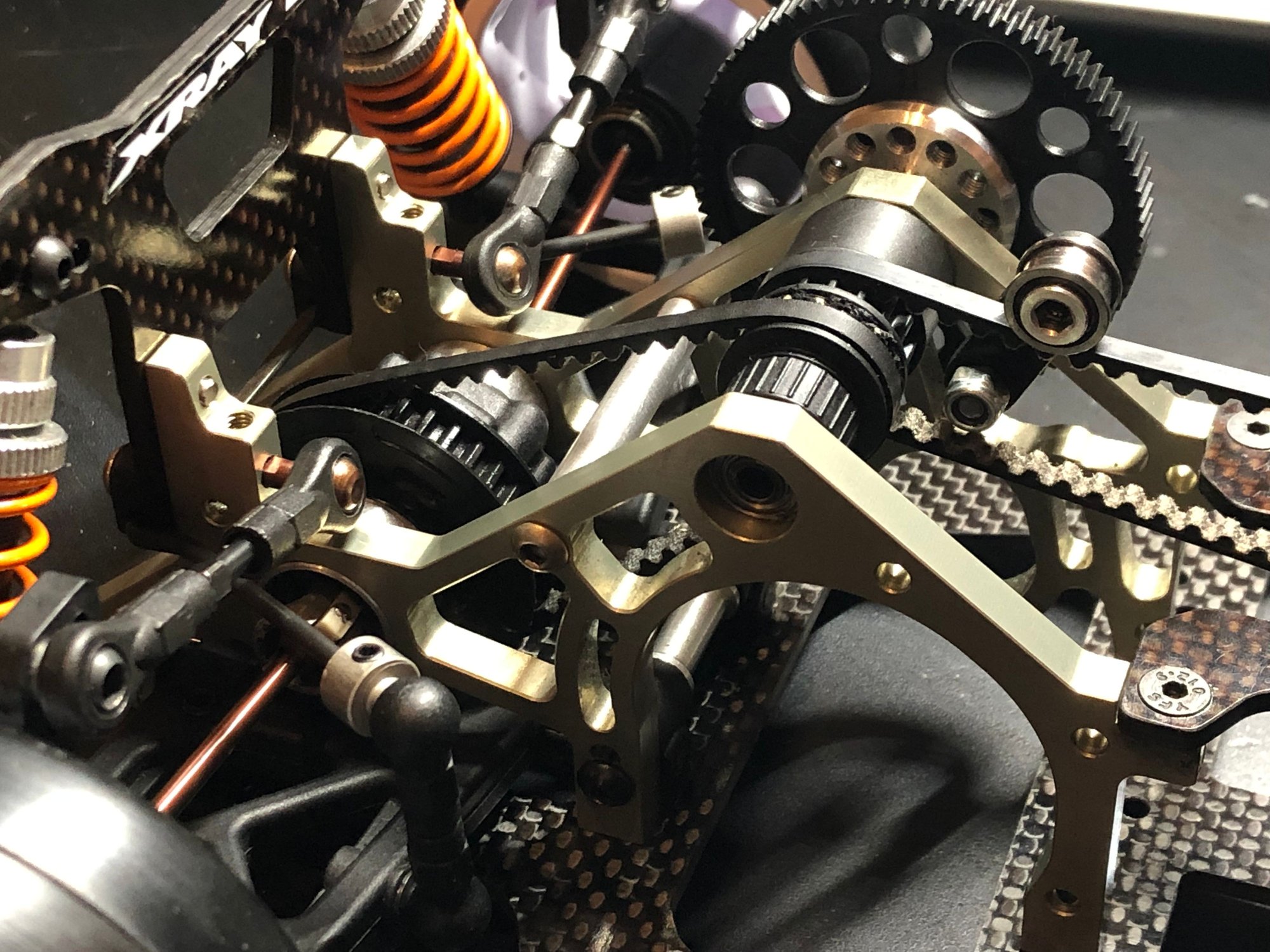

First shakedown of our TA05 with the inboard rear shock modification. It works really well and hopefully this gives our old TA05 a little more speed to defend its 21.5T blinky title.

Originally Posted by rccartips View Post
Tamiya TA05 with inboard shock modification wins our Modified Class.
that car has reversible arms. Why not just reverse the rear arms for the same affect?
congrats on the win
GuyIsDamGood likes this.
Juan Aveytia is offline
Old 05-01-2022, 02:52 AM
  #1392
Join Date: Jun 2003
Posts: 4,443
congrats on the win
Wanted to put the shock weight between the wheels. Was too lazy to reverse and just put the shocks where the sway bar went. It handled well and just kept it that way

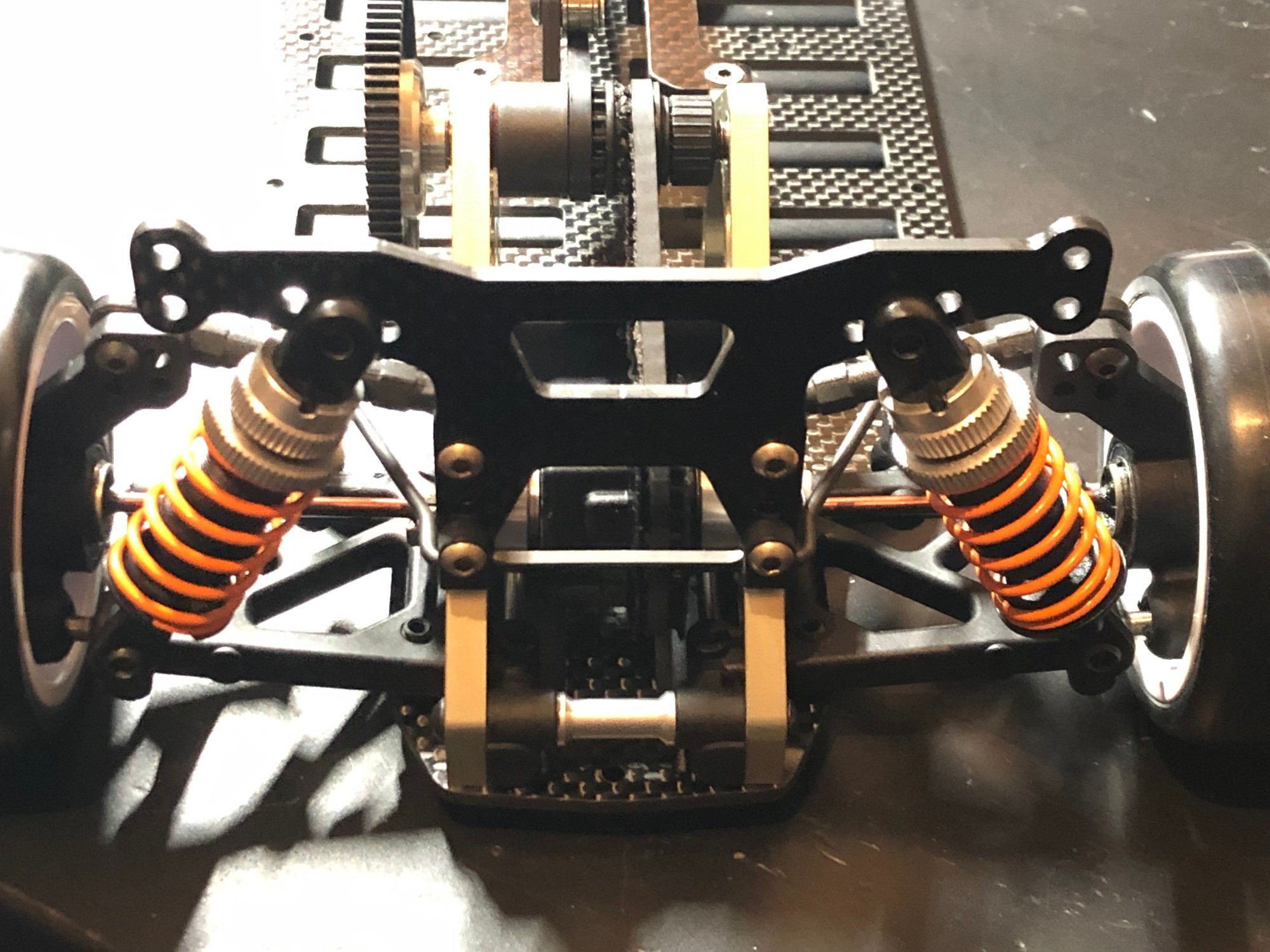

Thanks Lonestar,
I've been working on this chassis for the past year adding and changing bits and pieces. There are few things I would like to add to the chassis such as battery holder system, ball cups, turnbuckles and a nice bumper.
I really enjoy tinkering around with these vintage chassis bring them up to current performance levels and allow for newer body shells to be used.
Went back to the original dampers because it looked out of place with anything else.
I did manage to lower the front towers with some carbon pieces laying around. The damper angles are not far off from the stock damper tower. Those are bearings behind the locknut to accurately locate the shock towers since there is only one screw mounting hole.
Rear tower os still original
Flipped the transmission so ESC wiring will be cleaner.
