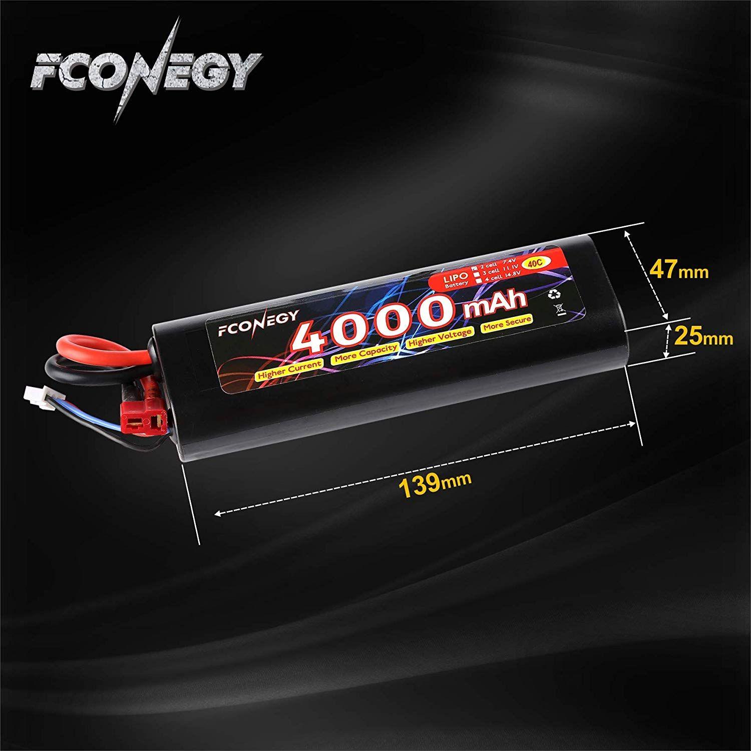

any standard 6 cell nimh will work just fine can find them all over amazon for cheap
or if you want lipo i run these in all my vintage tamiya/rc10s/rct that require the older round stick pack style
https://www.amazon.com/gp/product/B0791W1TKP/ref=ppx_yo_dt_b_asin_title_o04_s01?ie=UTF8&psc=1 https://www.amazon.com/gp/product/B0791W1TKP/ref=ppx_yo_dt_b_asin_title_o04_s01?ie=UTF8&psc=1
but if your running lipo on older electronics you will also need these
https://www.amazon.com/gp/product/B07BQWSXC4/ref=ppx_yo_dt_b_asin_title_o06_s00?ie=UTF8&psc=1 https://www.amazon.com/gp/product/B07BQWSXC4/ref=ppx_yo_dt_b_asin_title_o06_s00?ie=UTF8&psc=1
