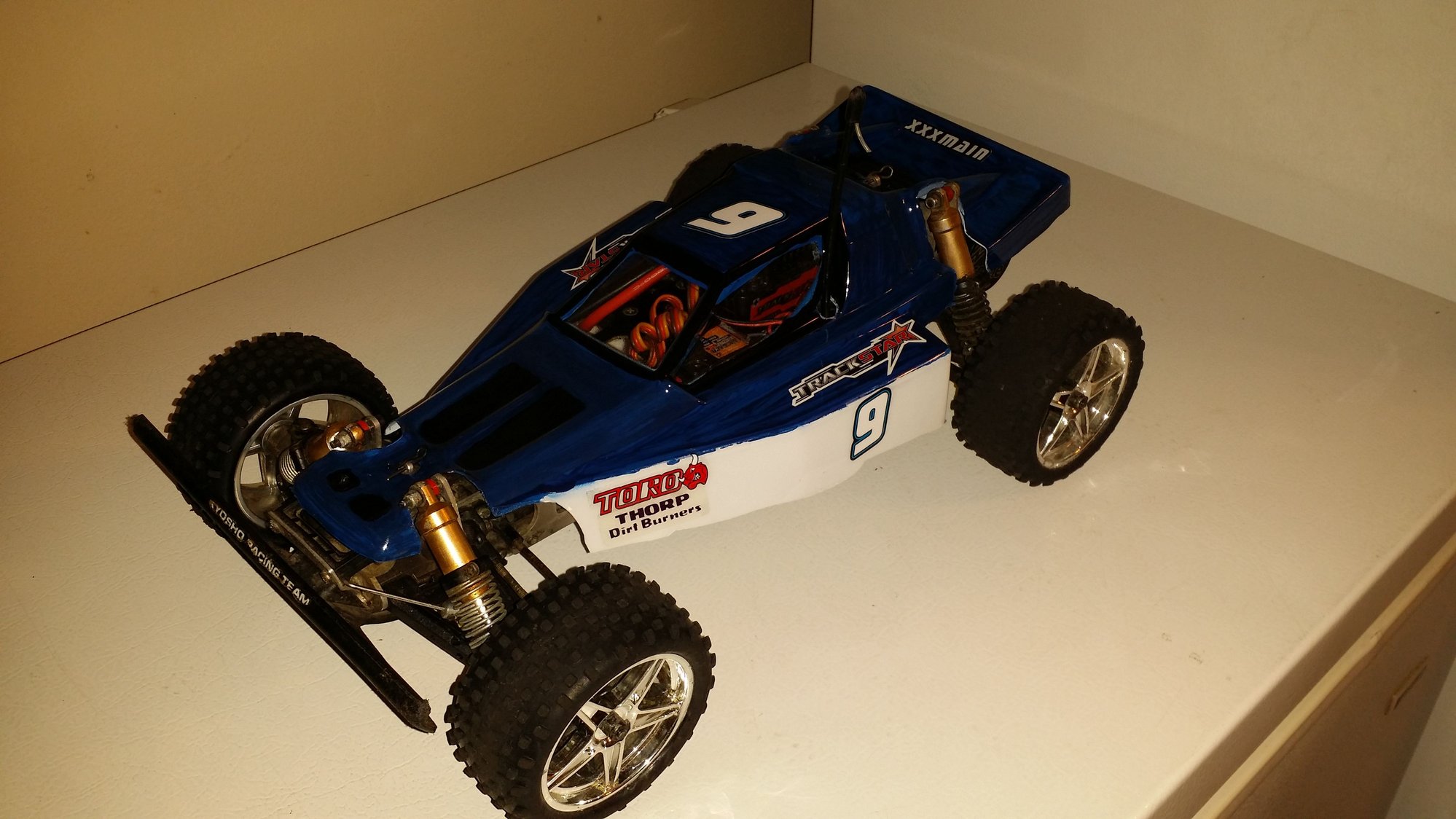

I have the original optima and manual that I purchase over thirty years ago and it still runs great even after converting it to brushless.

That looks like a Turbo Optima. Sway bars and gold shocks. Nice car..
