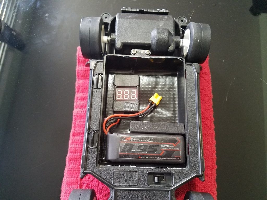

  7. Mod the battery bay to fit a 2s shorty lipo.

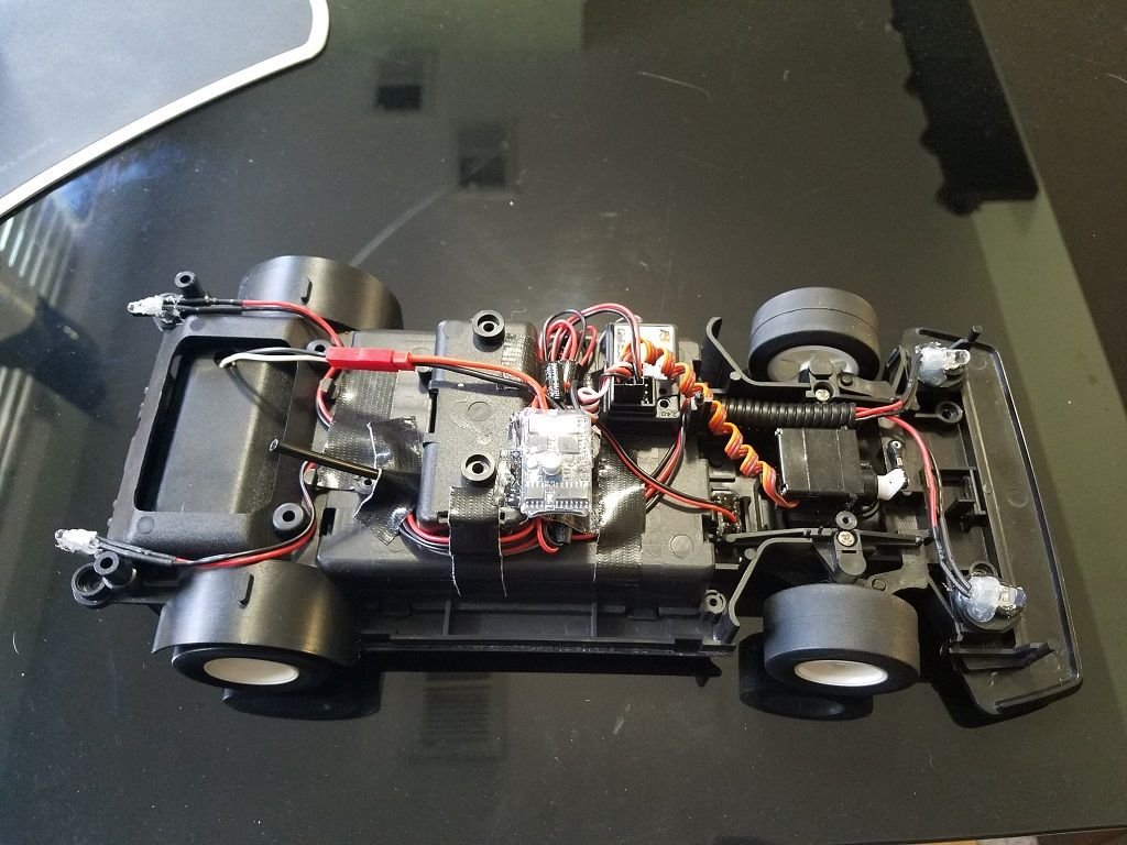

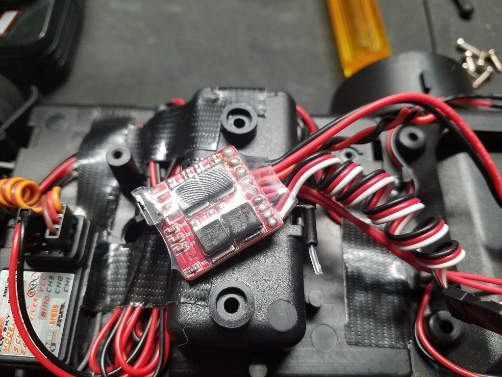

Gutted her, got those God awefull stickers off and added a racing stripe, got the servo, Rx and lights installed.
Servo mod was a lot easier than I expected, originally wanted a full size servo, however ended up being too big, went with a metal gear 14g servo instead.
Lights were just cheap always on lights, awaiting my 20a brushed esc to come in for the end result.

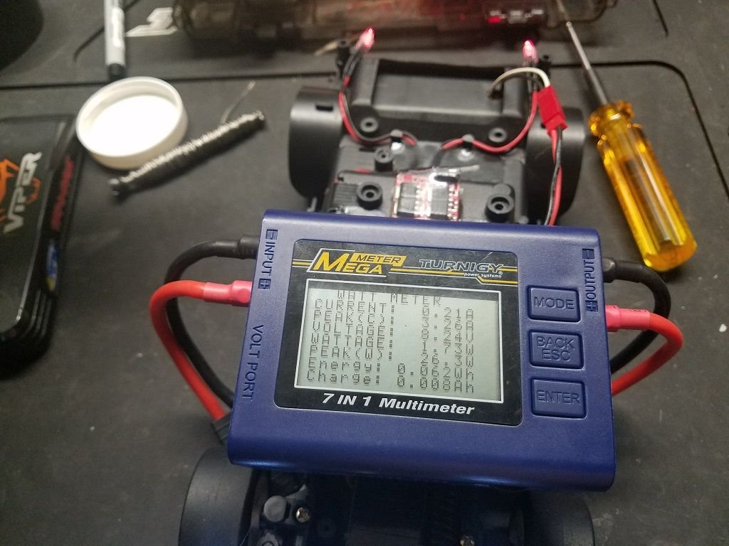

ESC came in, however it was a dud, would only go forward, the brake switch on it did nothing, she got REALLY hot just plugging her in. At least I was able to get the amp draw running on carpet WOT, 3.26 a.
I double checked the ebay listing and it says forward, brake and reverse ... oh well $8 loss reminding me to always shop amazon prime as I'm too impatient for the return postage and wait time for a replacement.

Ordered a new 10a ESC came in from Amazon, installed it and ran it for a couple minutes WOT and didn't even get warm a good sign.
Checked the voltage to the motor when it was stock, it was feeding it around 8v, so a 2s lipo should be okay.
Initially I was going to use a shortty 2s 3500mAh lipo pack, however with the small watts it pulls I opted to use some existing 950mAh packs which gave me a run time of over 30 minutes!
